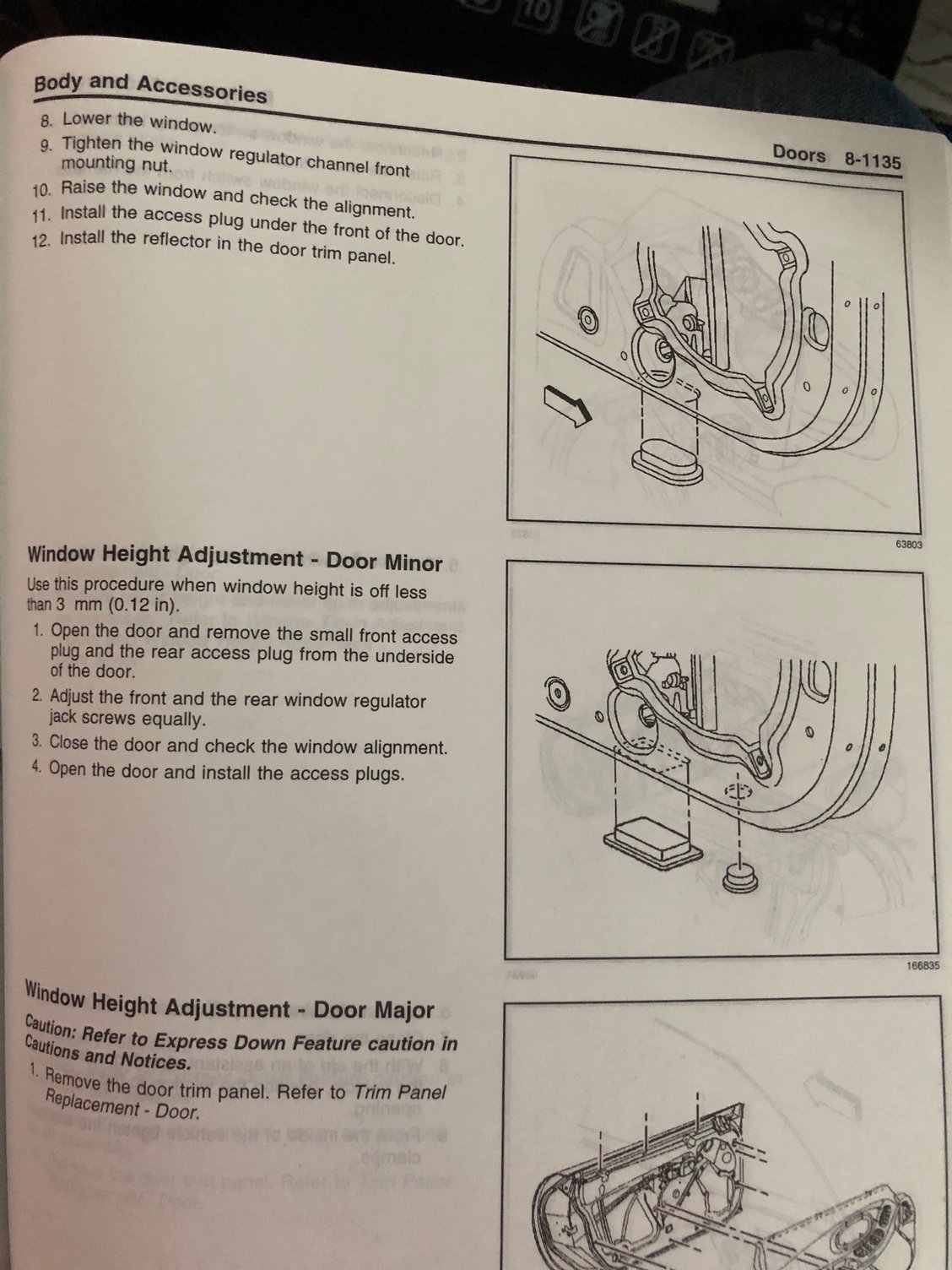

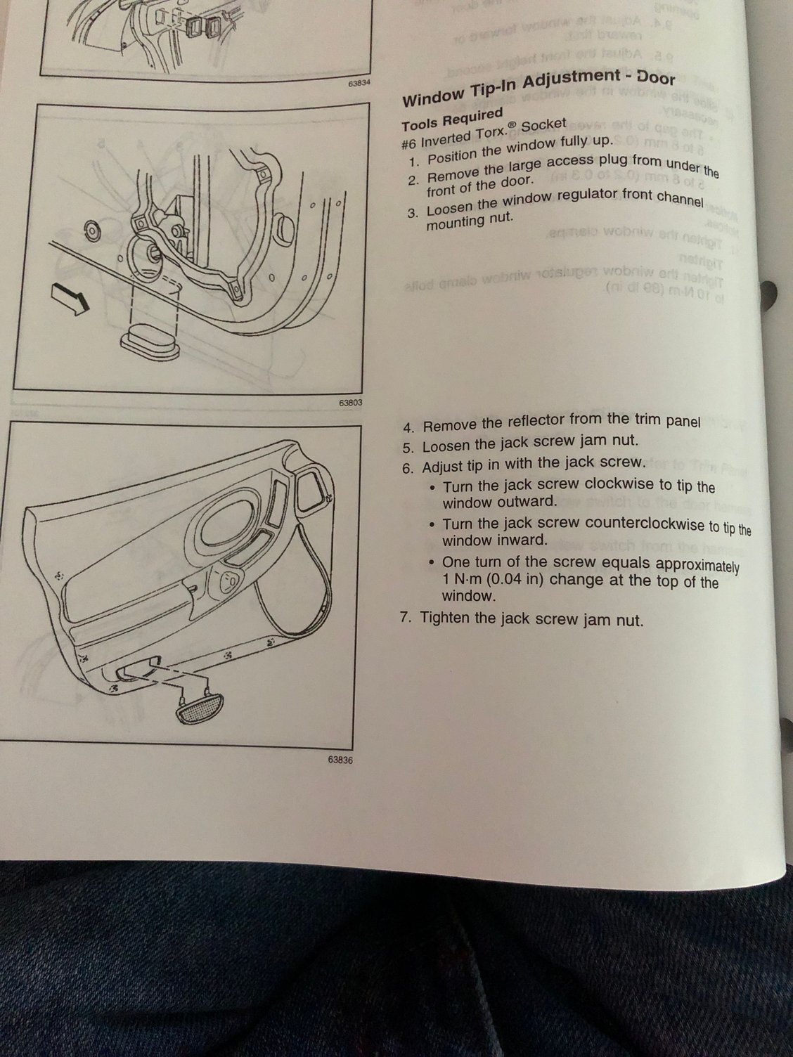

Much appreciated. The video instructions are straight forward with the up-down and left-right adjustment. What I didn't see was how to adjust the in-out tension. For example with the door open, the window is very wobbly in-out. I need to find that adjustment if there is one. Or is that controlled by the motor and rack assembly? Anyone have feedback on that? Mahalo, prof jim

@professorjim I think what you want is the tip-in procedure. It should be in your service manual. These photos are from a 2000 service manual, your process may be different.

Mahalo for your response and the pics. I'll take to the GM dealer/shop and see if that helps them. Unfortunately I can't DYI where I live and have to rely on other shops. I'll update when it gets fixed.
