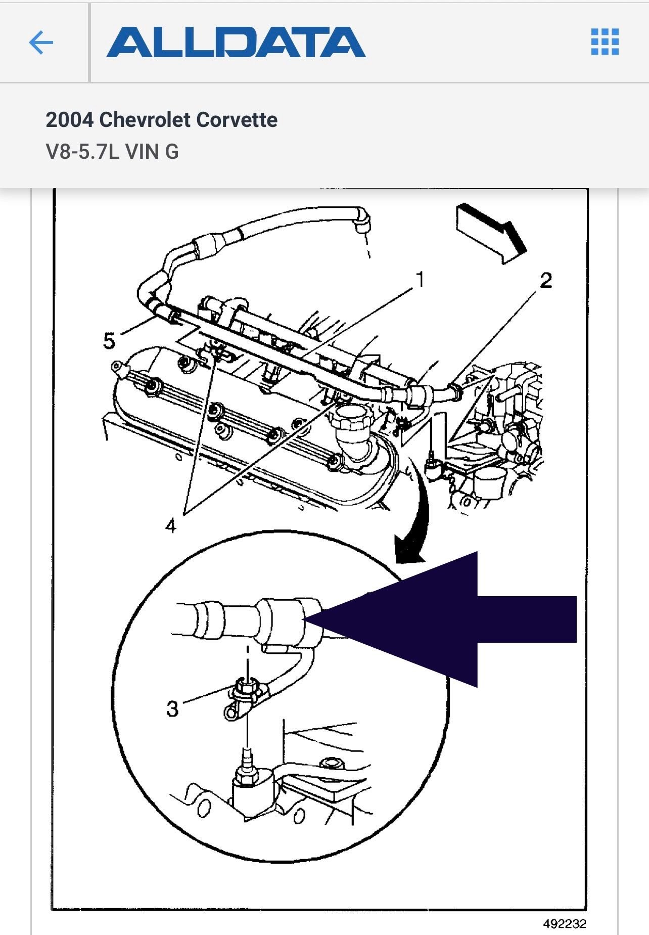

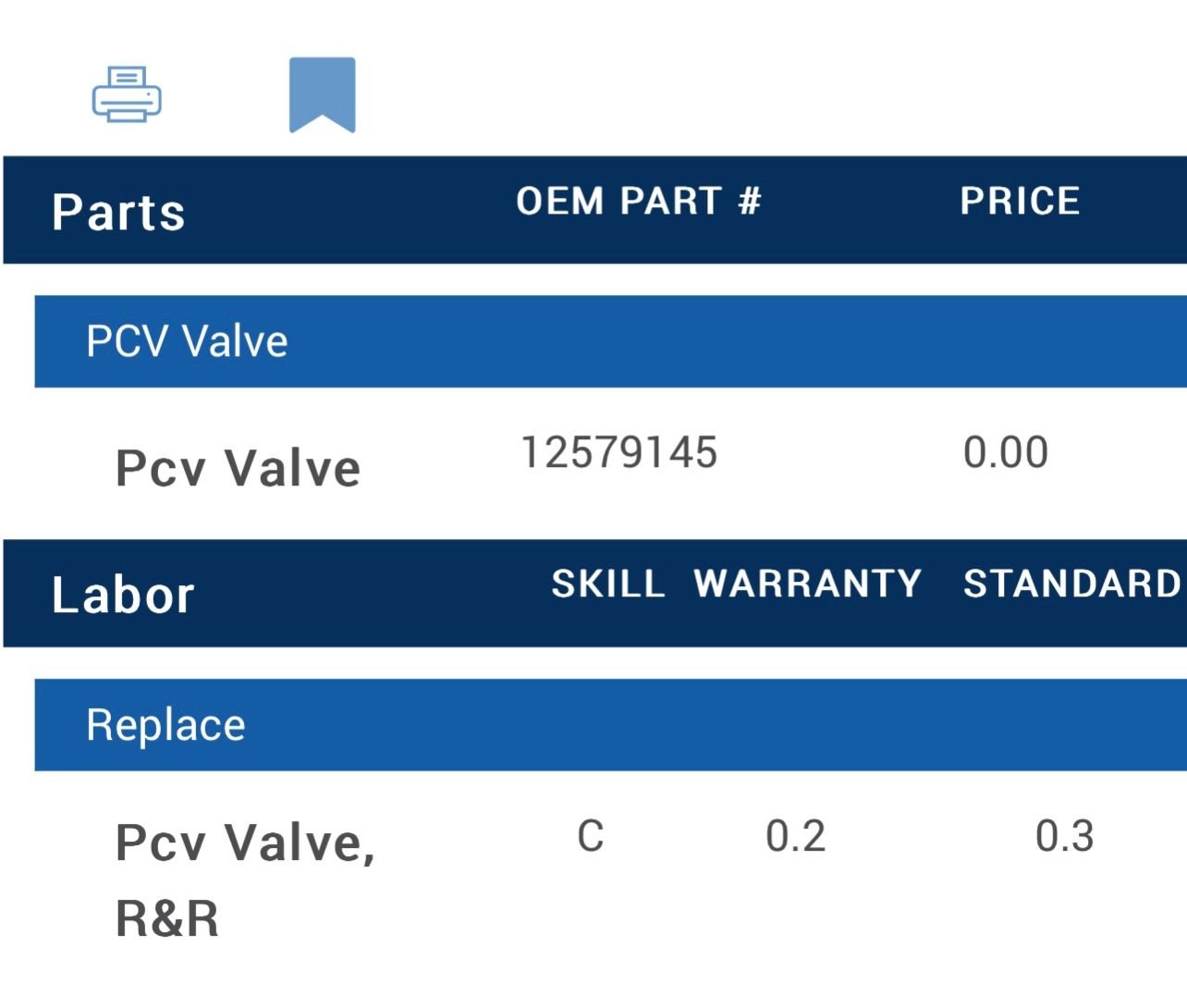

Part number and location below.

Are all 2004 the "fixed orifice" style or just the C5 Z06/LS6? I can see how that could be confusing-- there's no "valve" per se, it's all just integrated into the valley cover.
I'm pretty sure all 2004 (LS1 and LS6) used the "fixed orifice" PCV system.
OP, check the "Normal Maintenance Replacement Parts" (or whatever) section of your 2004 owner's manual. I bet there's no PCV valve part number listed.

04 does not have a PCV valve. The restrictor is built into the valley cover. However, Sometimes it's possible that the RTV used by the factory to seal the unit to the underside of the valley cover has failed allowing oil to get sucked into the system.
