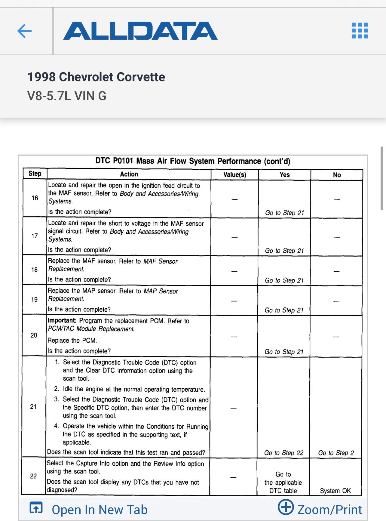

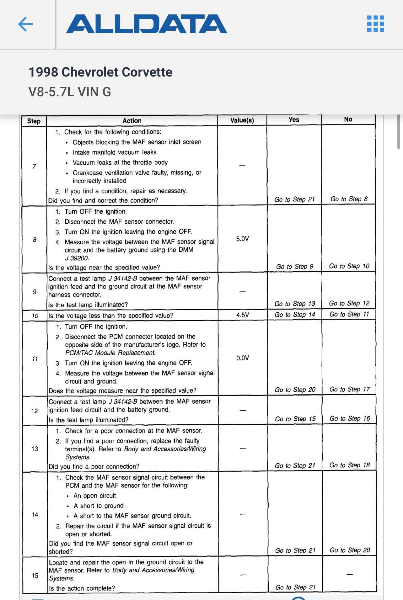

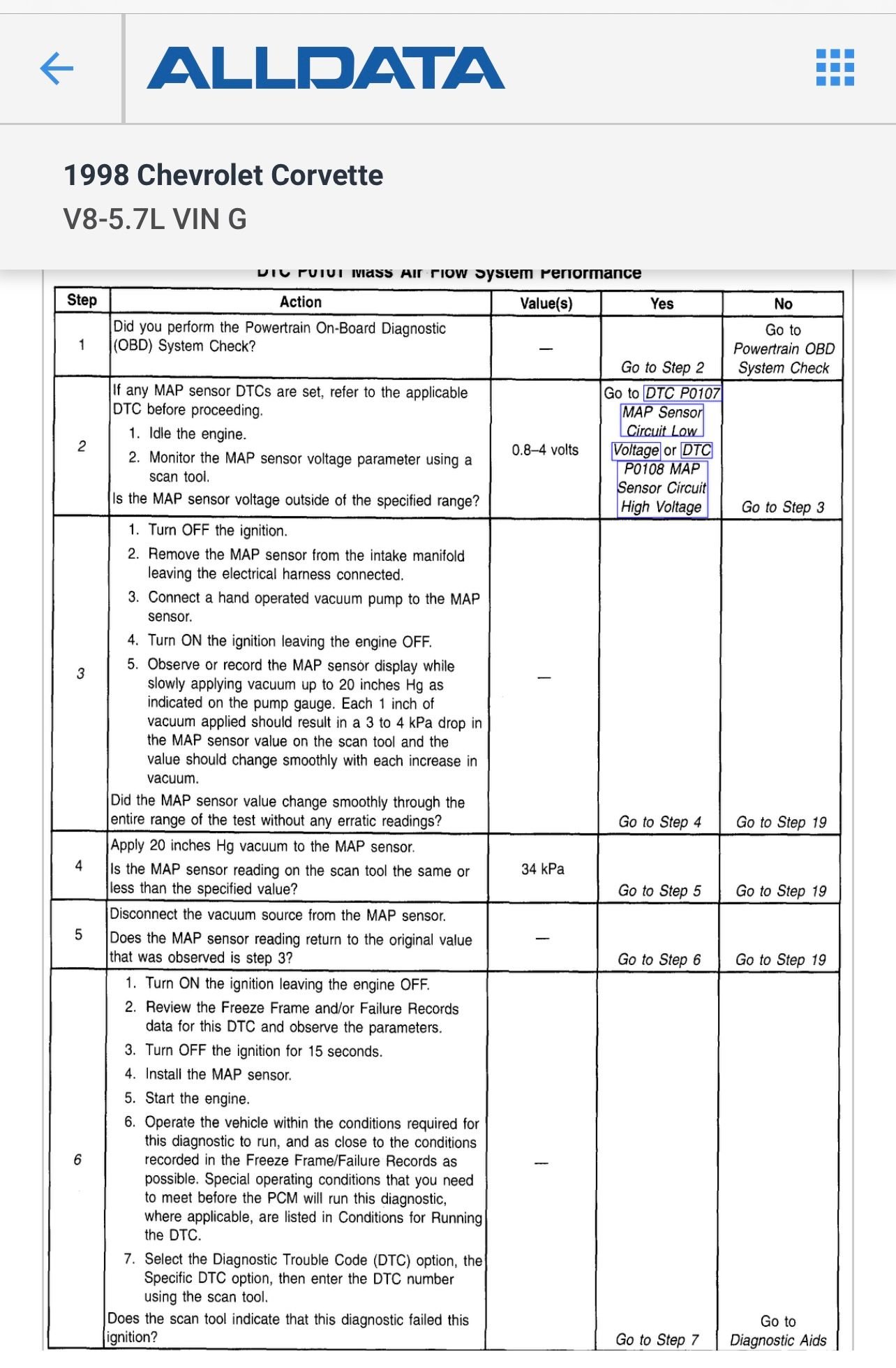

This is the FSM diagnostic flow chart should you want to follow it !!

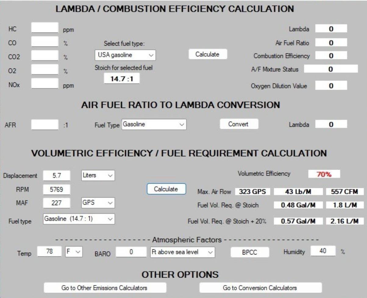

Answering previous questions as well as VE calculator data for a couple of pulls -
Pull 1
Long term fuel trim prior to WOT +21.88
WOT Short term fuel trim ZERO
VE per online calculator 72% (95F, 5769rpm, 226.82g/s, 5.7L)
Pull 2
Short term fuel trim still ZERO at WOT
VE per online calculator 67% (yikes)
Long term fuel trim settled at +6.25
I didn't see, and don't have the data for it, but these pulls were only at about 190-200F oil temp. Check engine light still hasn't come back, but lots of pinging high up still present. To my understanding, fuel trim being 0 at WOT equals more air, which would cause pinging?

No, it’s normal for fuel trims to go to zero at WOT…you can use the O2’s at WOT to see if you have issues..O2’s should go rich at WOT…I ran my VE calculator (the same one that is in the video) with the numbers you gave me and your VE is 70%…you saw 67% so we are close…80% is good so it’s looks like a bad MAF if all the wires check out OK…I used 78 degrees so if it was 95 I’ll redo tomorrow.

Ran your VE test at 95 degrees and came up with 73%…since your engine has difficulty “breathing” maybe look for cats that are starting to clog….one quick check is to see if your IAT is increasing under load…hot exhaust gases are backing up into the induction system.
