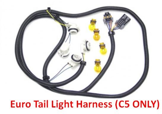

Below is a picture of the conversion harness:
You can do a search for "Corvette C5 European Taillight Tail Lamp Wiring Harness" to find a link you can open.
Below is an older thread on converting to Euro Tail Lights that might help:
https://www.corvetteforum.com/forums...onversion.html
Wow, that looks familiar
Well, he said he couldn't open your link so I just posted a picture so he'd get a rough idea of what the harness looks like.....
