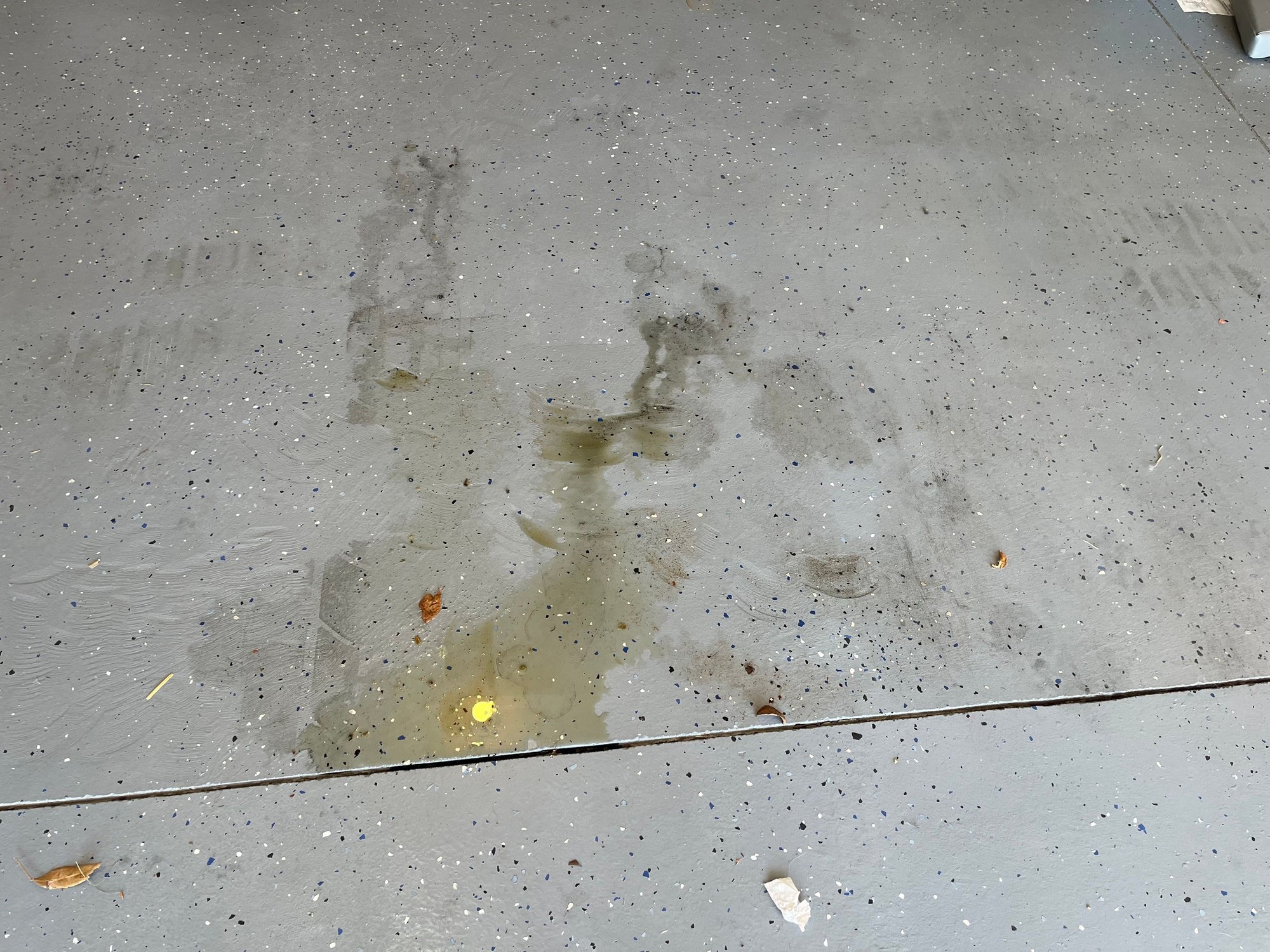

Car has a leak in the rear end - fluid is similar to regular oil. Is this transmission fluid? What’s going on here?

You will have to get under the car and inspect. Everyone will just be guessing.

The transmission is supposed to be Dexron III atf...which is distinctly red.
The diff takes gear lube. It's normally honey colour, a bit thicker than engine oil.............. but smells really bad.
