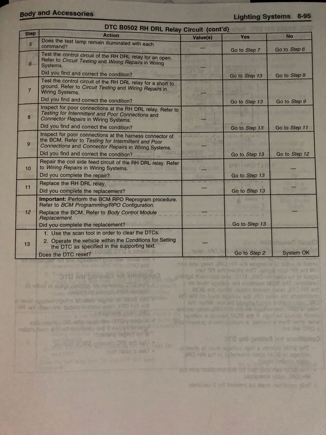

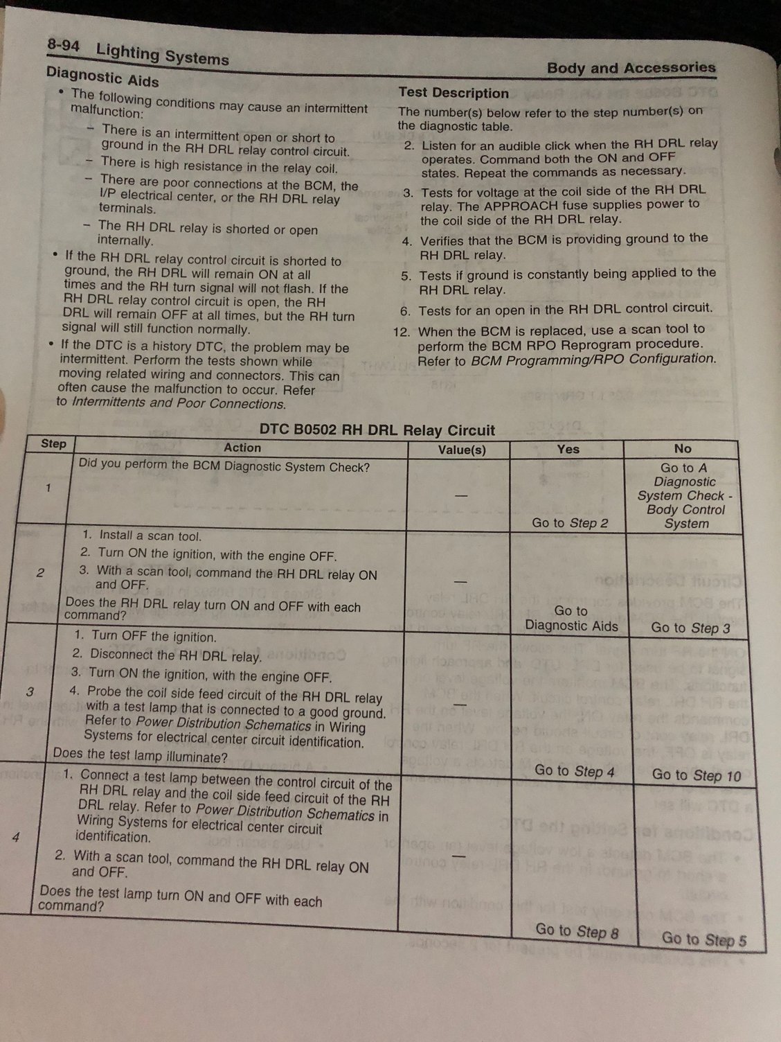

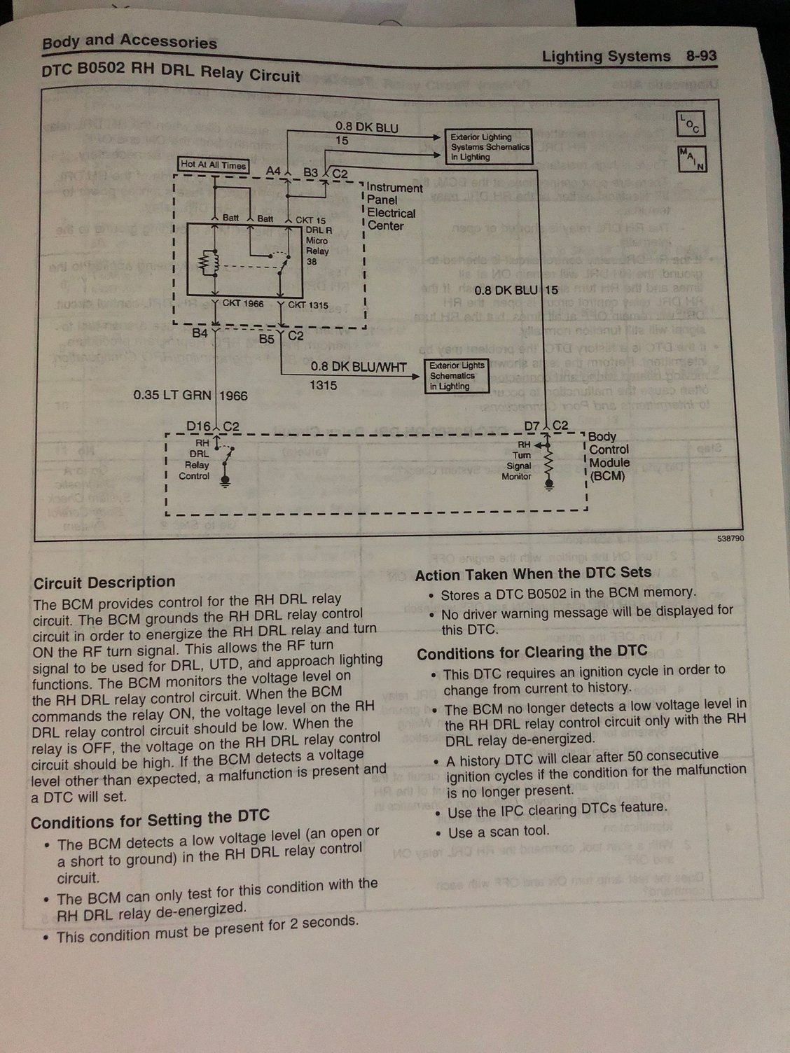

There is a pretty extensive troubleshooting chart in your service manual related to these codes. Have you followed it?
Here are the B0502 pages for a 2000 model, no idea if yours is the same or not. And note the BCM GROUNDS the circuit so if your ground point for the BCM is different than your ground point for the other functions then it could still be a bad ground.
If you need screenshots of other pages I can post them but again, these may be different on your car.
Old Sep 29, 2024 | 12:55 PM
Scott'sC5's Avatar
Scott'sC5
7th Gear
Joined: Sep 2024
Posts: 7

...except the info provided to you by Dads2kconvertible is for the passenger DRL, and your problem is on the drivers DRL.
I provided specifics for the driver side. Good luck.
