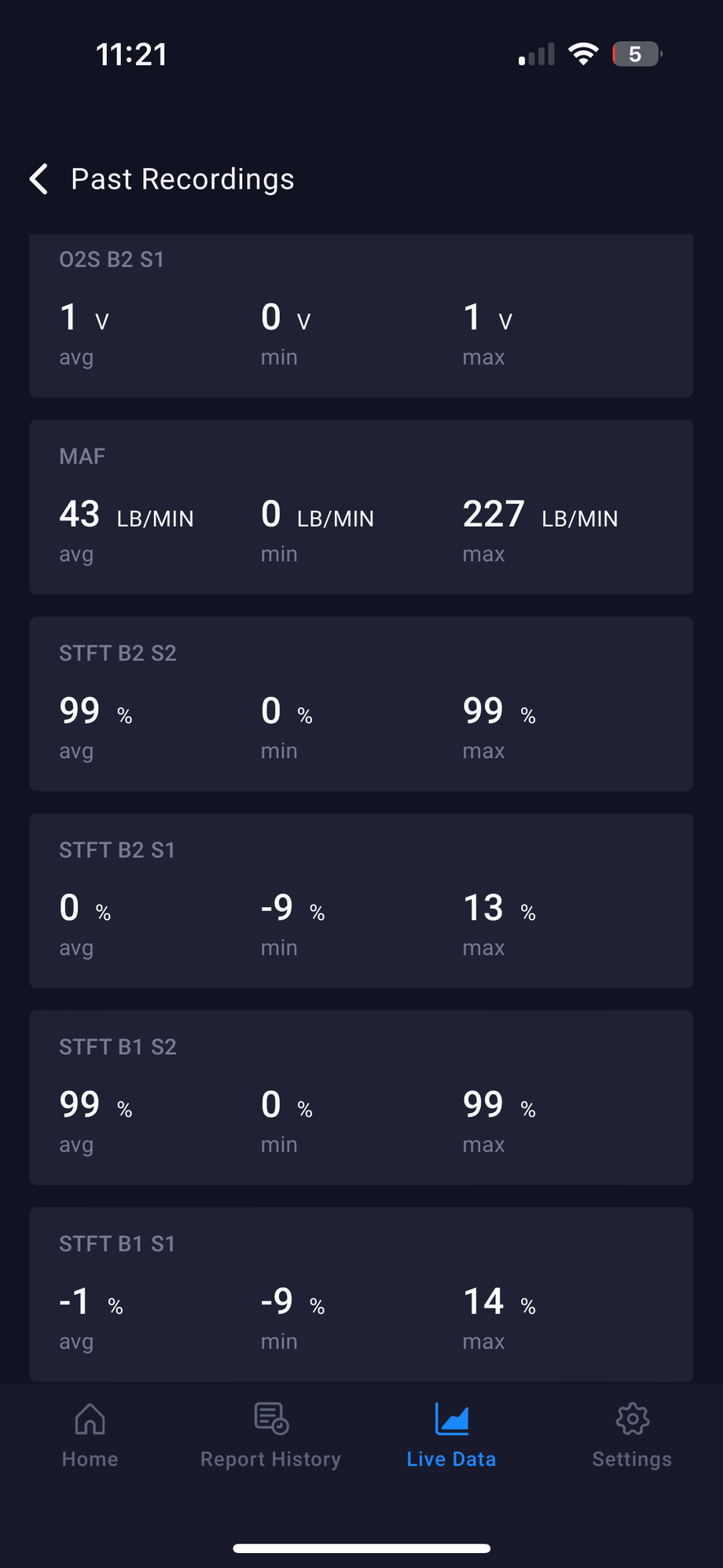

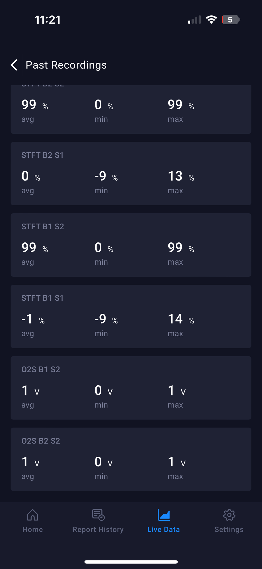

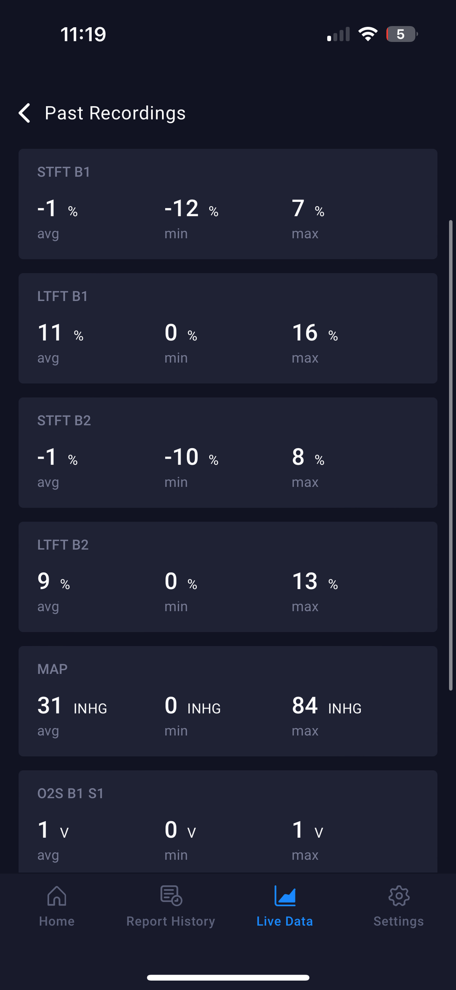

I do have some live data from when it is was doing it, I just don’t know what any of it means. Here are some screen shots

Would be a little difficult to diagnose your car by just looking at screen shots…watch the 2 part video and see if you can understand the theory…look at your fuel trims and O2 sensors…at idle the upstream O2 sensors should oscillate between 200-800mv’s…the fuel trims should be + or - 10%….under load the upstream O2 sensors should go near 1 volt.
