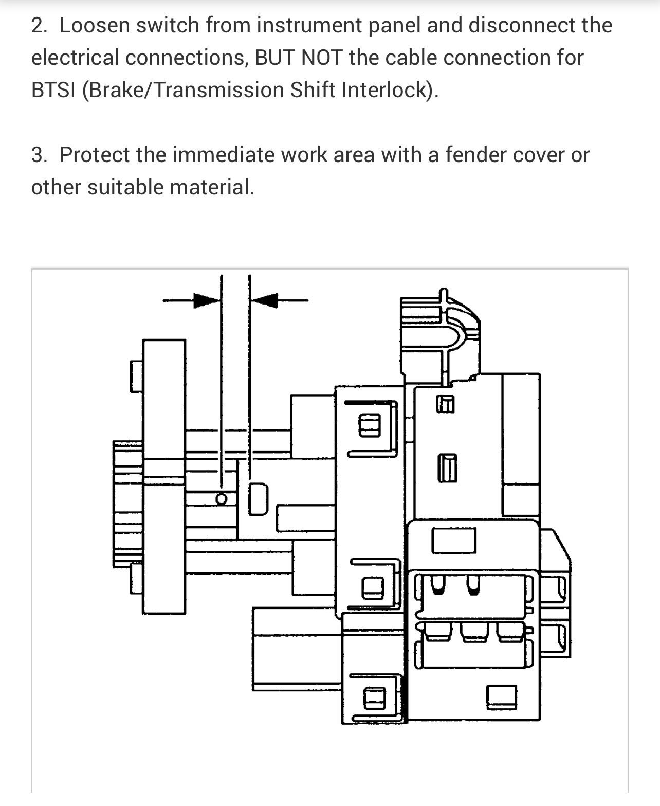

On C5 can you remove the ignition cylinder from
the ignition switch if key will not go in cylinder??

My best advice is to take the Ignition switch to a locksmith.

Great write up!
