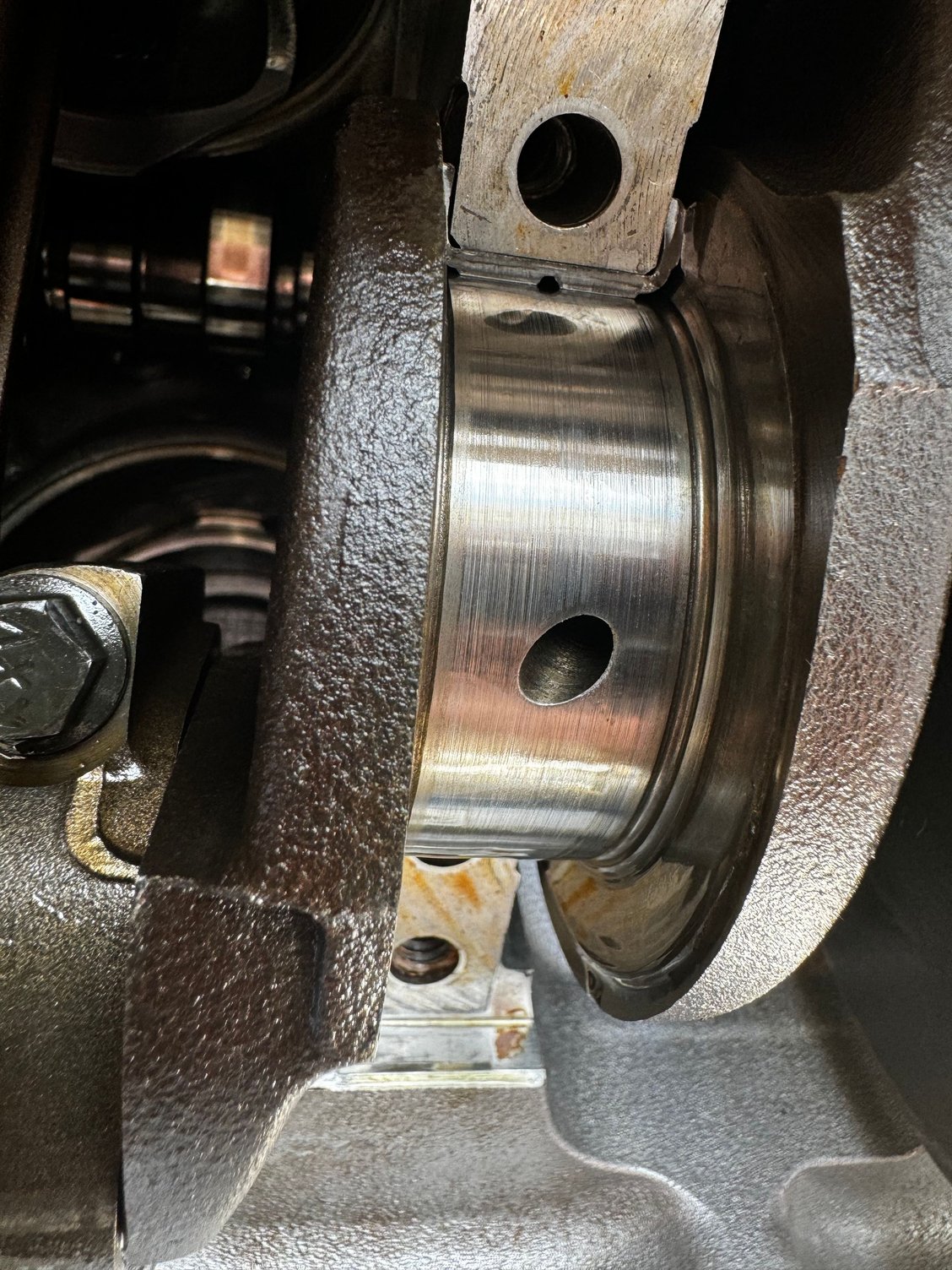

Originally Posted by jamed30
Yeah I understand that I just couldn’t find what was the culprit when I had it apart before I took it over to the machine shop. Just seemed odd I guess oil pressure was fine also.
I hear you. Cant sleep tell you find the smoking gun.

Yeah, that bearing looks like some kind of grit went through it.
How’s the crank look? And the rest of the bearings?
Good choice just honing .005”.

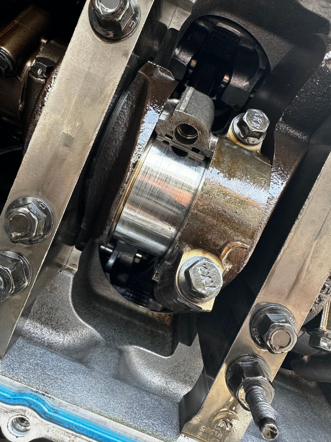

Rod bearings looked fine but #4 had some "chips" coming off of it but never spun. All the mains looked fine & crank looked good too. Ran my finger on the crank where the thrust bearing goes and felt smooth with zero blemishes & sides looked fine as well. They're going to see if the crank is out of whack though but they seem to think something wasn't cleaned good enough and just slowly ate my bearings. I always had some crap on my metal plug changing the oil when I got it rebuilt after busting a ringland 3 years ago.

Not cleaning the parts or attached oil coolers, oil lines etc coould get debris in the engine.
You maybe fine with polishing the crank, near berings and maybe a fresh hone on the cylinders.
You got it, looks like there was some kind of debri
left on crank or bearing and when cranked down damaged the bearing.

Have you check the lifters, they are been know to break down and cause bearing and crank damage.
A friend worked for an engine builder locally who built LS motors for the ASA series. He did a basic hone, with new rings and bearings on the side for another friend. We went over to his house for the final cleaning and assembly. A wide selection of brushes was used and then blown out with air. Prep is critical.
Racers also need to replace or ultrasonic clean lines and oil coolers if they send debris into the oil circuit.
