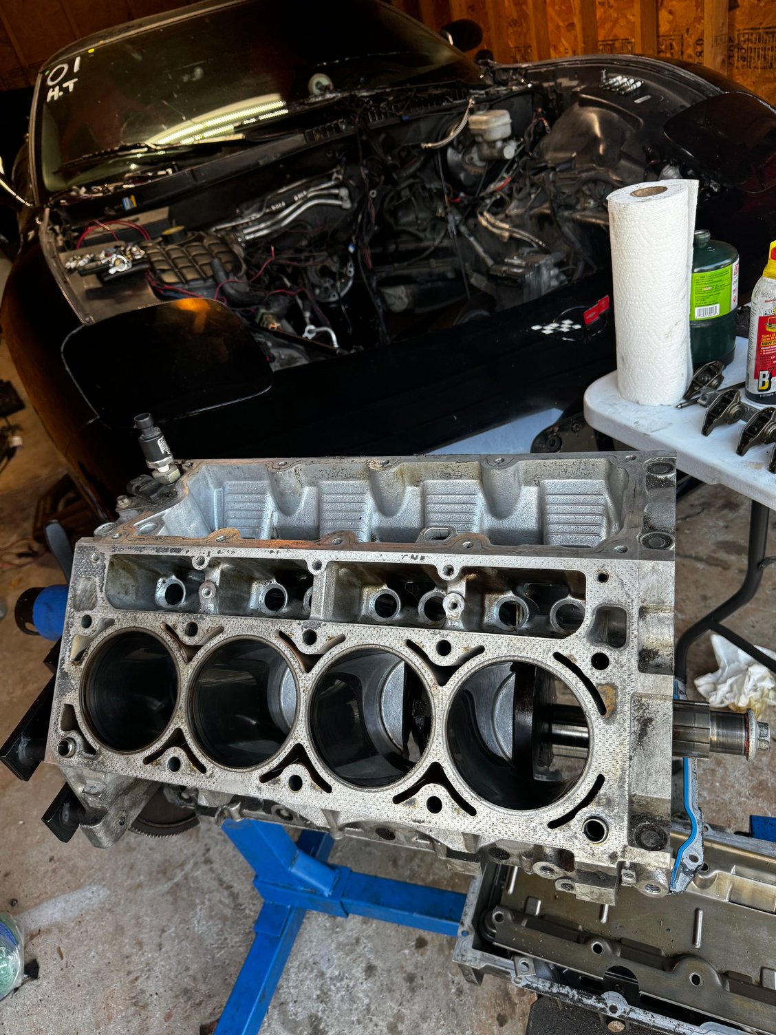

So I have a question, I have my block at the machine shop right now (LS1 Block) & they're recommending me go .020 over which will put me at a 3.91 piston/bore. I'm skeptical on it due to the cylinder lining reliability let alone just reliability in general. I have 3.903 pistons for it already and wanting to go that route first but was wondering if anyone has had luck with a 3.91 bore? Also kinda curious how it could have gotten that out of whack as well so I could know how to prevent in the future. Thanks
Its a 1999 Vette that the block is coming out of.

+.020 doesn't sound like a good idea, https://www.motortrend.com/how-to/ma...for-ls-blocks/

Thats what I was thinking in my mind & was skeptical but apparently the cylinders are that out of whack from what I was told. I plan to get it honed to 3.903 since I have the pistons along with getting the deck cleaned up along with heads as well for smoothness and putting arp mains since I plan on boosting it. I dont understand how it could have gotten that bad though which seems odd to me.

A LS1 can't be bored out to a 383, there simply isn't enough metal between the cylinder bores. When 350 engines were changed to 383 they installed a stroker kit which means that the crank was swapped out which increased displacement by increasing the stroke. The same can be done to a LS1.

That is on a 350 Gen1/Gen2 motor. 350 cubic inches 4.00" bore 3.48" stroke
Gen3 5.7 Ltr 346 cubic inches Bore 3.898" Stroke 3.622"
LS1 383 is .005 over and a 4.00" stroke crank.
Max bore can depend on the LS1 block but .005 to .010 is common.

I'm so glad people with actual knowledge came in at the end here.
Gen1 / Gen2 small blocks share almost nothing with LSx engines.
Yes, Gen1/2 engines could be over-bored up to .060 (most commonly .030) and yes that makes more displacemt a Gen 1 350 over-bored .030 becomes approx 355cid
LSx engines have cylinder sleeves and can take almost no overbore. .005 is the max number I've always heard. If a machine shop wants to take an aluminum LS1 .030 over; find another machine shop.

I’m having a hard time believing that my cylinders are that out of whack. Car was running fine and compression was good when I pulled it just had shavings in the oil (still don’t know what the root cause was they were saying trash was still in it but then was also told it was normal wear so idk what to believe) They’re wanting to bore it to 3.91 and everything that I’ve read says that’s not the greatest idea due to cylinder wall reliability etc but was told by said shop i would be fine. (Still not feeling 100% committed to it)

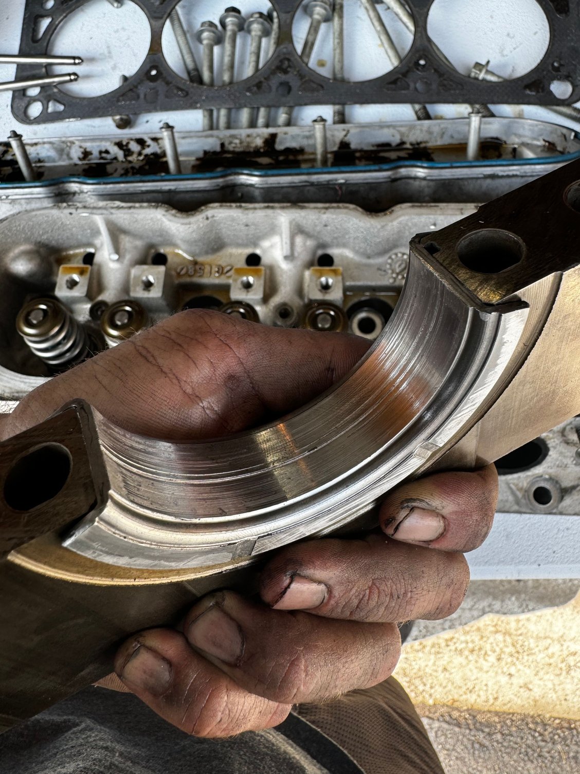

The thrust bearing doesn’t look like normal wear but maybe I’m wrong. I’m just going to get it honed to 3.903 and send it since I already have pistons for it.

Take the engine to another machine shop, these guys don't know Aluminum LS engines. It doesn't mean it's a bad shop, Aluminum LS' are their own thing. If they try to rebuild this like a Gen 1 Iron motor there are going to be all sorts of issues.
Where are you? Maybe someone here can recommend a good local shop for this.

They told me they would hone it to the 3.903 pistons that I have and if they say it is a must for a 3.91 then I'll be taking it out of there regardless. I'm in Madison AL if it helps at all.
Do the bearings look like normal wear or is something going on that I need to look for when I get it back?
Something diffently wrong. To me anyway. If the engines getting rebuild it doesn't matter.

Yeah I understand that I just couldn’t find what was the culprit when I had it apart before I took it over to the machine shop. Just seemed odd I guess oil pressure was fine also.
