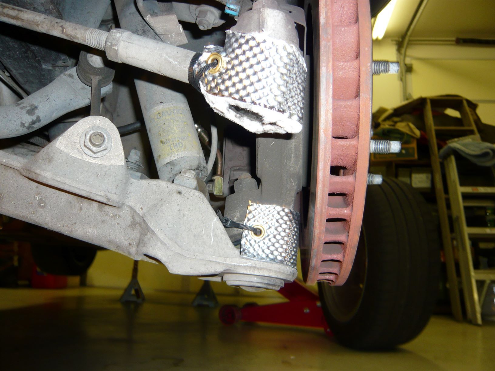

As far as melting, these ties have been in place for about ten years. I found that rotor temperature after a cool down lap and parking in the paddock was 550 degrees F-

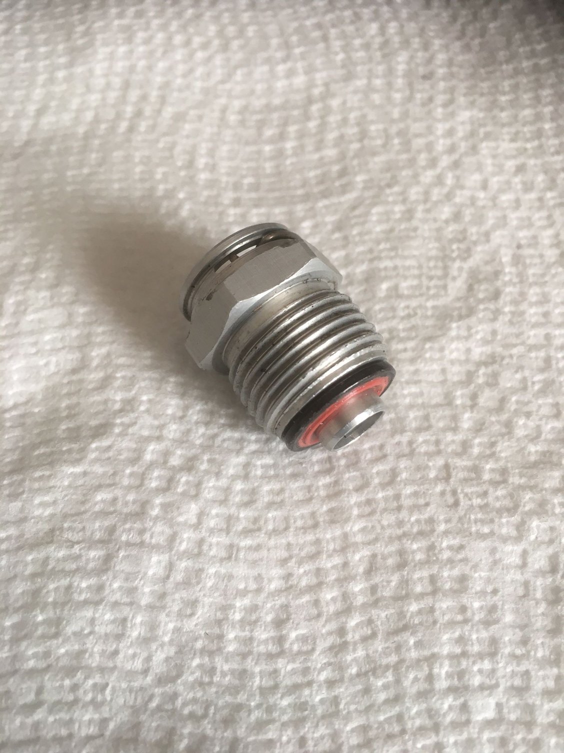

Those cooler union threads would be metric quick disconnect on a 2004. The change from 5/8 - 18 to metric occurred in 2001. Later I will find one of my old cooler union fittings to measure. The metric unions and plugs would have a seal on the end and if a union a spring lock and o ring seal for the cooler line. Takes a small plastic tool to release the cooler line.
Another option would be to call DeWitts and ask them. They have all the correct fittings by year.
This is what a metric union looks like, probably a plug is available. My calc is 18 mm x 1.5 mm.
