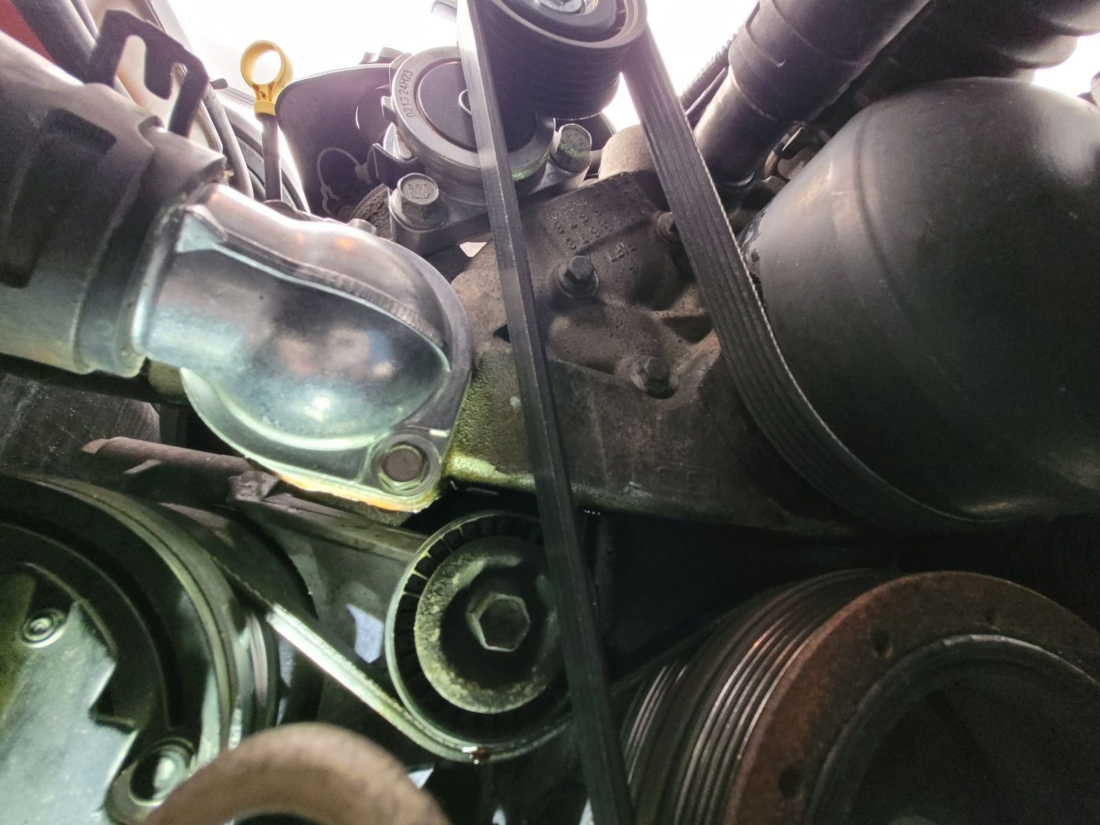

Hello! I love this 2004 c5 manual vette I picked up a couple months ago. I have installed the corsa sport exhaust and z06 wheels!
However, I noticed a few drops of coolant on the pavement soon after getting it. I replaced the thermostat/housing (duralast) and radiator drain plug (acdelco). Now its leaking A LOT more than a 5 drops. I'm 60% sure that a bead of silicone on the housing mating surface would fix it? Many on here said to not use a gasket or sealant, that the thermostat's rubber seal is what seals it. Your thoughts? Thanks in advance!!

Two possible leaks are water pump t-state housing or there is a weep hole under the pump neck. Starts slow then gets worst. Its telling you better change me. When you park car is there a little fluid in center or close to it engine?? JMG

so could be the water pump? it looks dry over there. first pic u can see that the coolant is almost directly under the crank pulley , center of engine bay. However I can really only see coolant dripping from the thermostat housing.. I did wipe both surfaces with break cleaner before tightening the bolts when installing. Also I made sure the thermostat seal key was correct in rotation in the housing.

When the engine is running the air blowing does wired things. Get dye and that will most likely find ur leak, but center of crank is water pump.

Most likely the water pump. Thermostat housing seals typically do not leak since the seal is an O ring and not on a turning shaft.

it's looking like I'll need to replace the water pump... which I haven't done in over a decade. I can either do it myself now or wait to pay a shop because funds are tight. this is a real bummer but at least it won't be too expensive.
after looking at the diagram again, the puddle is right below the water pump!

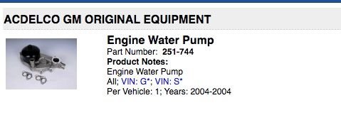

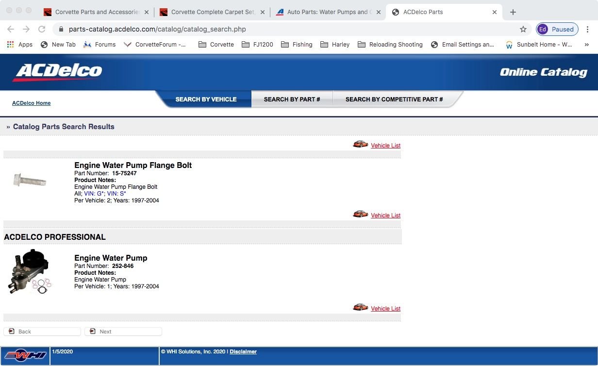

It looks like the thermostat housing is wet. You have to know what you have for a pump. Early pumps used a one piece thermostat/housing with a standard gasket, and the 2004 uses a thermostat with a rubber seal around the perimiter to seal. The aftermarket now sells one that fits all, and comes with both gaskets (rubber and standard). If memory serves me correctly, the earlier one has a larger hole and if using just the rubber seal of the later one, you will have a leak. I remember one of the combinations requiring using the rubber seal and the gasket - it was really hokey. You had to have the one piece t-stat and housing for the earlier pumps and the 2004 housing for the 2004. I returned that fits all pump and bough the one specific to the 2004. I have the old water pump in the shed and could measure the hole size for you if need be.

thank you for the info! the thermostat I installed has the rubber seal, shown below.

true.. I could have before I changed the housing since it was only about 5 drips, but for some reason now its the puddle u see in pic #1. I may just have to tuck it away for winter ):

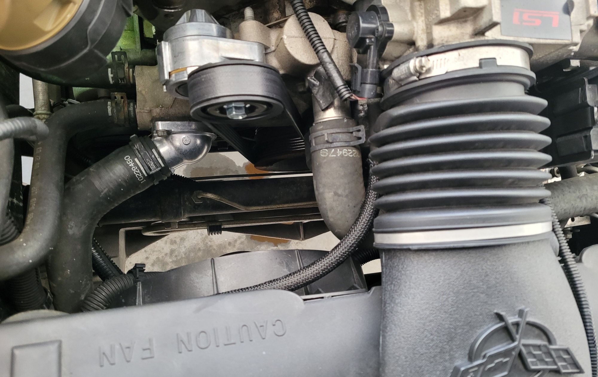

two better shots taken last night, going to be replacing this weekend since the new waterpump will be here tomorrow!

I do not see where a pressure test was performed to confirm the diagnosis. You might get lucky with the parts change, but why not be sure?

I don't have a pressure tester... and the coolant is dripping directly from the underside of the waterpump. You think this is a shot in the dark after those pics?

Most people do not have a pressure tester, that's why all major auto parts stores rent them. For coolant I use a pressure tester, for oil I use dye. Fluids travel in weird ways.
Your money, your time, your car.
