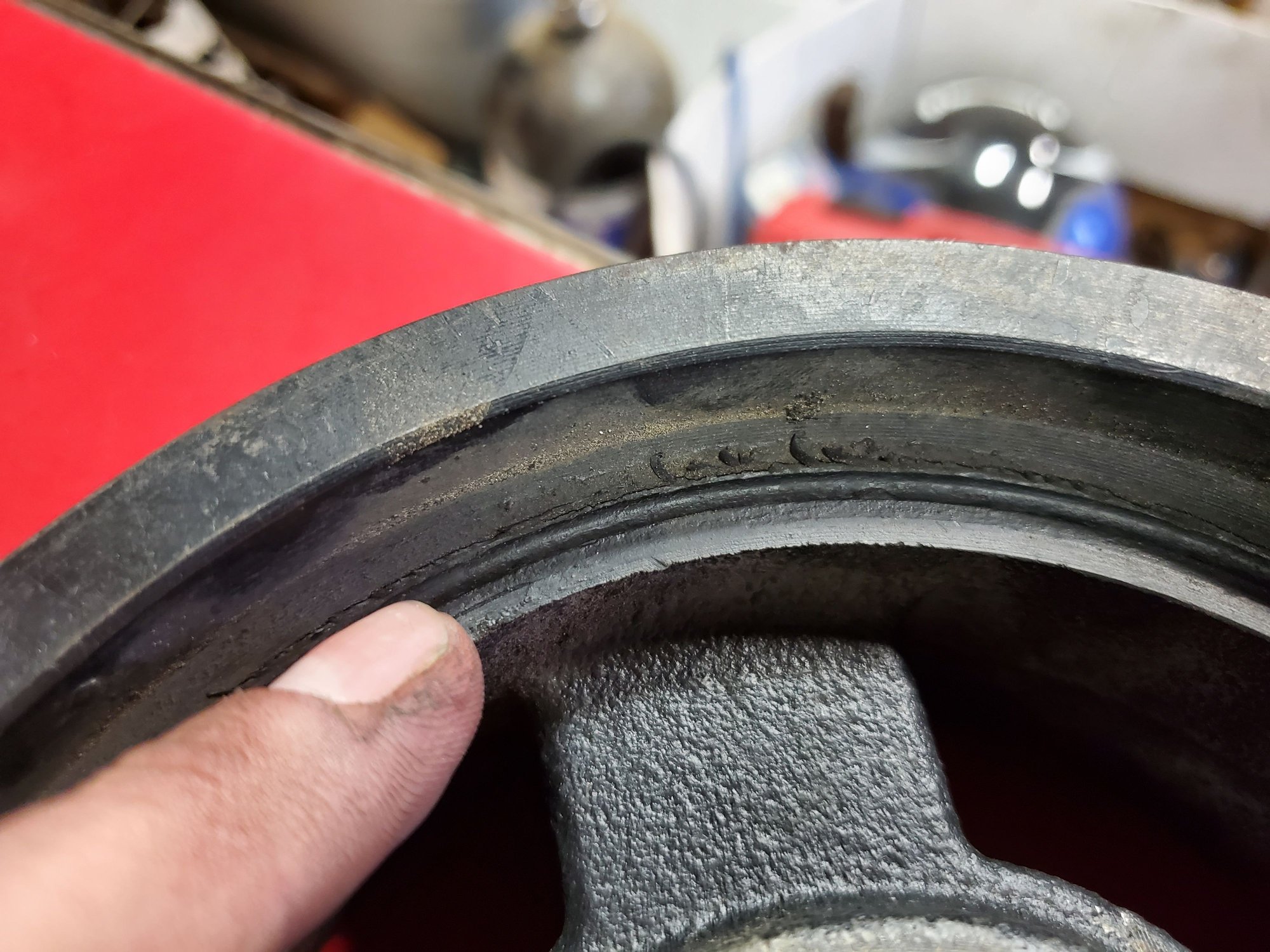

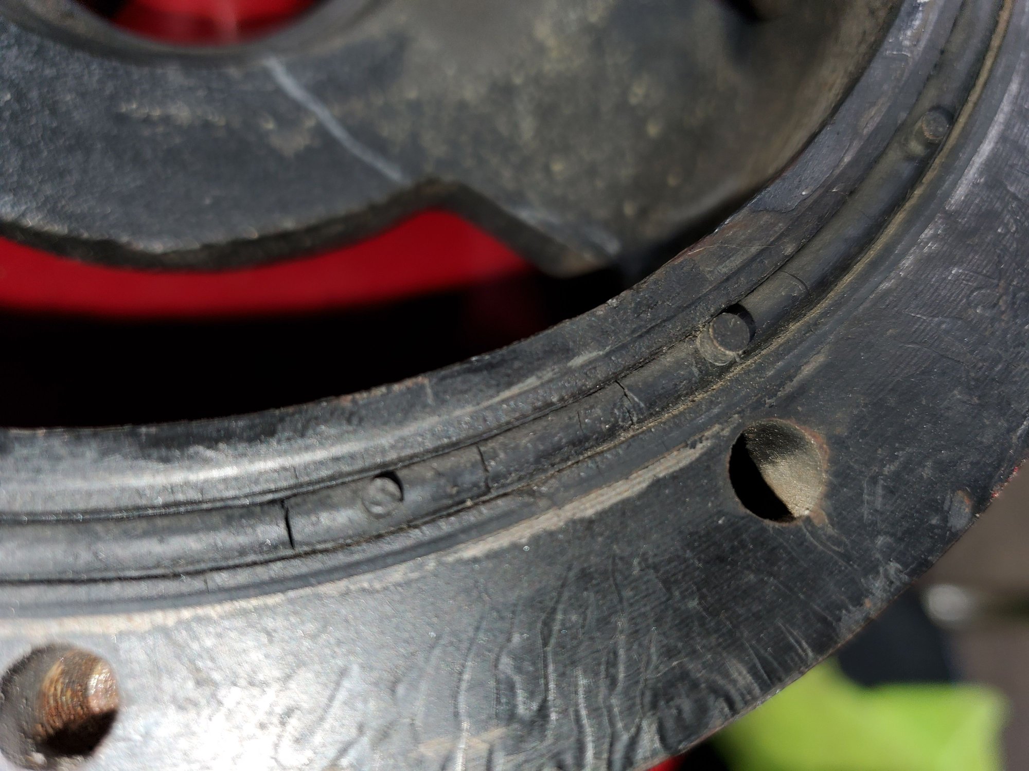

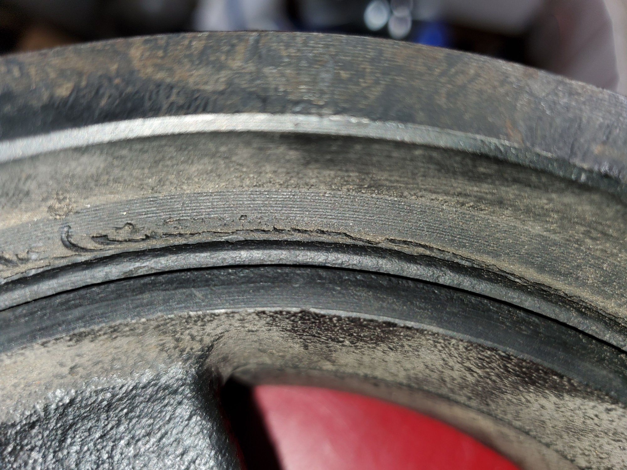

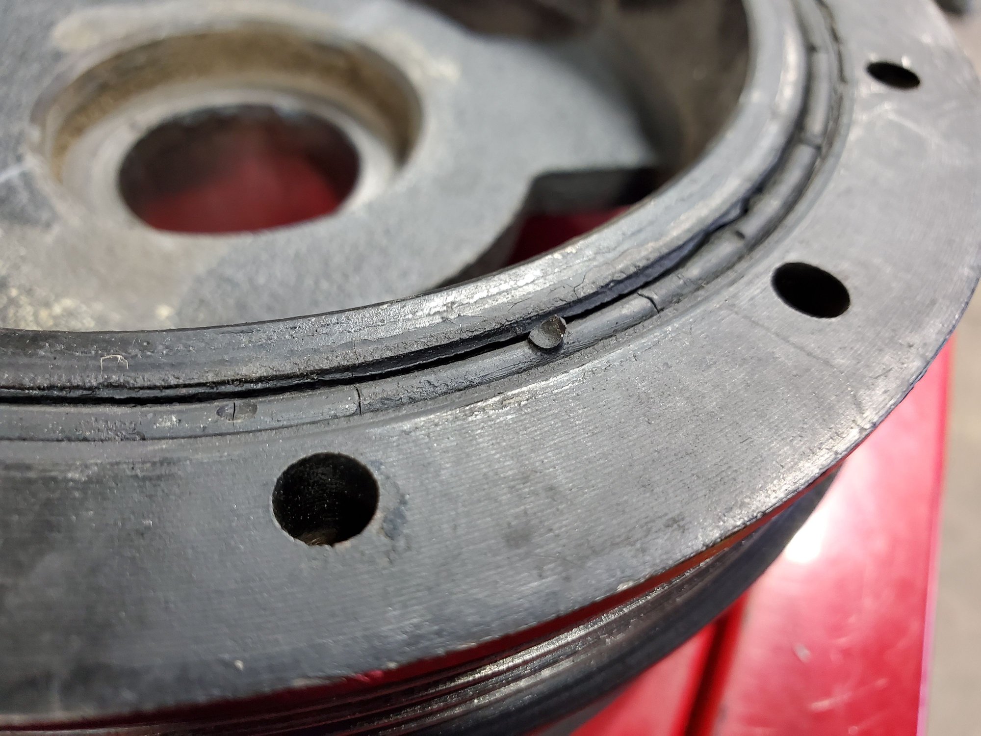

Hi dm290, I have a rattling sound during rpm acceleration parked or driving. I thought it was the catalytic converter. My mechanic took a flashlight and showed me the harmonic balancer is wobbling slightly and gets much worse at higher rpms. This is causing the rattling and was causing the squeaky belt sound that I chased by replacing the tensioners and the water pump (that did the most benefit).
The cause is the stock harmonica balancer has a rubber inner sleeve which warps over time. The fix is an aftermarket solid pulley. I'm using 303 rubber lube until I get around to fixing that and the weak clutch.
You might consider looking at your harmonic balancer with a strong flashlight any wobble at idle is gonna be big at high rpms.

Yeah, I am with Gary on this one. Check the balancer, if it is stock or a stock replacement, check the inner and outer shells where they are bonded together. Years ago I had a vibration that I played hell tracking down. Pulled the diff and trans off, ran the car with just the torque tube on, ran the car with just the clutch and flywheel on, ran the car with just the flywheel... Only to find that the balancer was separating.
