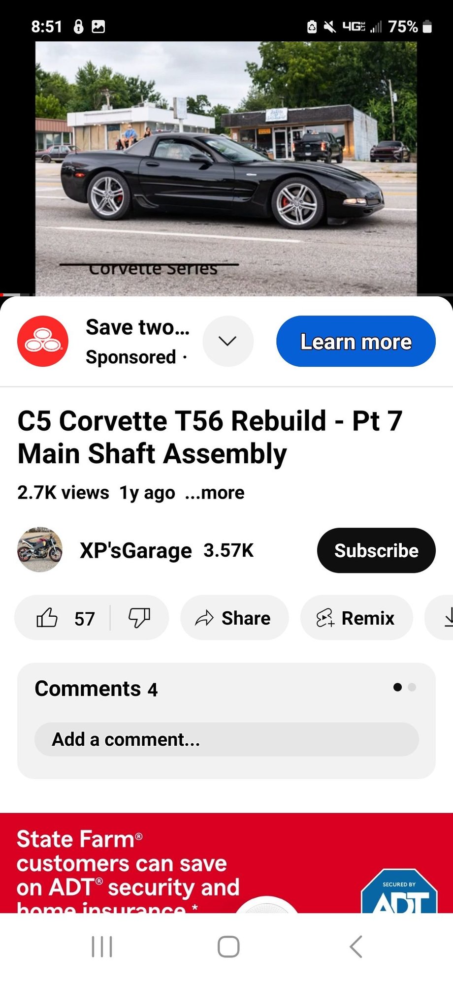

Check out the T56 rebuild video series from XPs Garage on YouTube. He also had problems with 6th gear. Great step by step instructions. If/when I decide to go into my trans or rebuild a replacement unit these videos will be my go to reference. Tick makes a good rebuild kit.
