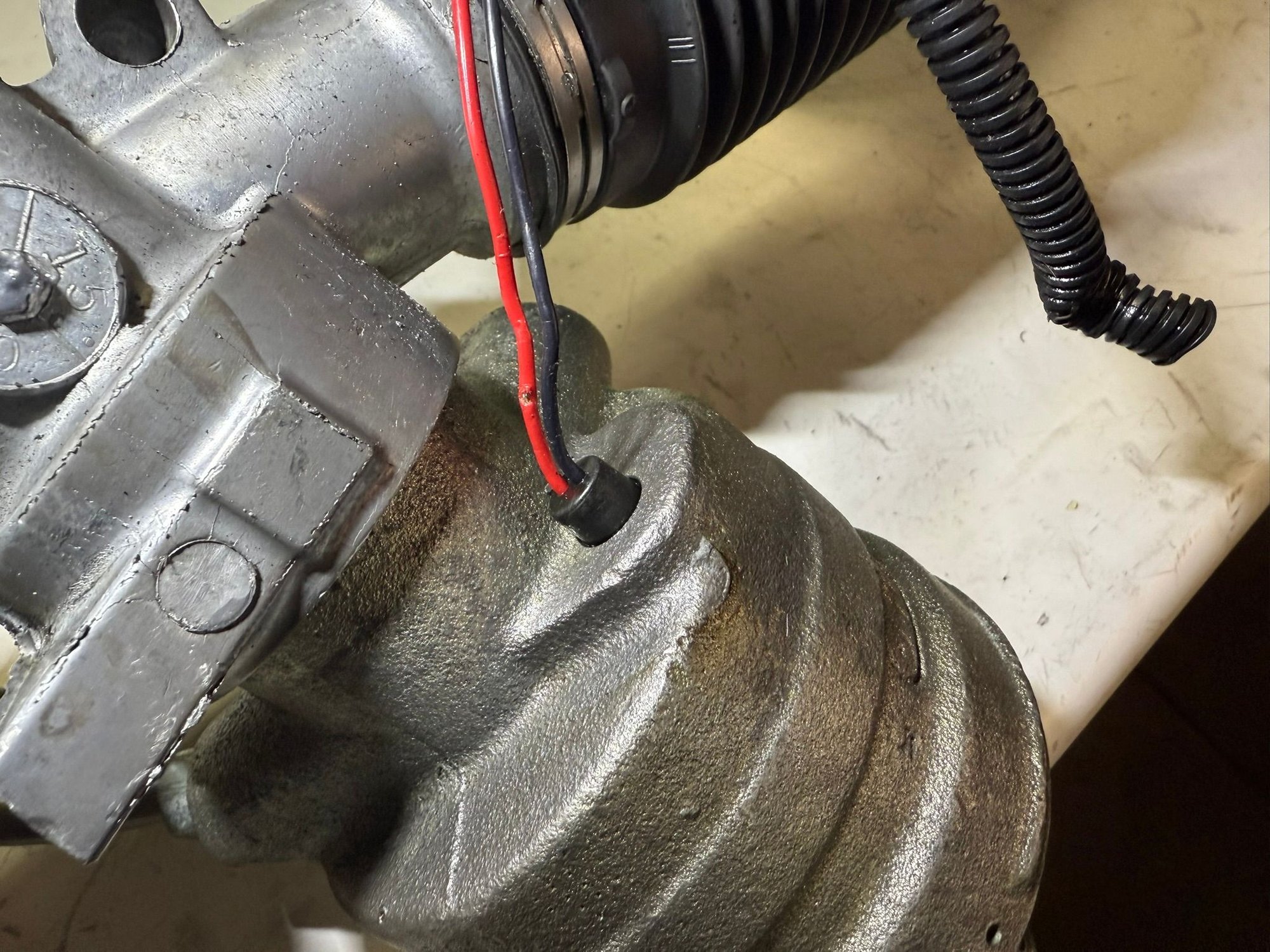

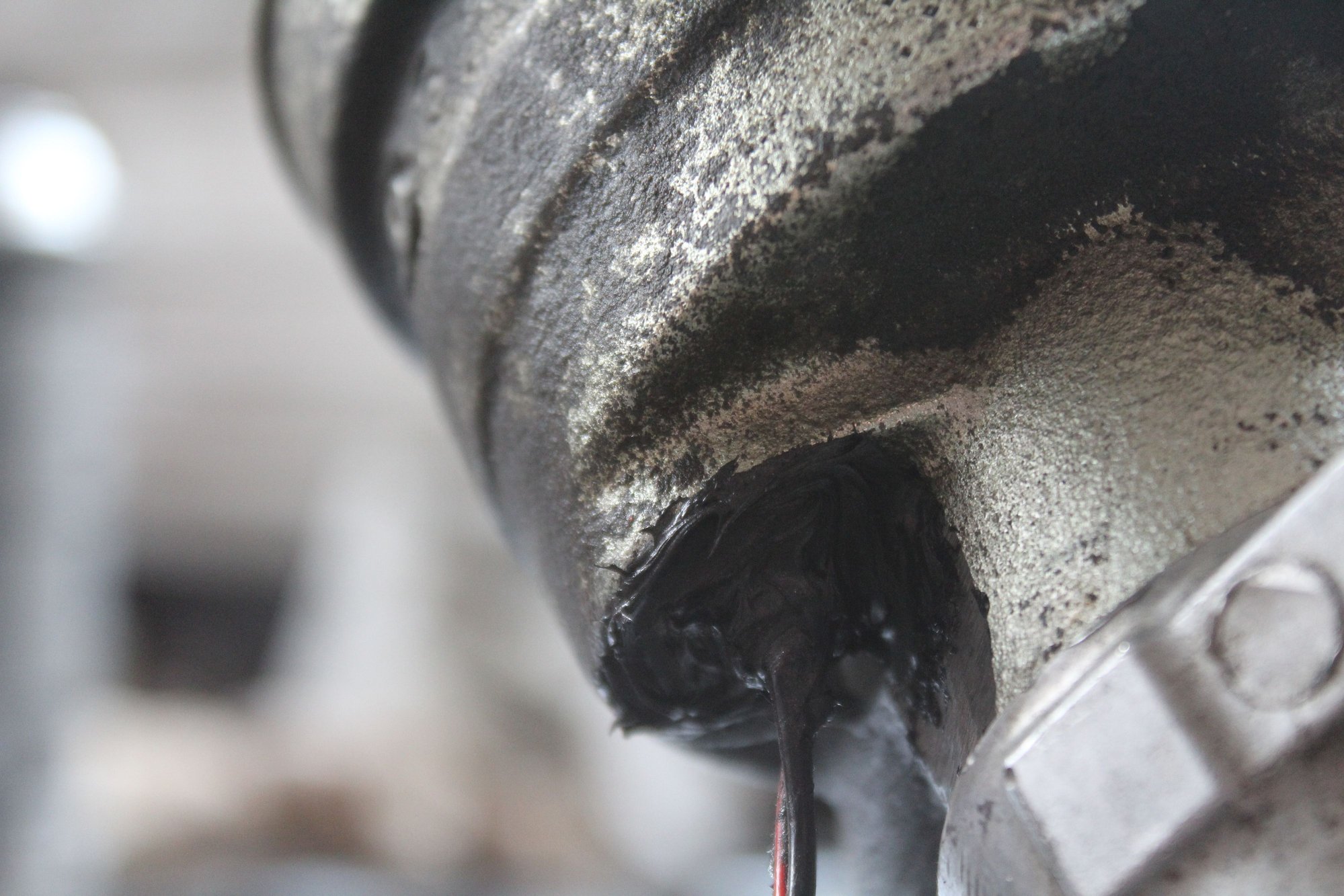

My rack was rebuilt by turn1, but I found out it is still leaking profusely from the magnasteer wires. With the money invested into rebuilding this thing, replacing it is just not an option right now. I pulled the rack and let it sit overnight after cleaning it up and this is the amount that it leaks. I am looking for any suggestions on how to stop this leak. I had read somewhere else that "The right stuff" sealant globbed onto where the wires exit would have been a good fix, but with all this epoxy there, I'm not sure if that changes that. At this point, that is my only plan of attack unless someone else out there has a better suggestion...
Overnight leaking from wires

The time to ask was before you globbed on the epoxy. It would have been nice to see of the strain relief/seal was in place. The rack needs to come out for repair. Hopefully the epoxy can be removed without much effort. It does not look like you did any surface prep.

Yep..sorry, misread that. I thought you put the expoxy on. What a **** job they did.

that certainly looks horrible if Turn 1 did it.
I had luck pulling a small vacuum on one once and "sucking" some permatex into the joint and got it to seal. I don't know how long it lasted but the customer was happy at least for a while.

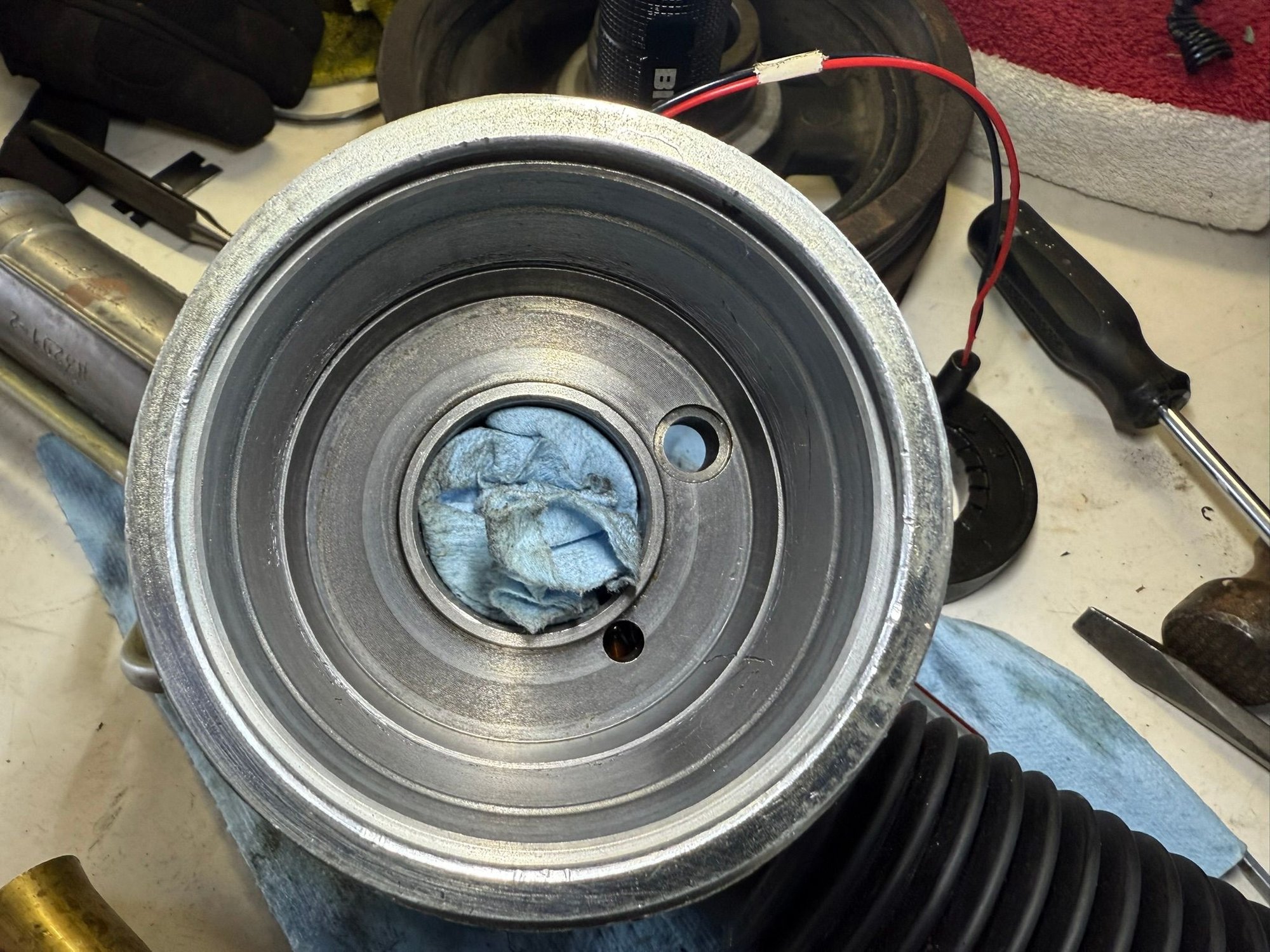

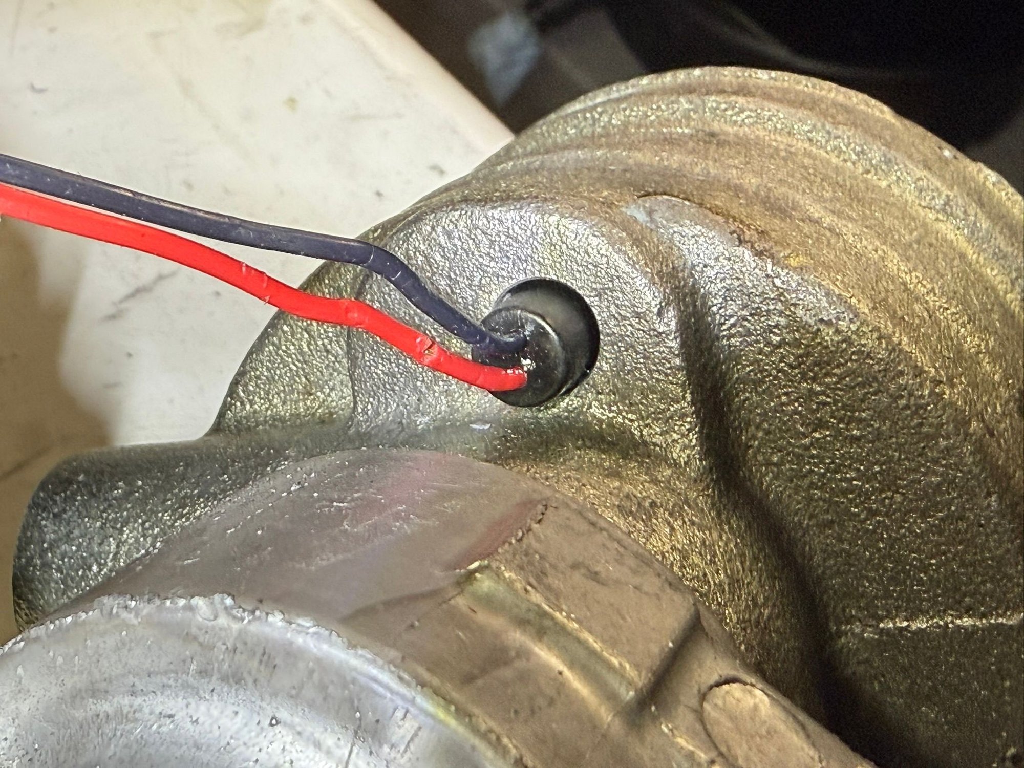

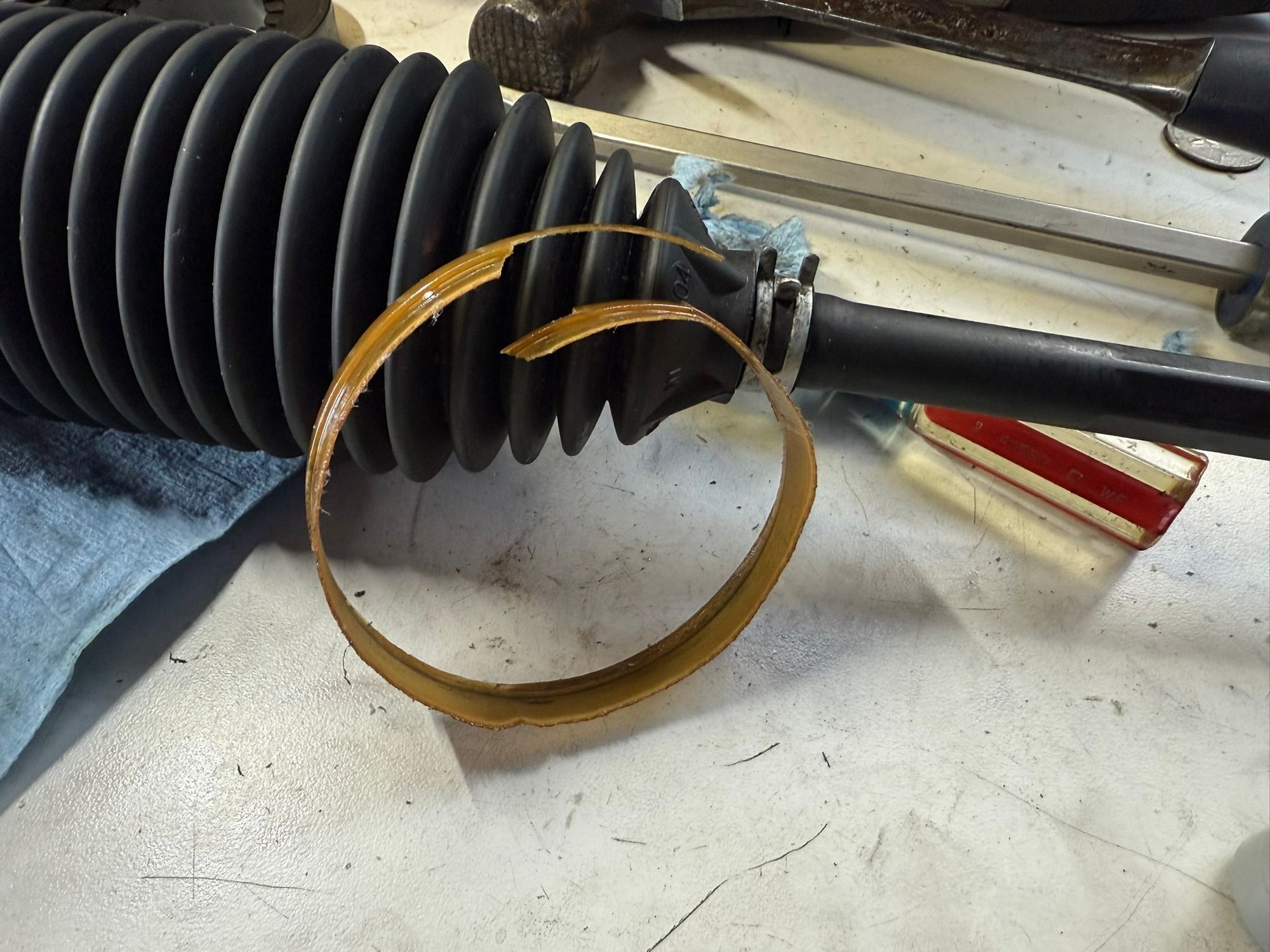

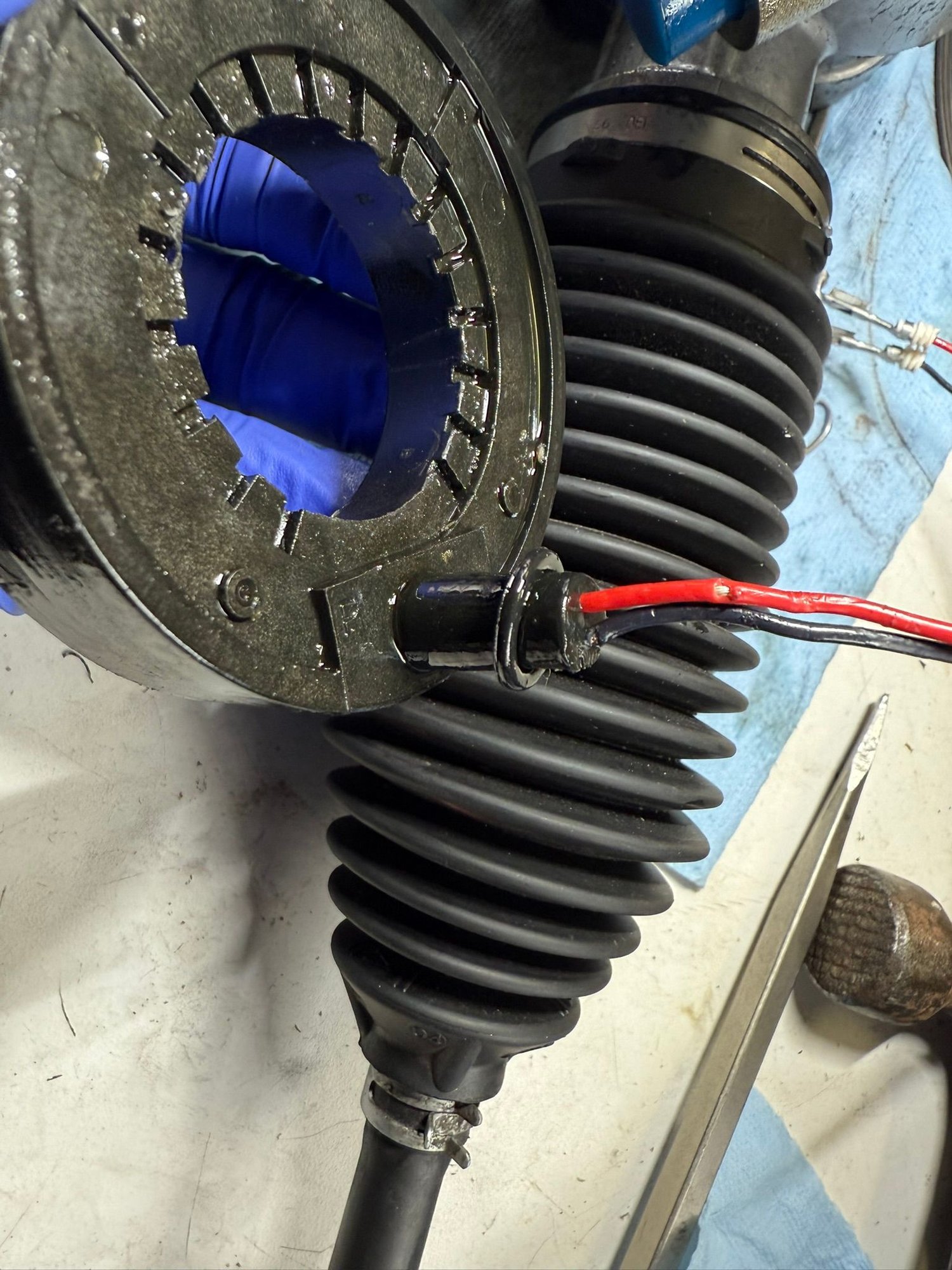

Here's where we are at now... I did some research on epoxy removal and just now, I decided to take my best shot at it. I had read that solvent can take care of epoxy.. I kind of doubted it and I confirmed my doubts when rubbing some laquor thinner on it did absolutely nothing. At any rate, it didn't cost me anything so I moved on to the more serious stuff. The propane torch
To my suprise, it didn't take much to start cooking the epoxy and make it brittle. I was super concerned for the wires, so I really just hit the top edge of the epoxy just to see what kind of effect I would get. I then took a chisel and started scraping at it. The crusty burnt epoxy came off pretty easy. I then scraped towards me in the direction the wires were coming out and I felt the whole glob of epoxy break away and shift. To make a short story shorter, I ended up separating the epoxy from the rack and using a pair of vice grips to break away the epoxy glob until I split it in half and could safely separate it from the wires.
I'm not sure if what the best option for sealing it still is..I had a thread saved where someone documented their whole rack rebuild, but I am afraid I may ruin my own rebuild upon disassemble or even reassembly to get at the magnasteer part. I think a while back someone said you can possibly seal it externally with permatex 'the right stuff.'
Here are some photos for your enjoyment:

Nice job keeping the wires mostly intact.
I made the rack rebuild DIY thread, and another member shared super useful information regarding sealing up that Magnasteer connection "the right way" from the inside while the rack is apart.
It may be tough to achieve a reliable seal in that region because of oil / oil film that you can't really clean off. Maybe a series of pressurized cleaners (such as brake cleaner?) which don't leave a residue can give it the best chance of success.

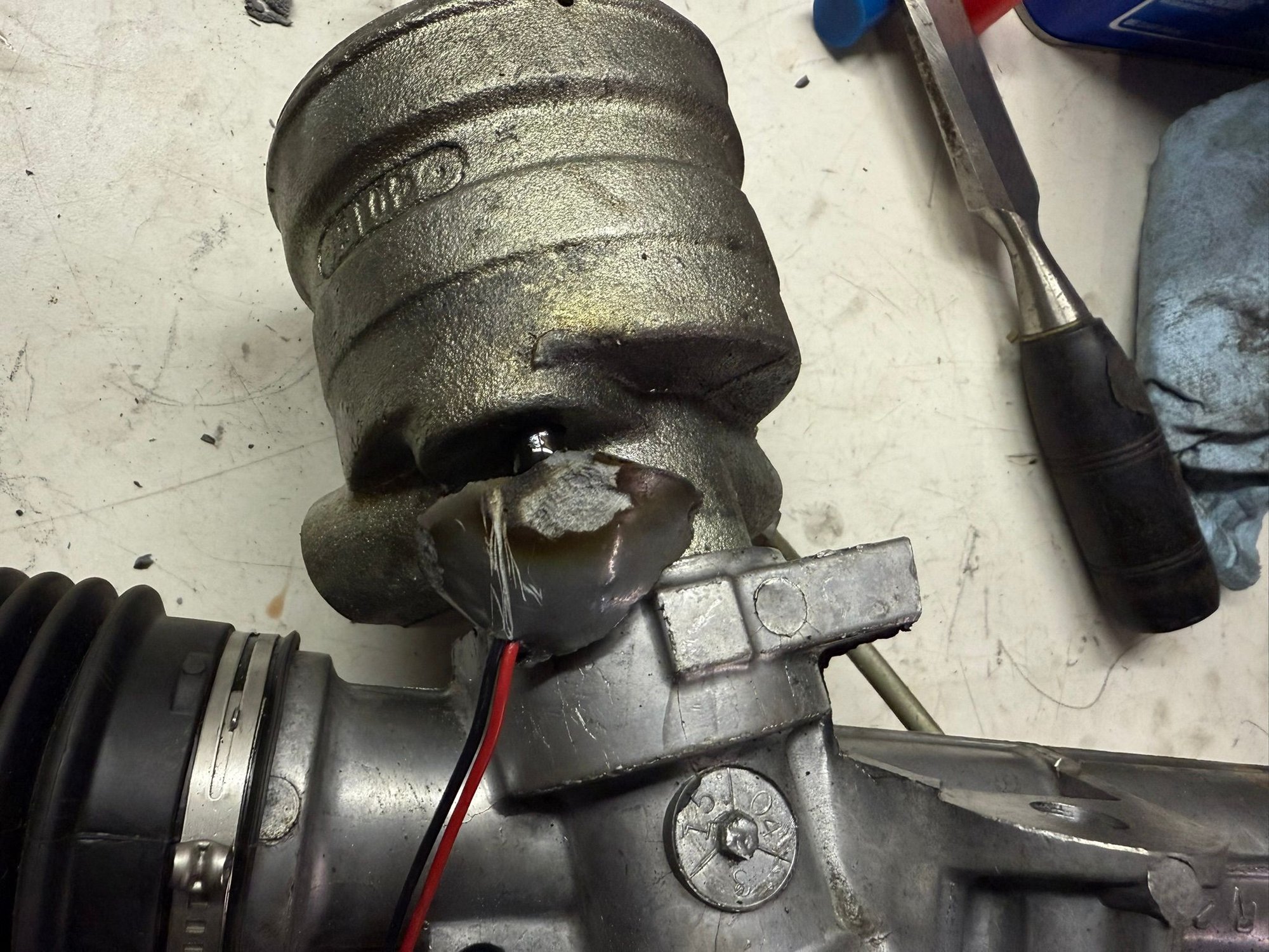

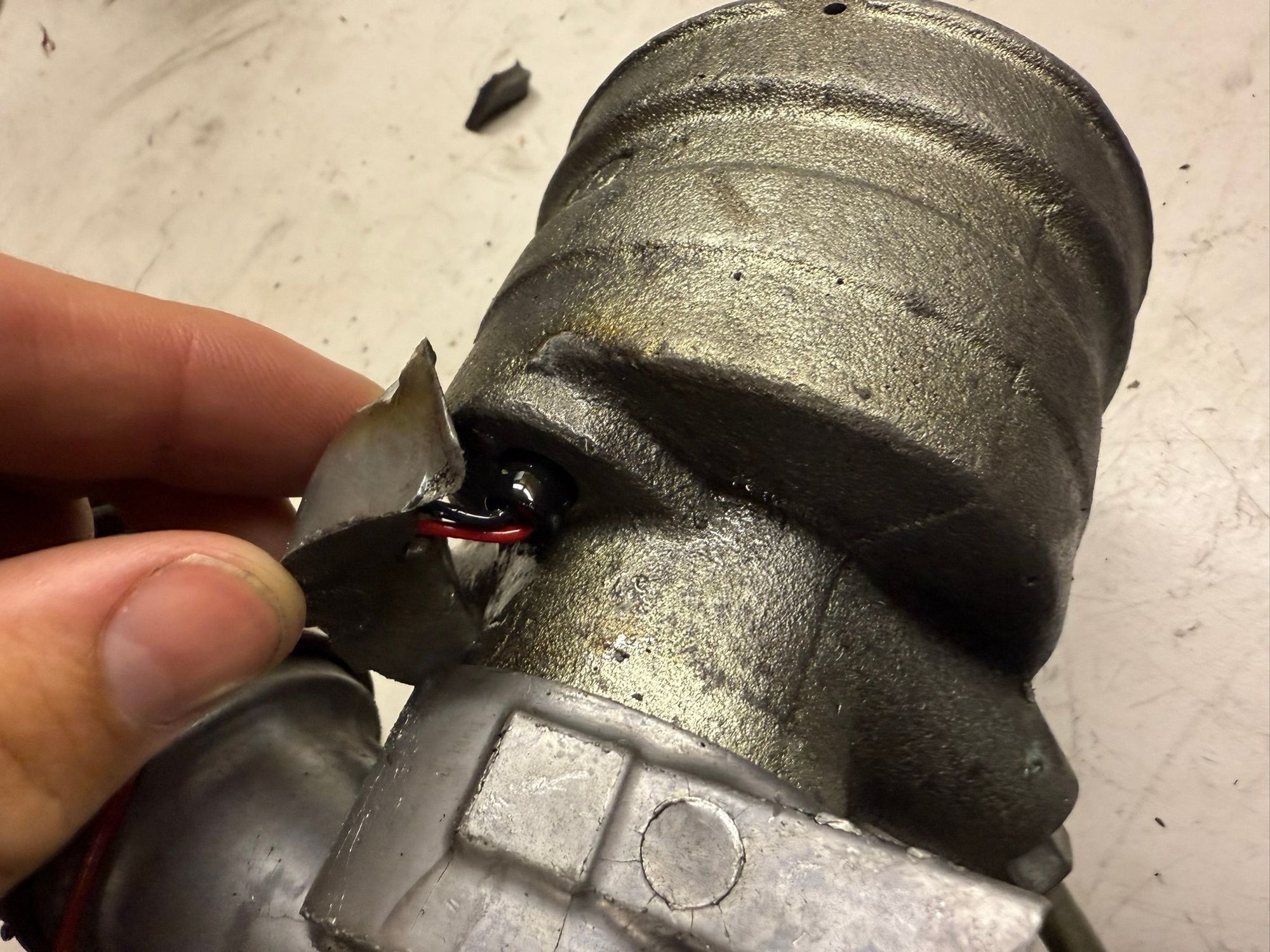

After a $hit ton of scraping epoxy and some clever use of crossing two screwdrivers to pry it out... here we are. I am trying to figure out a way to make my own groove for the oring further down the "post" where the wires come out. My plan is to use two orings and permatex. I was thinking maybe using the edge of a grinding wheel and spinning the magneto by hand, but that sounds like theres a lot of room for human error, so I am open to ideas out there. By the way, look at all that epoxy! Gosh DaNg!

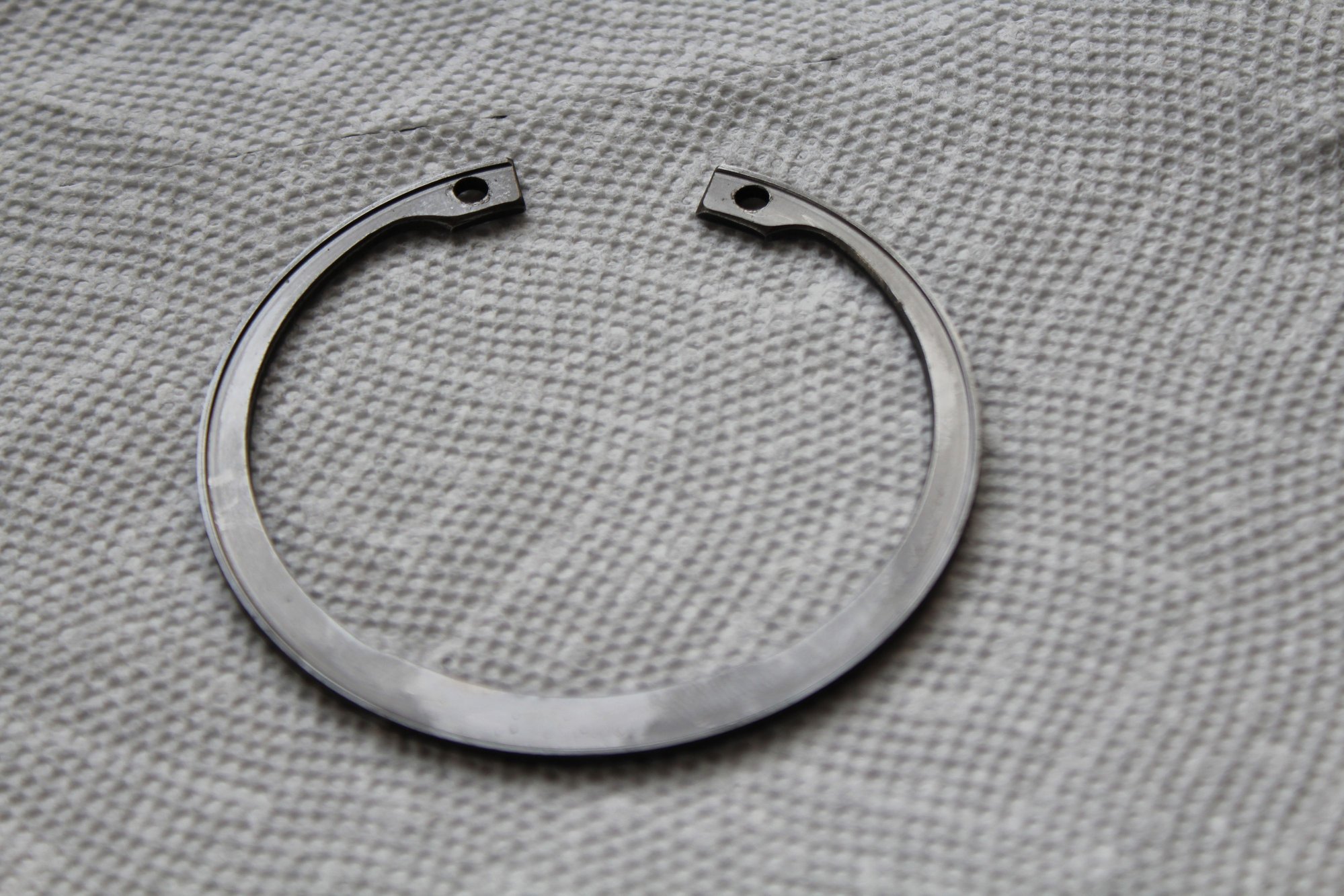

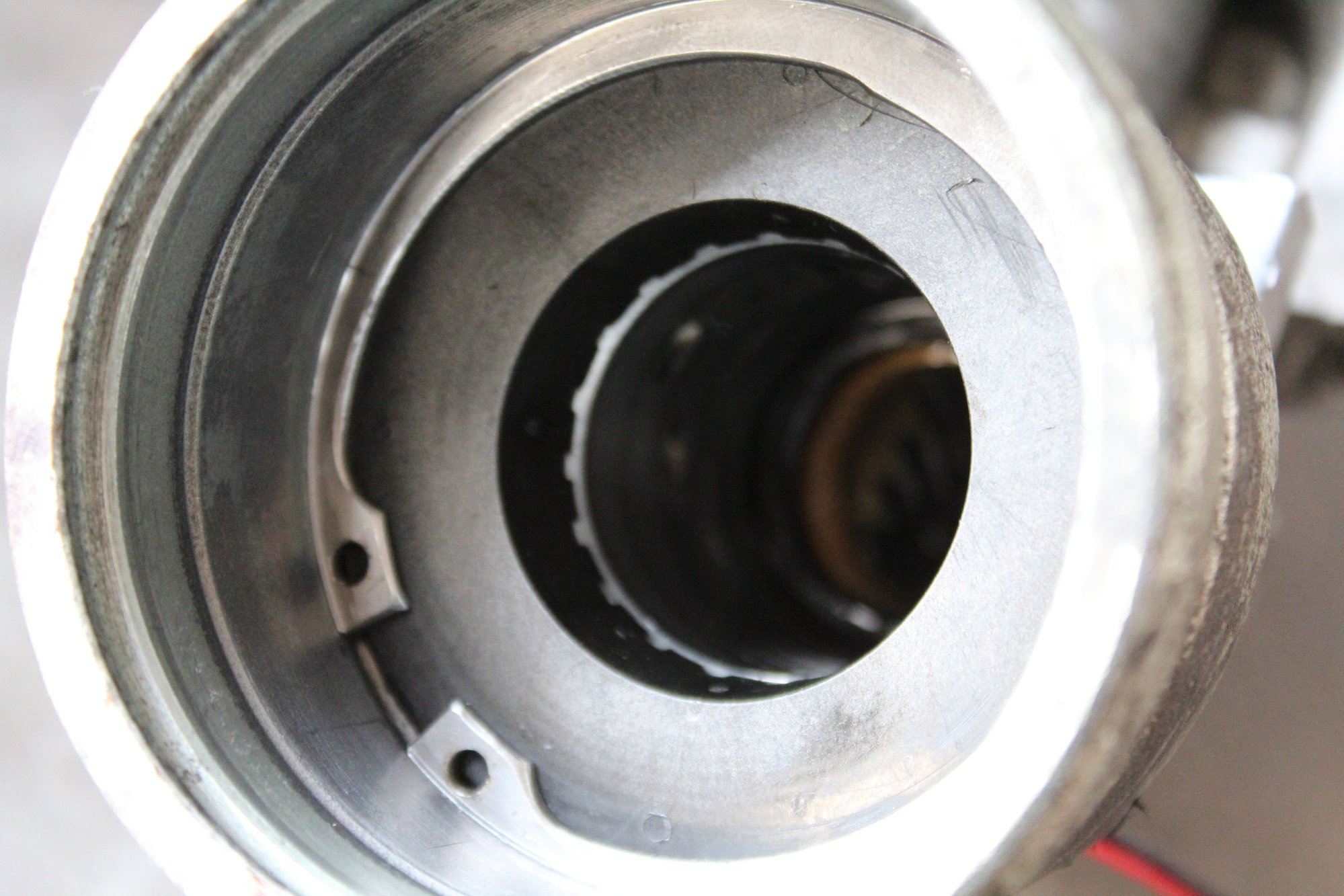

A few years ago, I took apart a friends rack. I came up with this snap ring idea to hold the wire assembly down. Needed to have my machinist do just enough to clear the magnet on the pinion shaft, but hold firm the wire assembly. My friend did not install right away. Time went by and last year he sent that rack to Turn 1. I do not know all the details. But he did install, and so far is ok.
