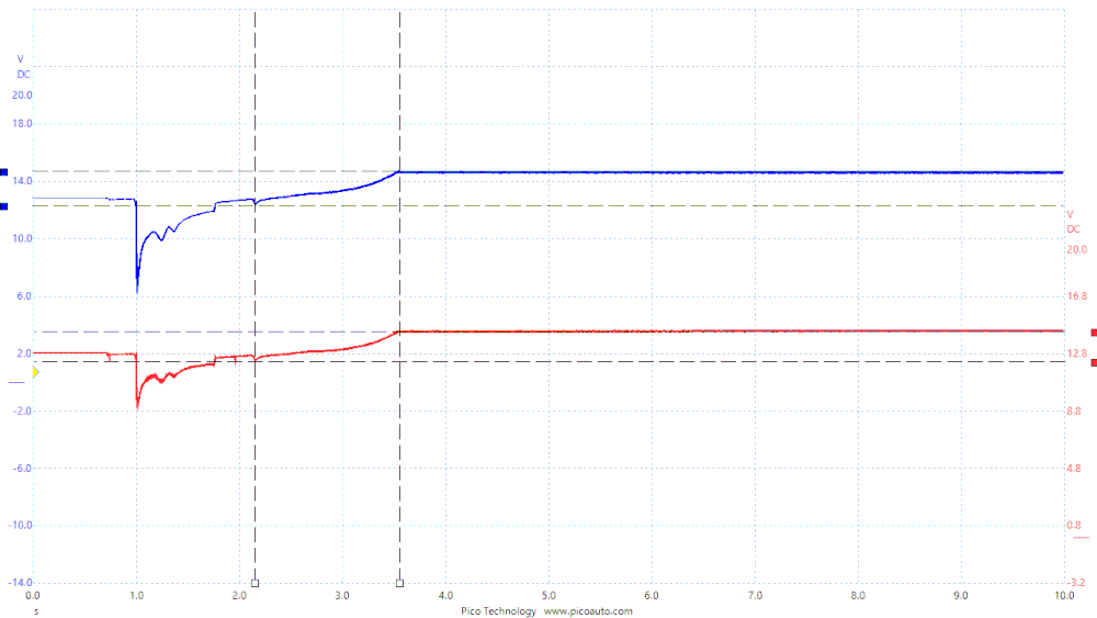

Your “charge system fault” does not have anything to do with your alternator current output or voltage…it is the incorrect voltage regulator that is installed in it…I don’t know the part numbers but you will find it in the Forum somewhere…these OEM Valeo alternators have a “soft turn on” feature where there is a slow rise in voltage when the car is started…if it’s too fast (high PWM at start up) the fault will show up…you can see this slow rise in voltage below on a good alternator with a scope…a 2 volt rise in 1.5 seconds in between the 2 vertical lines.

Nice scope capture. I'd agree, GM gets stupid with start-up tolerances some times. Another example is anything Atlas engine equipped throwing a VVT code on cold start even through the VVT works fine once it's running.
Besides swapping the regulator, you can also tune it out so it just doesn't fault anymore. That's what I did with the Atlas, turn the code off and it worked fine.

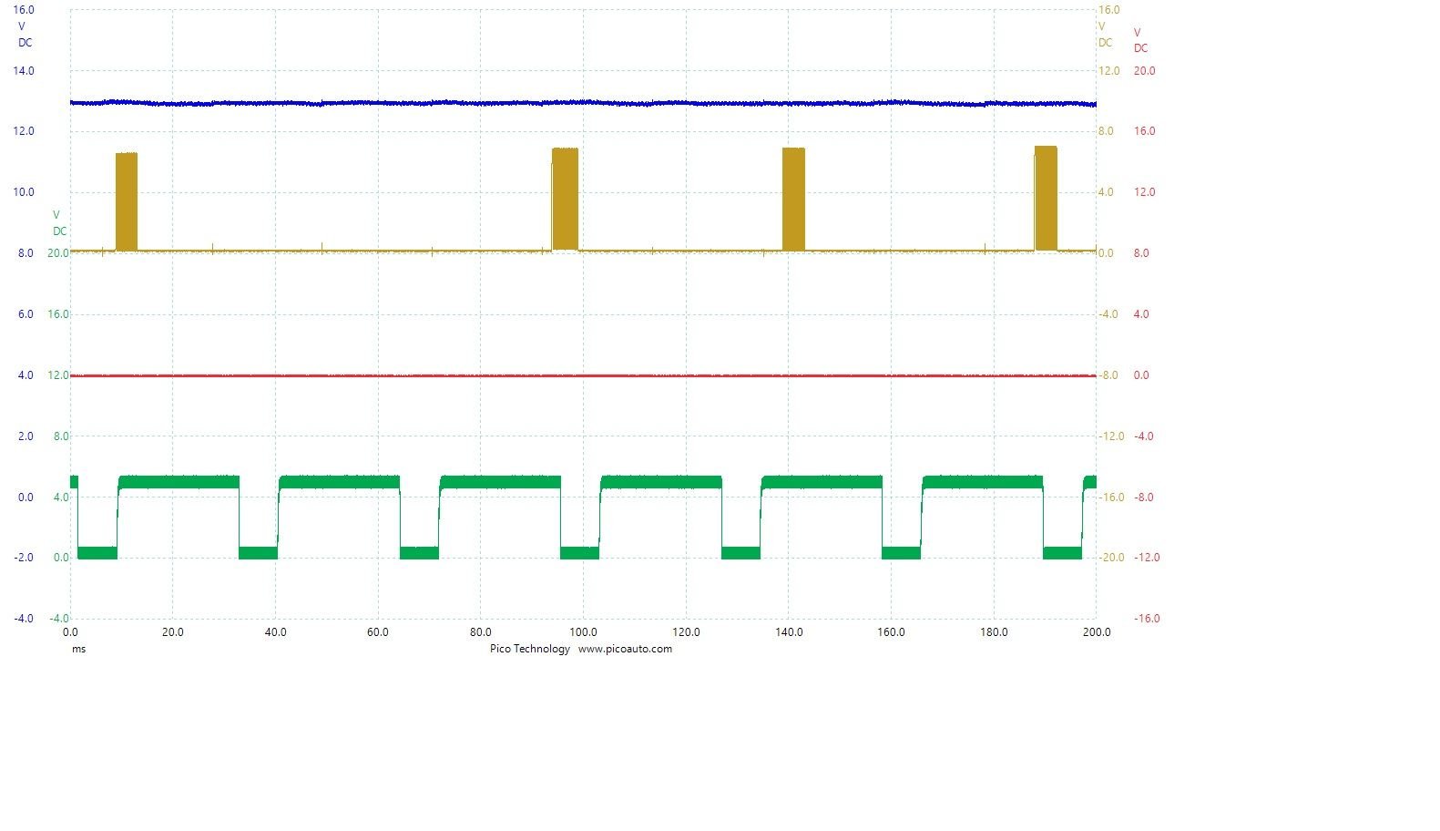

I see you have a ‘98…have you ever checked the blower control PWM signal ??…I’m trying to help a shop owner who posted here a week and a half ago and was having issues with his ‘99 blower motor speed…when I scoped his PWM signal it was 5 volts (green trace below at 5 volts) looking at service info it looks like from 01 to 04 it’s a 5 volt PWM signal and 12 volts prior…his blower module is putting out 5 volts so I don’t know if he has the wrong module or HVAC head…power, ground, PWM, and serial data below…think he’s has the wrong parts installed !!

I never have, but I highly doubt that it changed. There would be no reason to do that. The manuals say the early PCM output to excite the alternator is 5V and it's really 10V.
