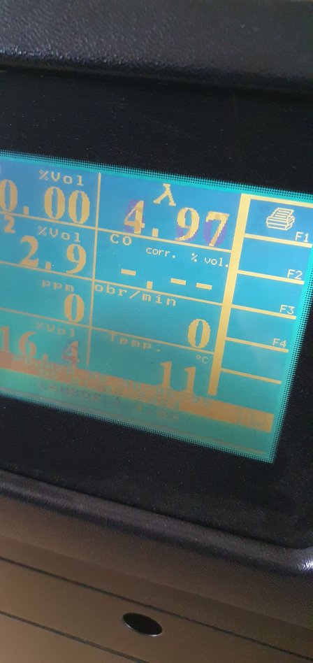

I have 1999 c5 corvette, i have imported in 2015 to PL. Since last year im struggling with lambda ratio readings, which i have actually 4.97 on idle. When reving 2500 rpm it drops to 2.69 and stops. I have recently updated exhaust from catalitic converters TIER1 to EURO4, i have replaced both front o2 sensors to bosch, and rear ones to delphi. its readings are proper, no DTC popping up. Absolutely no problem with the fuel - oxygen mixture, car accelerating fine, there no smoke. During the test CO=0, HC=0. this car is california NB6 emission standard. So i suspect the A.I.R check valves. Those are last parts i can replace, whole system piping and hoses are tight. I dont understand where is the problem with this lambda ratio? Or maybe this is a problem with a measuring method? They using one probe installing it in one exhaust exit of 4 existing. Anyone had such problem, or can suggest me what can be done to resolve this problem? The cause of doing that is a need to obtain an equivalency certificate for this car to EURO4. Thank you.

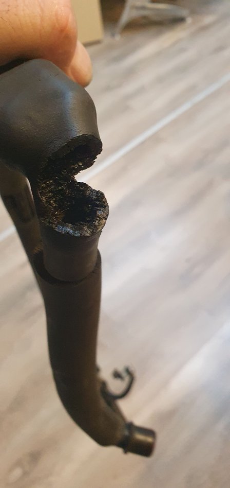

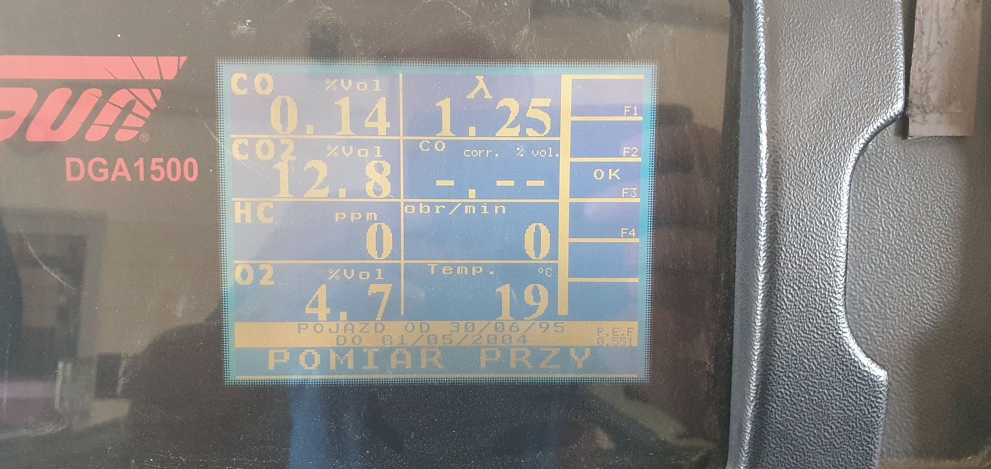

That may be an idea with those trims. I will check tomorrow. But I have checked AFR that is 14.8 on idle. I post also photos of this measurement with 4.97 lambda ratio and the earlier with slightly elevated lambda. THe o2 sensors have 1000 miles on them. So they are barely new. I bought also a faulty sensor (it was replaced to the good one same day), then ECU give an error immeiately and the engine idle roughly. I have tightened conecctions on the passenger side of the throttle body. On this piping i have found rubber elbows that were leaky. I have replaced both of them using a regular oil resistant pipe pieces. I dont have any idea where is more vacuum lines. Prior to do this i have checked lambda and it was 1.15 so slightly elevated (i have felt an odour coming from the tail pipe after startin cold engine) After tightening those connections lambda value was raised. After replacing cats the smell was gone. I dont see other vacuum connections on the back of the engine near a firewall. Those vacuum are located only on the top of the engine (LS1)? Do you have some vacuum lines diagram ?
After tightening vacuum lines, replacing cats to EURO4 and all lambda sensors.
After tightening vacuum lines conected to the throttle body, replacing cats to EURO4 and all lambda sensors.
one year ago. Lambda was elevated. Proper value should be 0.97 to 1.04. After this i have started to search started

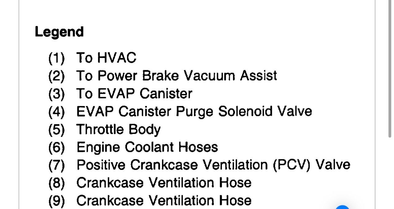

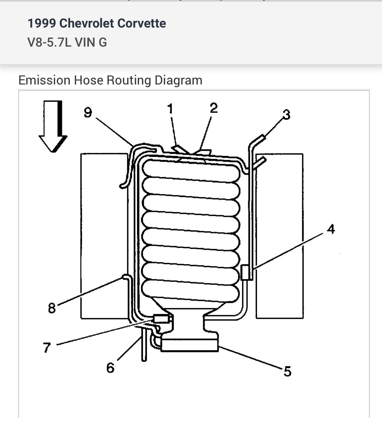

Old Nov 10, 2024 | 06:14 PM
C5 Diag's Avatar
C5 Diag
Moderator, Tech Contributor
Posts: 15,644
Likes: 4,082
From: Cape Coral, Florida

Those numbers looks fine, i have found leak in the rubber case of PCV valve - i have repaired theat using rubber hoses - On the back of the engine are also some rubber connectors between the vacuum lines, maybe those are faulty, but i dont know how to get this place. Better i will order those vacuum lines on ebay or amazon and replace during the winter in the heated garage. Can also i suspect the AIR valves? I have read that those are immortal...?

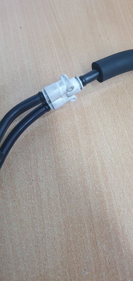

I have founf next problem with vacuum lines:
And have replaced with SMC Y connesctor 3x10 mm tube slot. (white means clean so for food industry etc) - it laso possible to use it from Festo etc black ones.
After this repair i have measured manifold pressure that was on cold engine 0,36 mbar 36 kPa and with 176F coolant temp.
