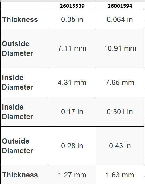

Where did you get that p/n from, and what year is it applicable to? Curious if something changed after 2002?
My parts manual shows p/n 26015539 for 2000-2002. A quick comparision between that and the p/n 26001594:

Yep, that's when I changed mine too...when I installed the vortech. Something was obviously updated.
