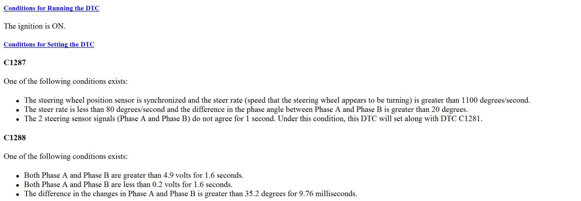

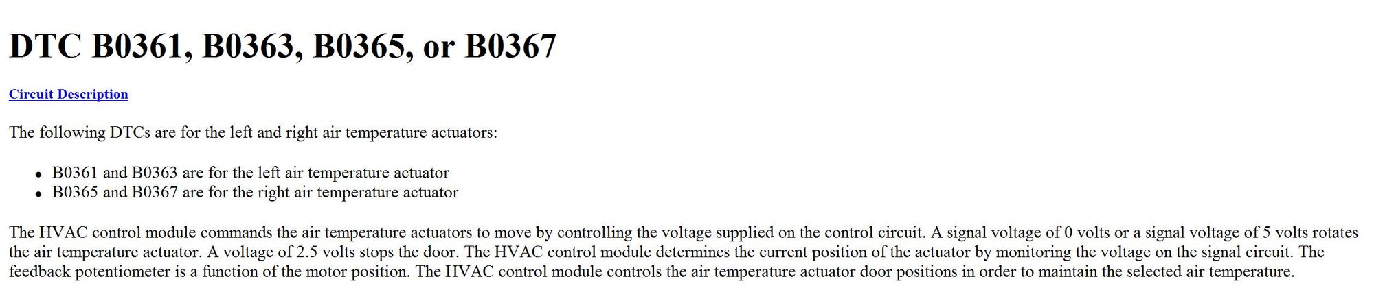

My codes are
CI 1287
CI 1288
BO 361
BO363
BO516
Please and thank you for your help!!

It seems like steeringwheel sensor does not operate correct ,your temperature actuators does not operate correct and the vehicle speed sensor data from PCM to the cluster is not correct.
You need a scanner similar to Tech2 so observe the steeringwheel sensordata in the EBCTM module . HVAC actuator data within the HVAC module and to see vehicle speedsensor data in the PCM/cluster .
After this has been done further troubleshooting can be done based on what you observe on these data
