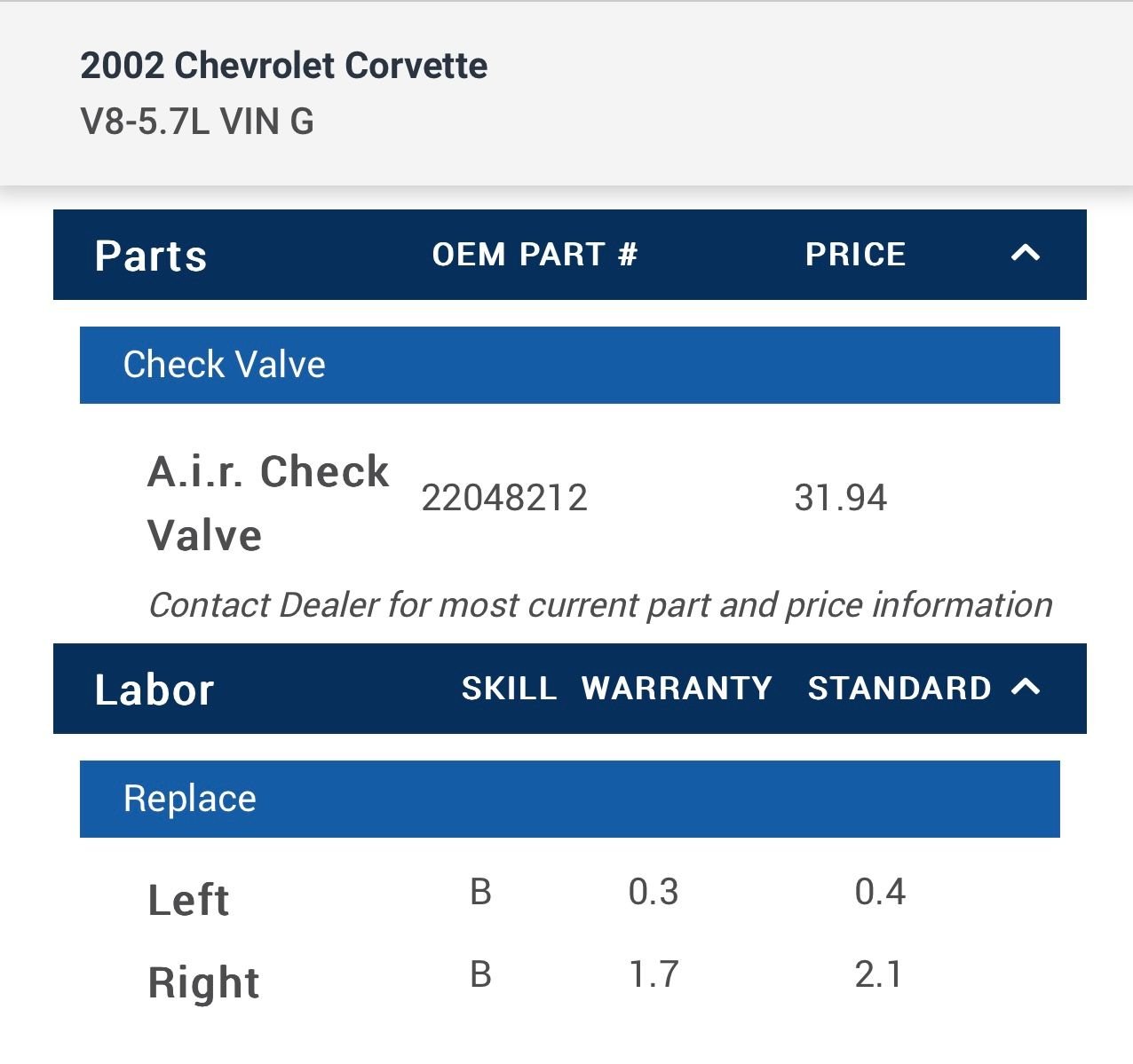

The p/n I have for a 2002 is: 22048212. That may or may not be the problem.

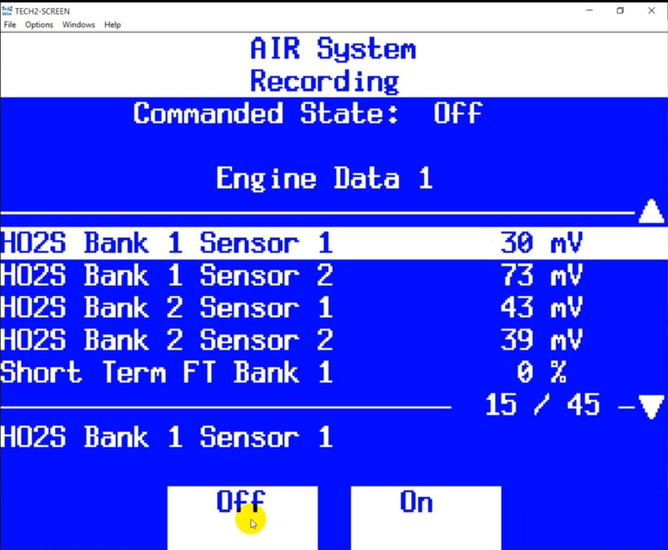

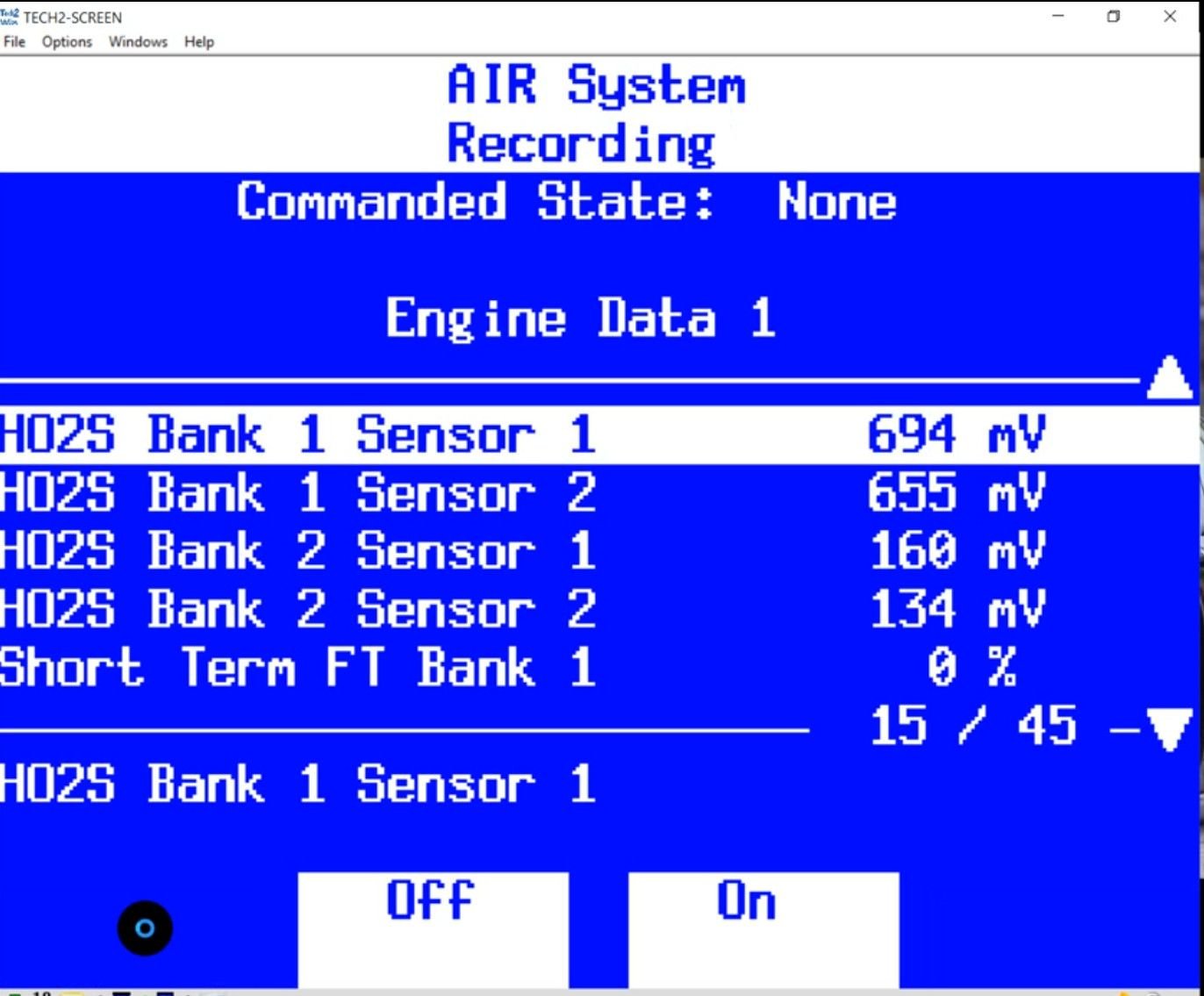

If you use a Tech2 scanner and observe the O2 sensor voltages when you (idleing) start the airsystem you will observe both bank 1 and 2 voltages drops very low as the last screendump does .
If your bank 2 pcv does noe pass air from the airpump to the exhaust manifoil the bank 2 voltage will continue to shift between 0.1 and 0.9 volt
Ah, yes, saying which model/year is basic stuff I should have included in the post, my apologies, but yes, a 2002!
Many thanks to yourself and others for the helpful replies
