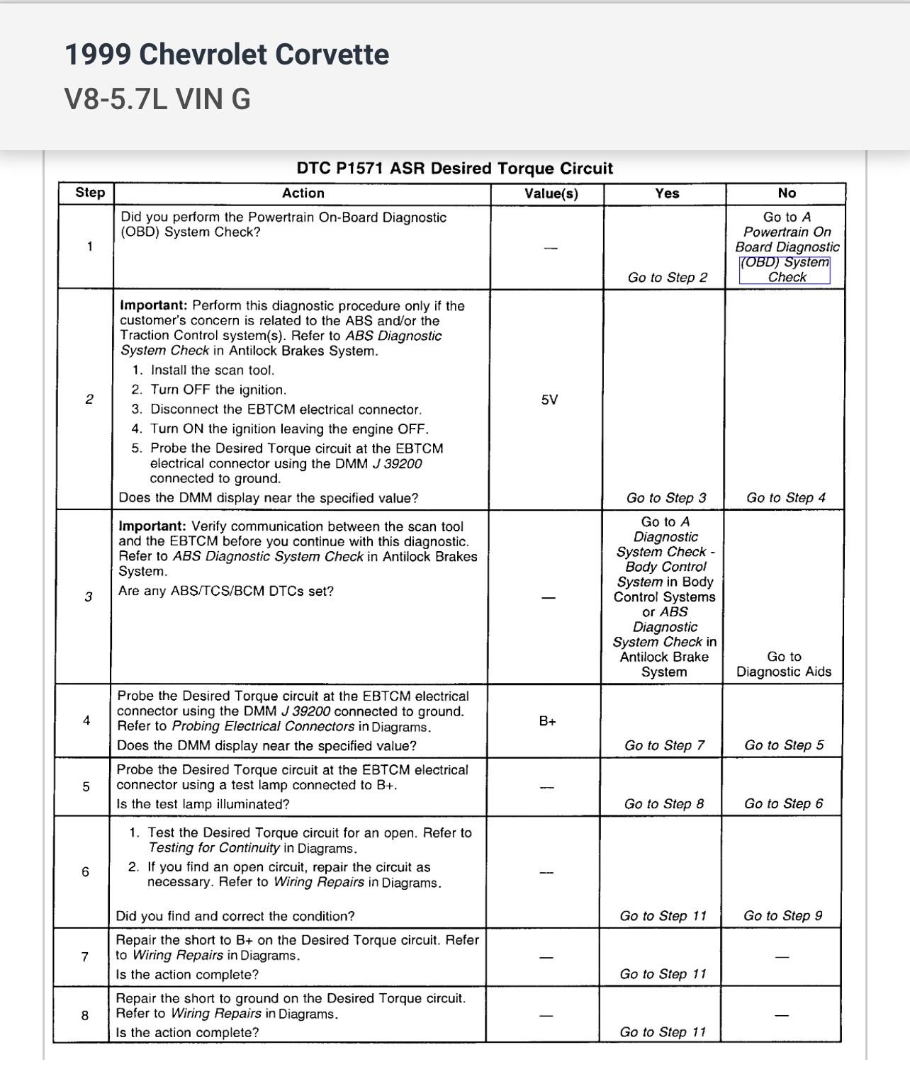

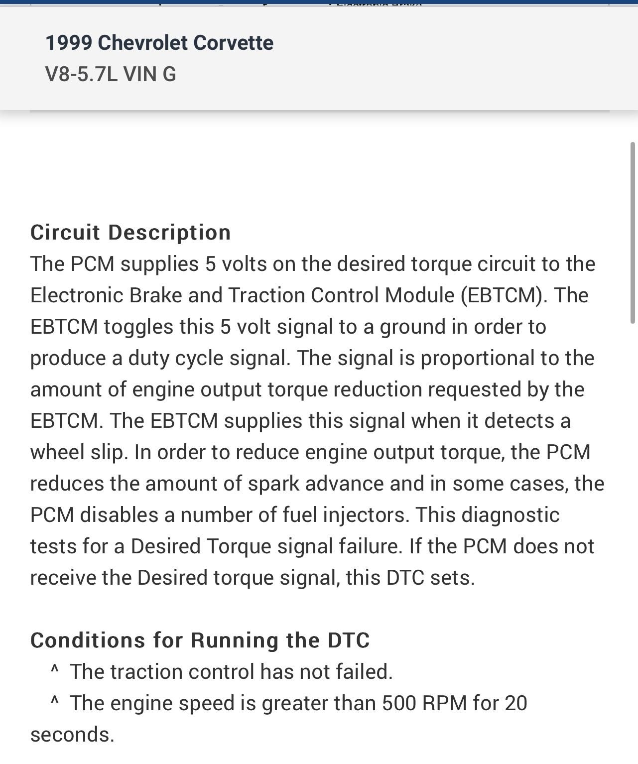

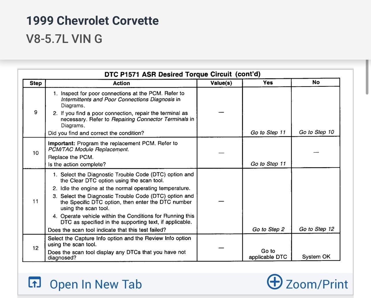

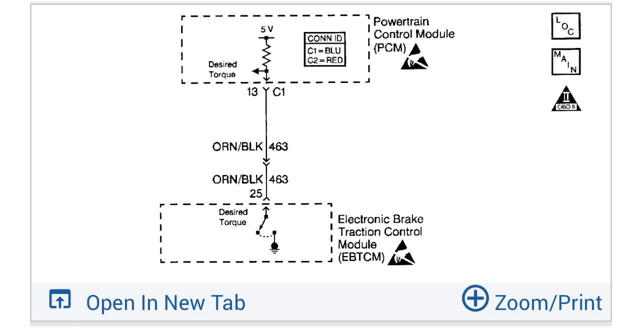

Here is everything you need to know to diagnose a P1571 !!

Are you able to get someone with a scanner (like Tech2) to check the EBCTM and the PCM parameters ?
When the engine is idling the requested torque signal (5V) is approx 90% to the PCM .
These values and oscillioscope screendump is from my car .
Your Req Torq value seems to be way out since the DTC 1571 has been set .
A scanner view into your values may give some more info on where to go next
