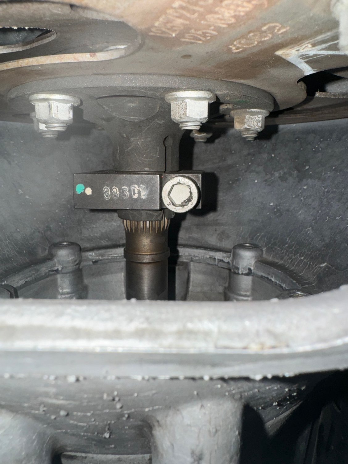

What’s the torque spec for the bolt that couples the flex plate to torque tube input shaft or what’s that bolt even called so I can look it up myself?

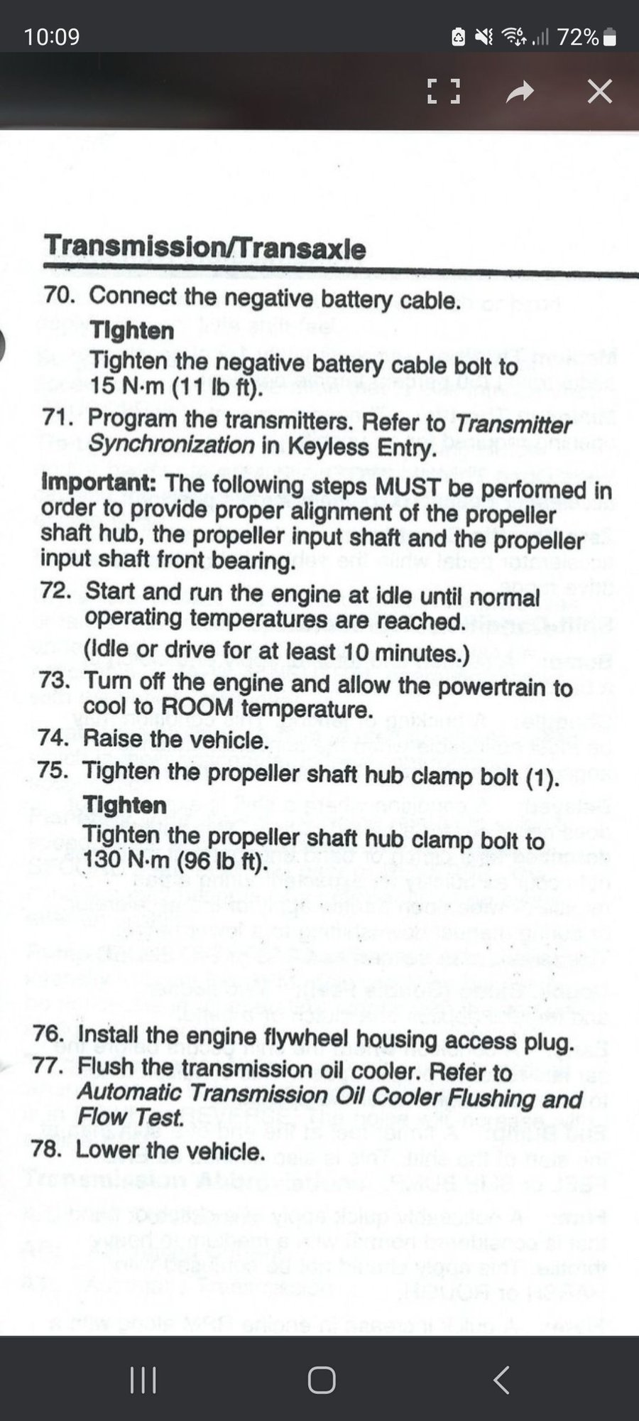

Found this in another thread
