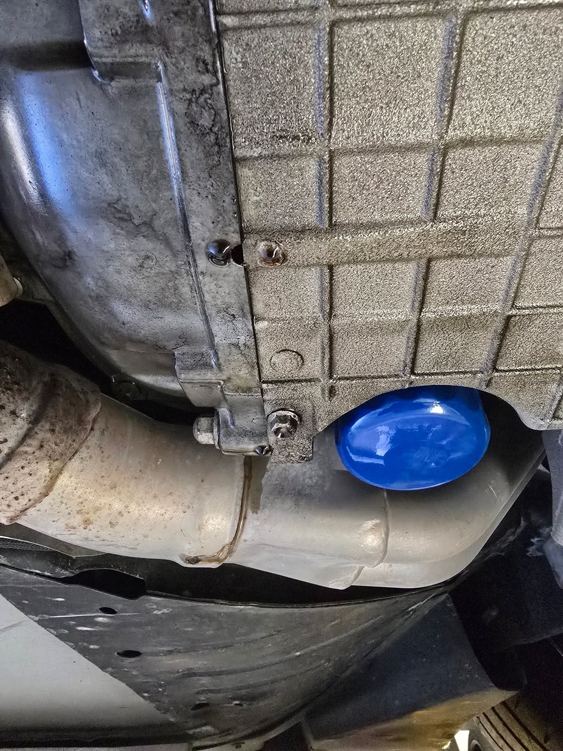

Can anyone tell me why I am seeing drips of oil from here (see pics)? I started seeing it a few days ago. The car was smoking as well. Thank in advance

Because a gasket, seal, or component has failed......and the oil is either dripping(or blowing) onto the hot exhaust. I would degrease, put dye in the oil, and inspect with a black light after a few miles.

Let’s just say, put the dye in as suggested, drive a few miles as suggested. Then using a black light, look around under there and wherever you spot the dye/leak at the highest point should be your culprit. Leaks rarely flow upward. Give it a try.

Then ill throw im in before he uses dry which will find it. Since its on its left side i say oil sending unit.

I would shoot for the low hanging fruit. In this case, I agree with @helga203 . The C5 oil senders have a bad reputation. They have been known to read fine, but leak oil at the same time. I'd replace that first with an aftermarket unit. I bought one, not even their best unit, at O'Reilly at least 6 years/40,000 miles ago. It was the 12 month guaranteed unit, not the lifetime one. Still doing fine. It may not be the problem, but its relatively cheap and could be the problem. If not, you should have no sender problems for many years....

So after 2 months the part came in after I had to threaten them with lemon law. They replaced the valve cover and it looks like it is not leaking oil. They said they cleaned the engine. Problem is the whole car smells like burnt oil in the cockpit and when I put it in my garage the burnt oil smell filled the garage and seeped into the house. So not sure if they did not clean the engine properly or it will take time for it all to burn off. Not sure if it will all burn off. I cant drive a $150k car that smells like burnt oil. Not sure if it needs to be cleaned again or what. Think I will file lemon law claim as I cant own a car with this smell. Any thoughts? I am sure the oil got in all the nooks and crannies, or maybe it still has a leak.

150K? That is a hell of a C5 there. Did you check the oil pressure sensor? I can tell you from experience a leak that large will have residual oil every where and you will smell it for a long time.

I have a similar oil leak on my 2000. It,s tough to figure out, first thought is a rear main seal leak but fixing that is a huge job. I opt to try the easier fixes first. As people have said, it could be an oil pressure sensor or cam position sensor located at the top rear of the engine block. To repair either of these requires removing the intake manifold. The oil sensor housing can leak and once you get the manifold out of the way you can inspect for an external leak. The cam sensor is next to the oil sensor, if the o-ring is leaking you cannot see the leak because it’s inside the bell housing. If you’ve gone this far, get a new cam sensor and install it, then see if your leak goes away.
it can also be a leak from the crank position sensor located on the passenger side behind the starter. There is also a oil level sensor that can be leaking on the drivers side of the block near the oil filter.
The final one is the rear main seal which requires removing the rear suspension, trans and rear sub frame of the car, similar to replacing a clutch. A huge job.

I think it’s just the residual oil that leaked all over the engine, Not leaking oil now. How do I get that smell off the engine, Not sure what they use to clean the engine of the leaked oil

I used about half a case of brake clean. I had the intake off doing a valley cover and the car on Quick Jacks repairing a shift cable. I put some cardboard down and sprayed from the bottom and top. Mine had a leaky oil pressure sensor the PO (dad) ignored for awhile, the back of my engine was caked as well as my exhaust system at the cats. I got it pretty clean, that helped significantly with getting rid of the burnt oil smell.
