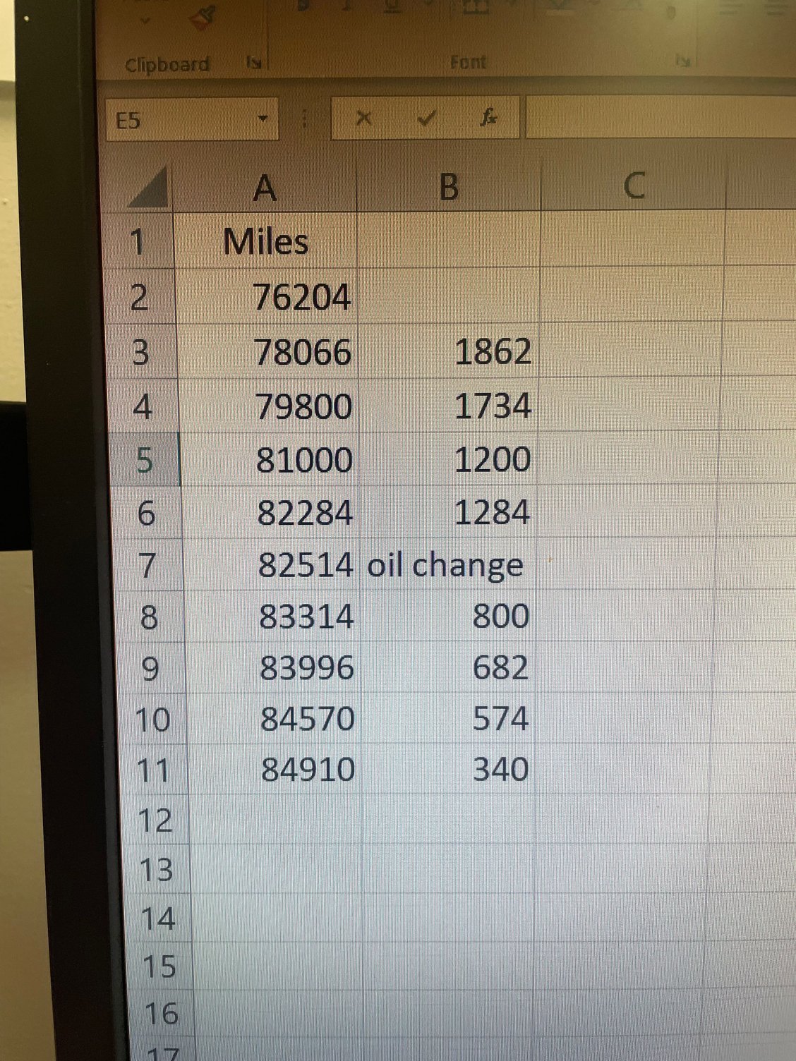

Below is a screenshot of mileage intervals when I would get a "Low Oil warning". Column on the right are the miles traveled in between these intervals. When this happens oil level is at the bottom dot on dipstick. I would add 1qt to raise level to top dot.
As you can see, it has been getting worse.

I will continue to drive normally and see if the warning light comes on AGAIN in ~300 mi. From the time I started logging this, nothing has been changed on the motor and is all DD with occasional fun sprints on the highway etc.

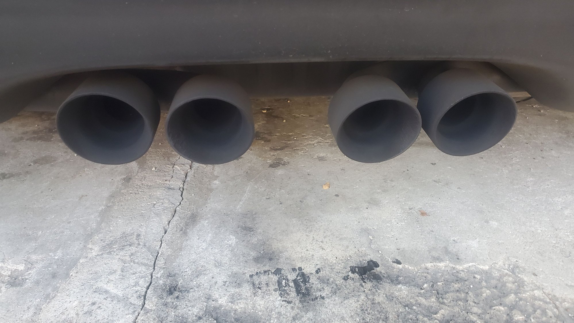

Took these pictures today. I can’t confirm how many miles since I cleaned the tips but I have noticed this is “a thing” that I don’t remember happening years ago
Buddy of mine owns a speed shop and tossed me some new plugs. I’ll replace plugs and top off oil this weekend and drive until warning light comes on again.
Another option is to go ahead and do valve seals again and springs over winter as car sits. Inexpensive to change out.

Since we're sharing exhaust pics, this is after a wash. I suspect my engine has a ring problem because the right side of the exhaust tips are dirtier than the left. In my mind, indicates a problem with a specific cylinder vs a PCV oil issue.

Looks like oil come from the exhaust since your tips are full of it, also if you remove the throttle body you can see if the intake is all oily, if it is your catch can isn’t properly installed
