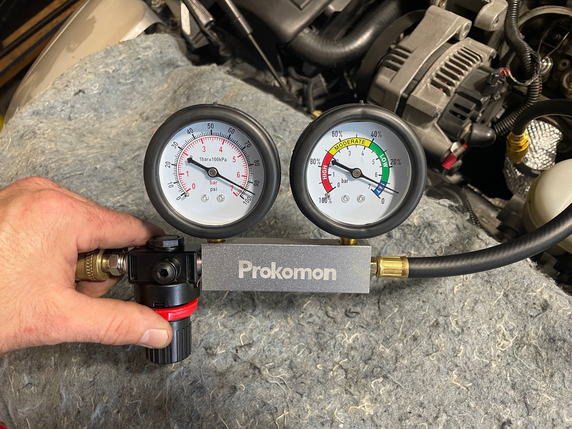

I was able to get a leak down test done. Every cylinder looked like this. Nice and healthy.
