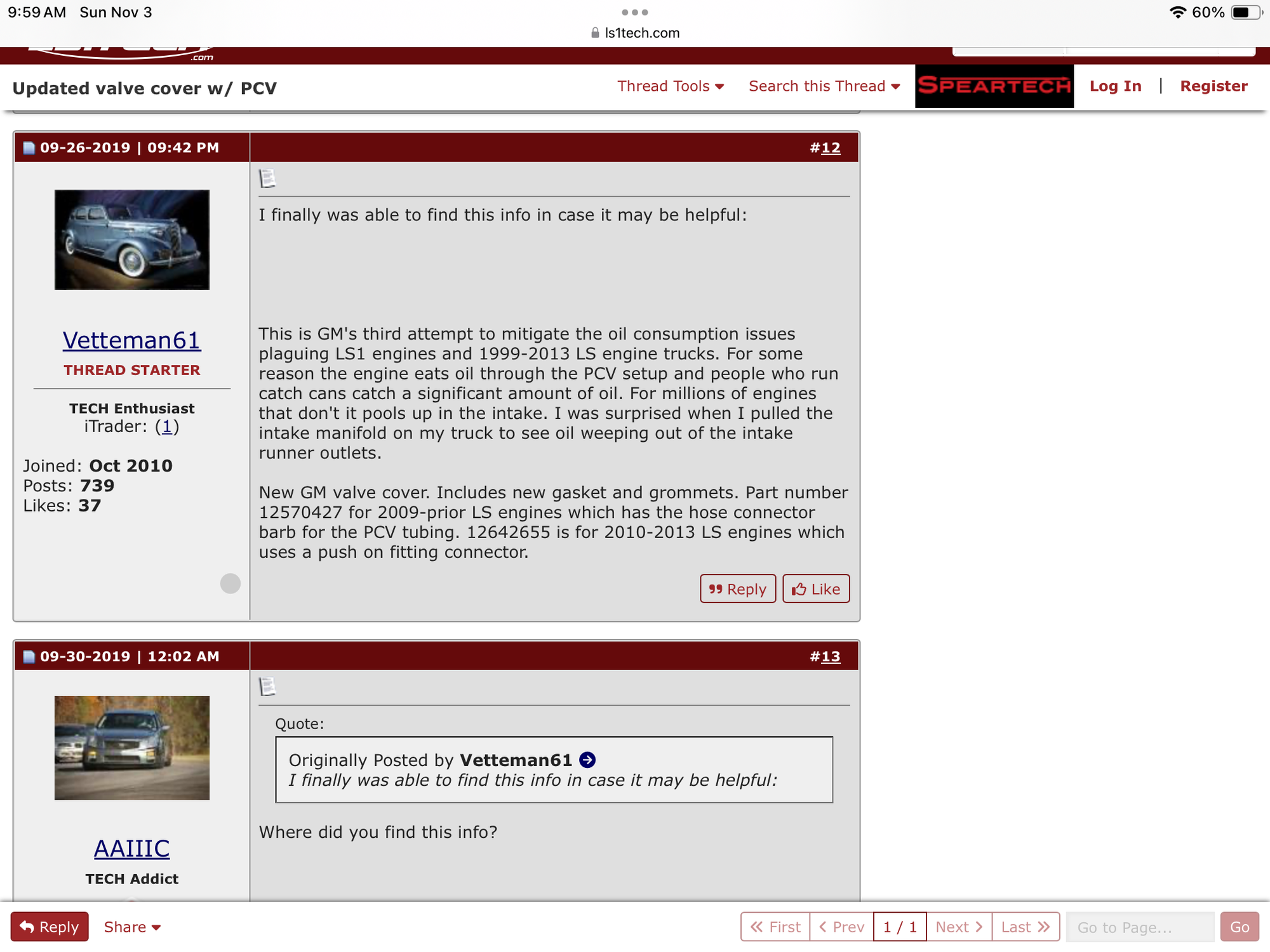

FYI- maybe the baffle on the PVC side valve cover is not draining properly. An updated right side valve cover is available. On deceleration the negative vac in the intake is pulling air from the clean side at the passenger valve cover.
https://www.michiganmotorsports.com/...s1-valvecover/
https://ls1tech.com/forums/generatio...uick-help.html
https://www.youtube.com/watch?v=CePGNsAkcYQ
Thanks for the info. My car is a LS6 which does not even pull PVC from the diver side valve cover. I have a PCV baffle within the valley cover to a catch can then to the backside of TB. The PS VC feeds into air bridge before the TB. My can barely catches any oil (at least not proportional to the amount Im consuming.
Just pulled PS cover out of curiosity.

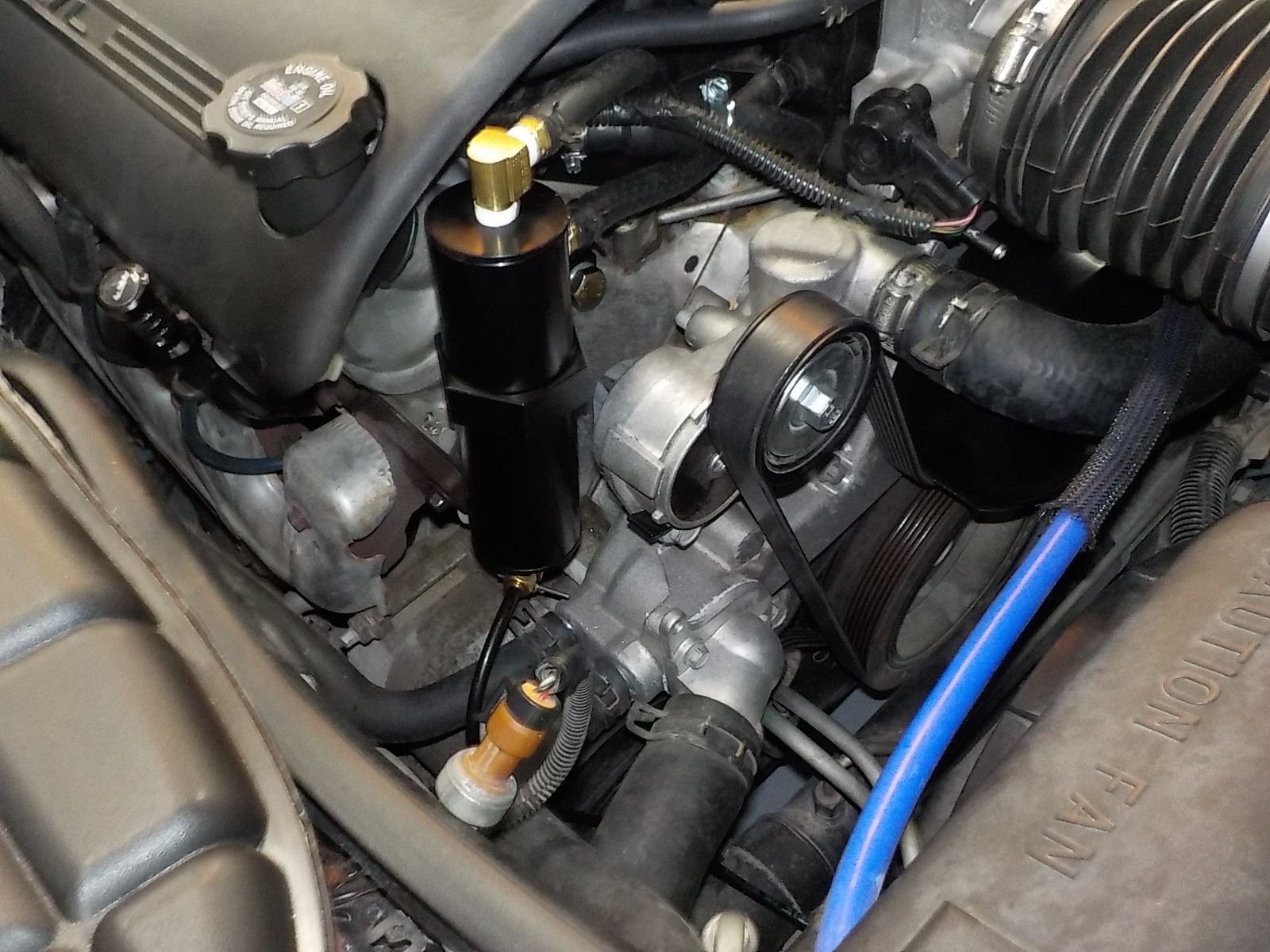

@smitty2919 My C5 Oil Consumption Fix:
I bought a stock 02 LS1 coupe w/auto w/60k miles in Feb 23. I don't hotrod it and I use it mainly for long distance hwy driving. Today it has 79k miles.
I quickly discovered it was burning 1 qt of oil every 2500 miles. I installed a Mike Norris Motorsport catch can and a fixed orifice pcv valve, GM# 12572717. The cc has not caught much oil.
I did a piston/combustion chamber soak with Gunk brand motor flush called Motor Medic. The longer the soak the better the results with this product.
Today oil consumption has decreased to 1/2 qt every 5k miles.
I'm now running HPL brand PCEO 5w30 to keep the oil rings, etc clean: HPL PCEO 5w30
