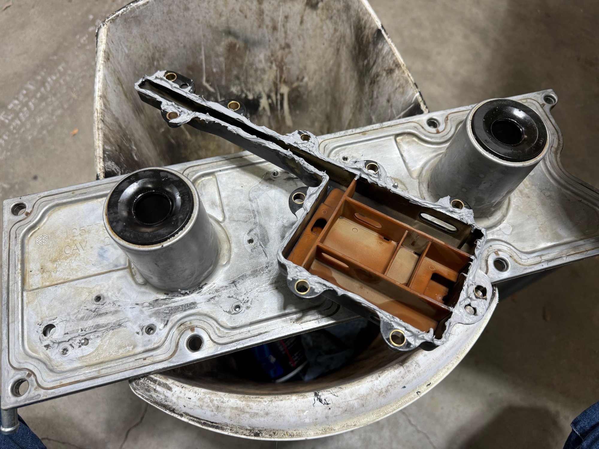

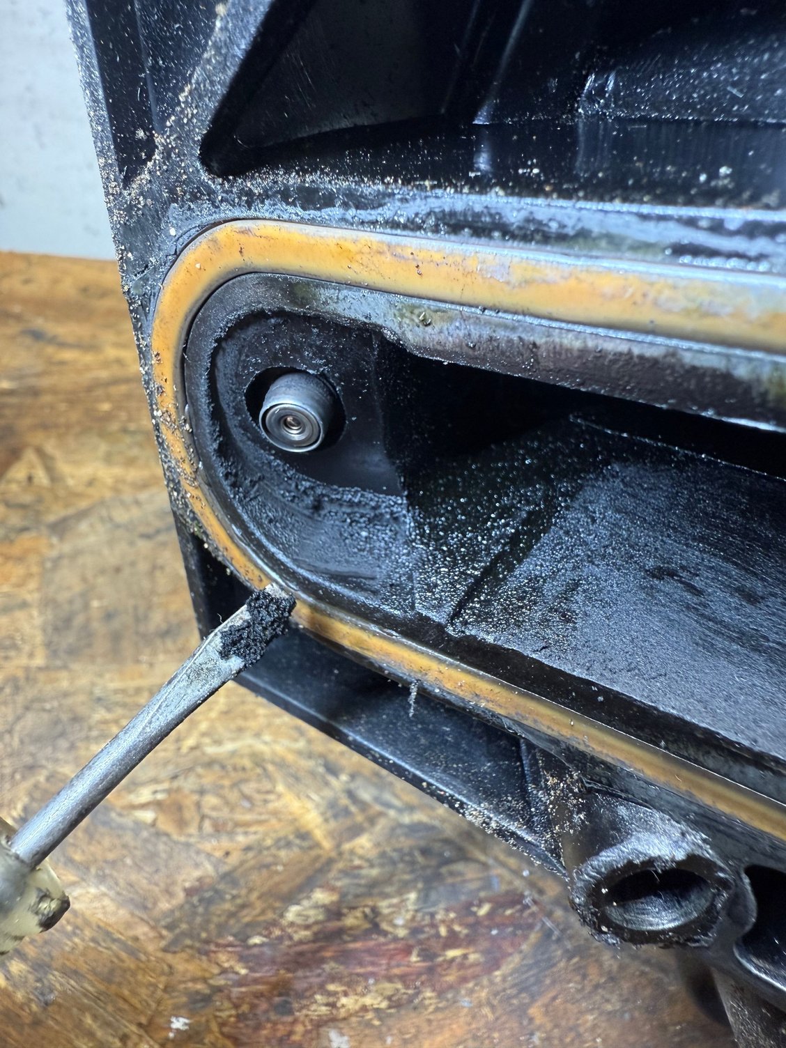

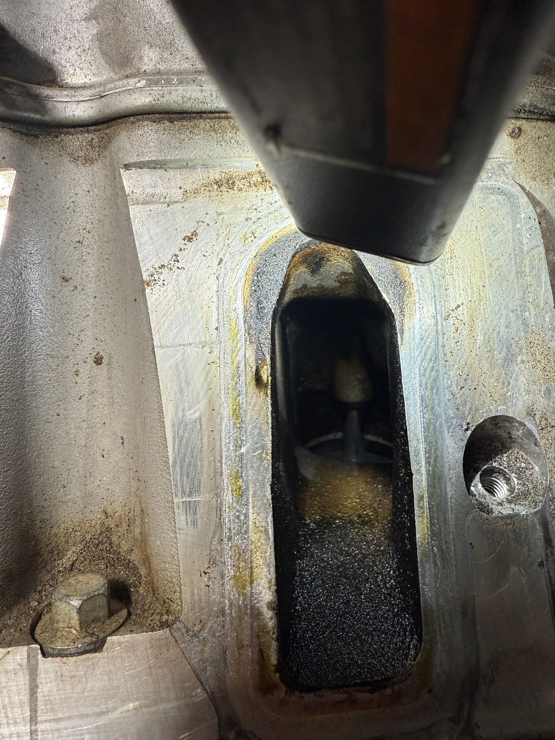

Well today I decided to do some digging. Took the valley cover out to put my eyes on things to cross them off the list. I initially looked in the intake while it was still installed and didn't notice anything glaring. However having it removed and able to really look at it...maybe a different opinion.
Just some runners showing crud on the walls.
Cylinder 7 was noticeably "wet"
Intake removed you can see the crud built up

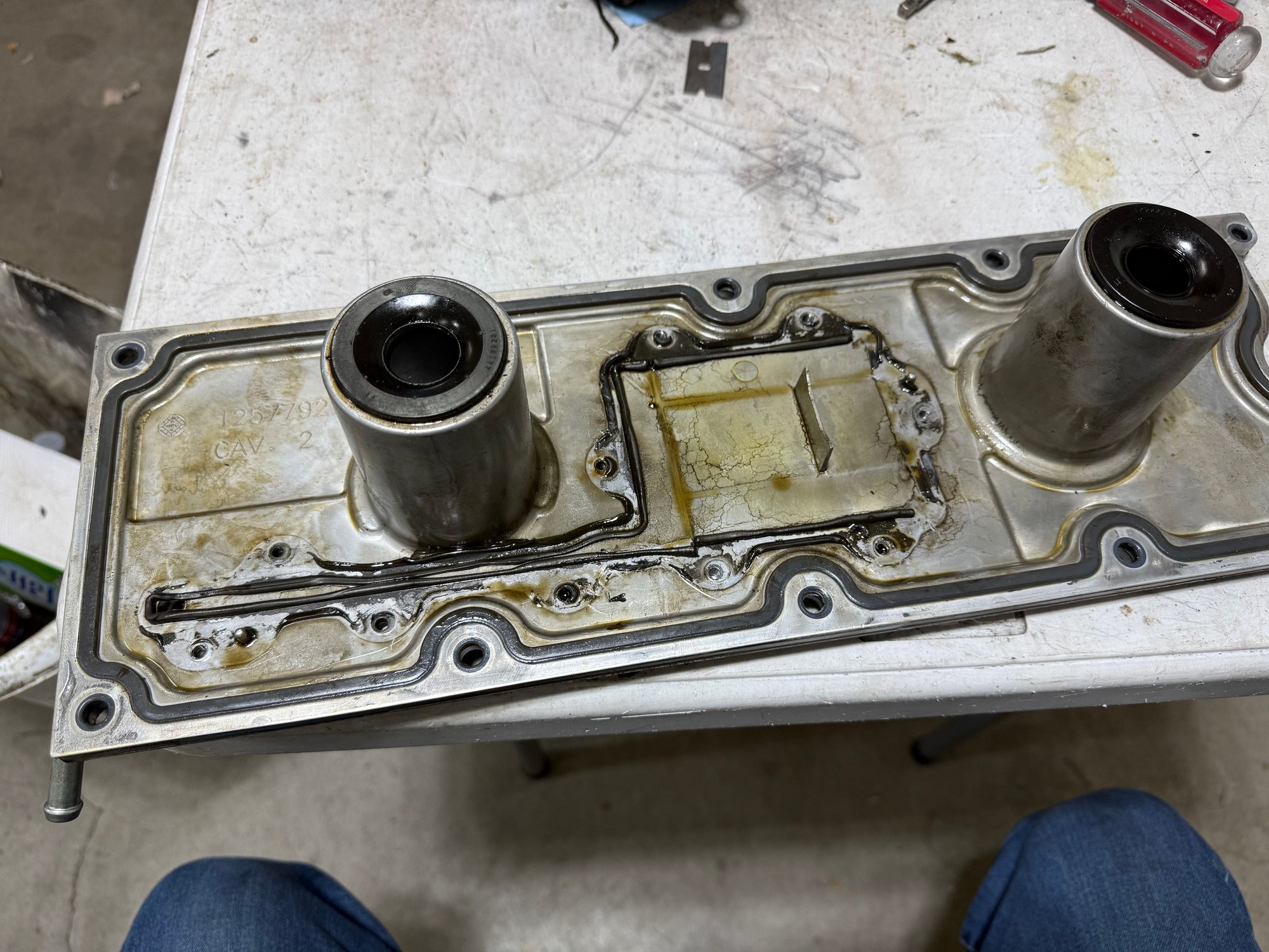

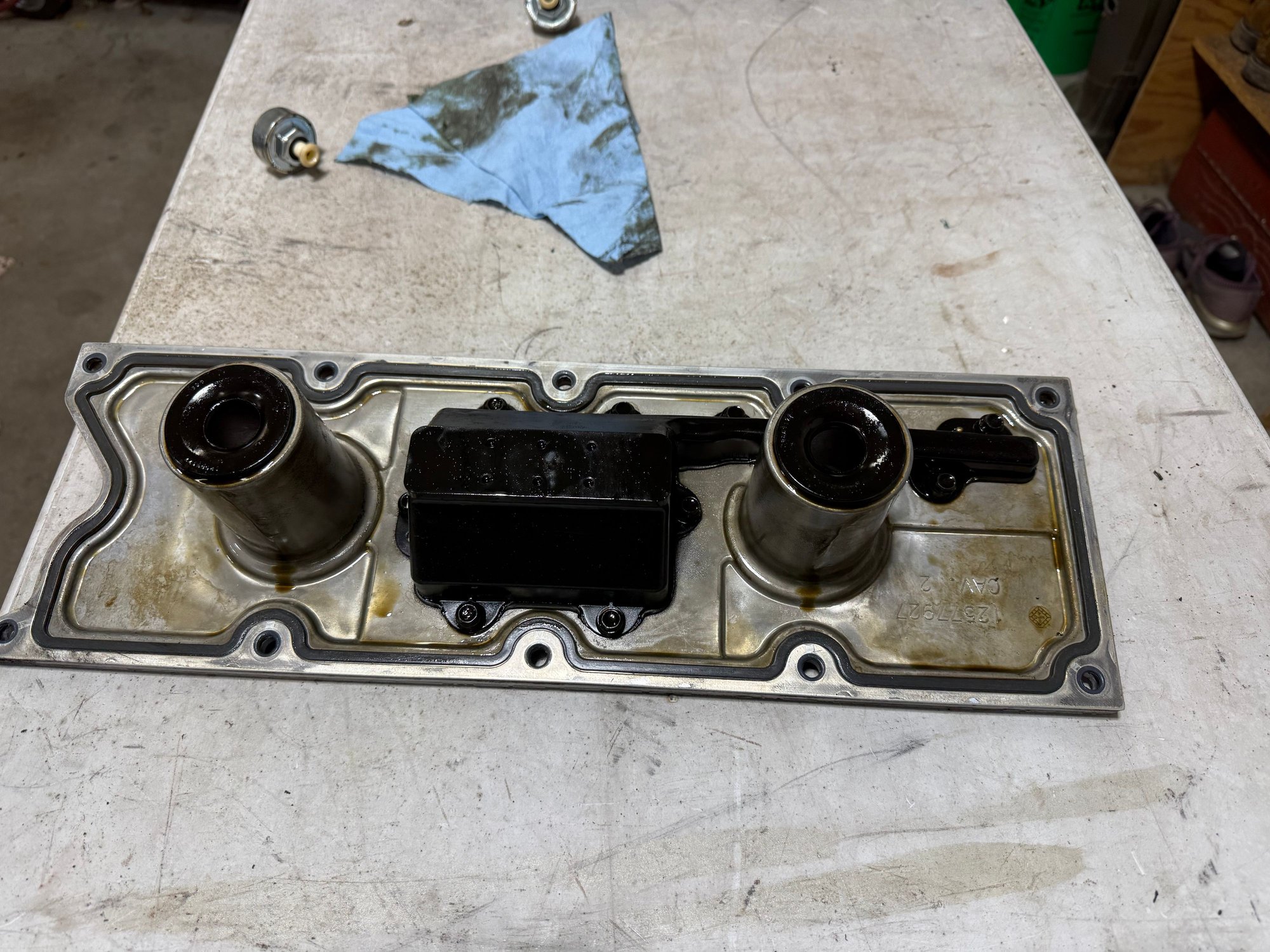

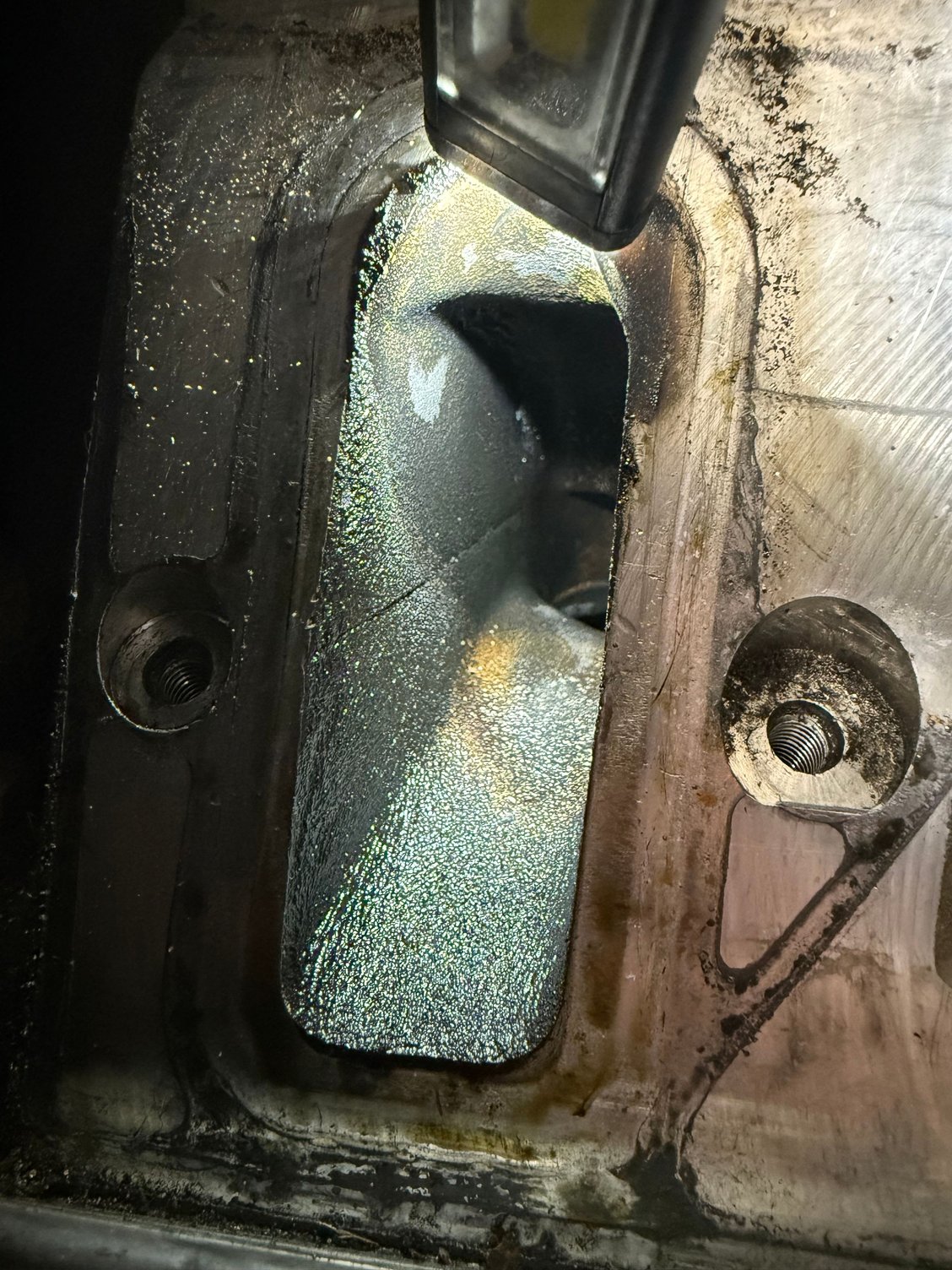

Moved onto removing the valley cover for inspection. Everything looked OK to me but decided to remove it and re-seal it while I was there. This is the new updated/latest valley cover PN 12577927

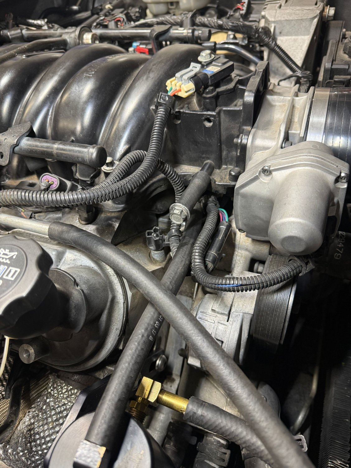

Talking to a friend of mine he suggested we do an experiment to isolate the PCV. I have had the Elite Engineering CC set up per their instructions since it was installed years ago.
Valley cover outlet to CC inlet
CC outlet to manifold behind the TB
Valve cover to air bridge couple before the TB
Now I have:
Valley cover outlet (which I verified has an internal restrictor orifice) to CC inlet
CC outlet ran to front of the radiator shroud (as to not dump onto motor/headers just in case)...vented to atmosphere
Manifold port plugged
Valve cover also ran to front of radiator shroud...vented to atmosphere
​​​​​​This cuts off any/all PCV related things to the intake and see if I still burn oil. It should 100% keep the intake clean. I have also zip tied a rag to the end of the CC outlet tube to catch anything so I don't make a complete mess.
If I still burn oil, it has to be rings. We shall see.

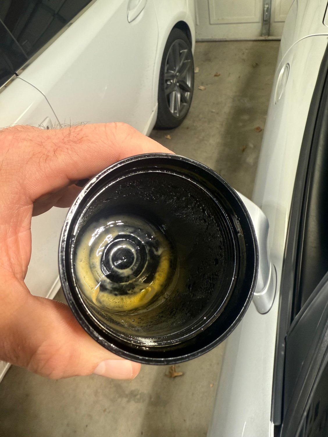

170mi decided to look at the CC. A lot of water and more than I expected. I usually see a dark mostly oil mix but this was very clear.
Still chugging along

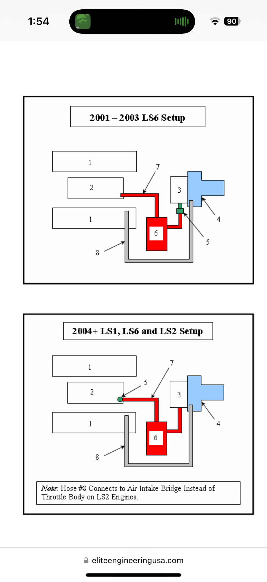

I would say the water you see is condensation from the engine on start up collected in the catch can. Common when ambient temperatures drop. I would also guess that because you vented the catch can to the atmosphere, there is no vacuum to remove water vapor from the catch can. Maybe go back to the OEM closed PCV system and add a clean side oil separator to the passenger valve cover from Elite Engineering to control the smaller amount of vaporized oil into the intake or add a second catch can on the clean side.
https://www.eliteengineeringusa.com/...oil-separator/
What thermostat are you operating with? Engine temp must be above 200 F to evaporate condensation. A 180 F thermostat may not be best for a daily driver in cooler weather if you are only doing short drive times.

Good points. I have a short drive to work and temps have dropped here in NKY. I replaced the rag at the end of the CC outlet tube (which would have ran to the intake) with a clean one to see if ANYTHING is coming out. I had planned to go back to the OEM routing after this experiment. With this new configuration, three things have changed.
-Resealed and cleaned PCV baffle under valley cover.
-Removed the inline PCV valve (which was on the car when I bought it but based on the stock configuration should never have been there since the valley cover nipple has the integrated orifice. Car was fine even with this installed so either the inline PCV went bad, or cleaning/sealing the PCV baffle on valley cover helped)
-Vented things to atmosphere (so there is NO way anything is getting into the manifold and head ports)
As of now 200mi and no visible oil consumption based on looking at the dipstick.
