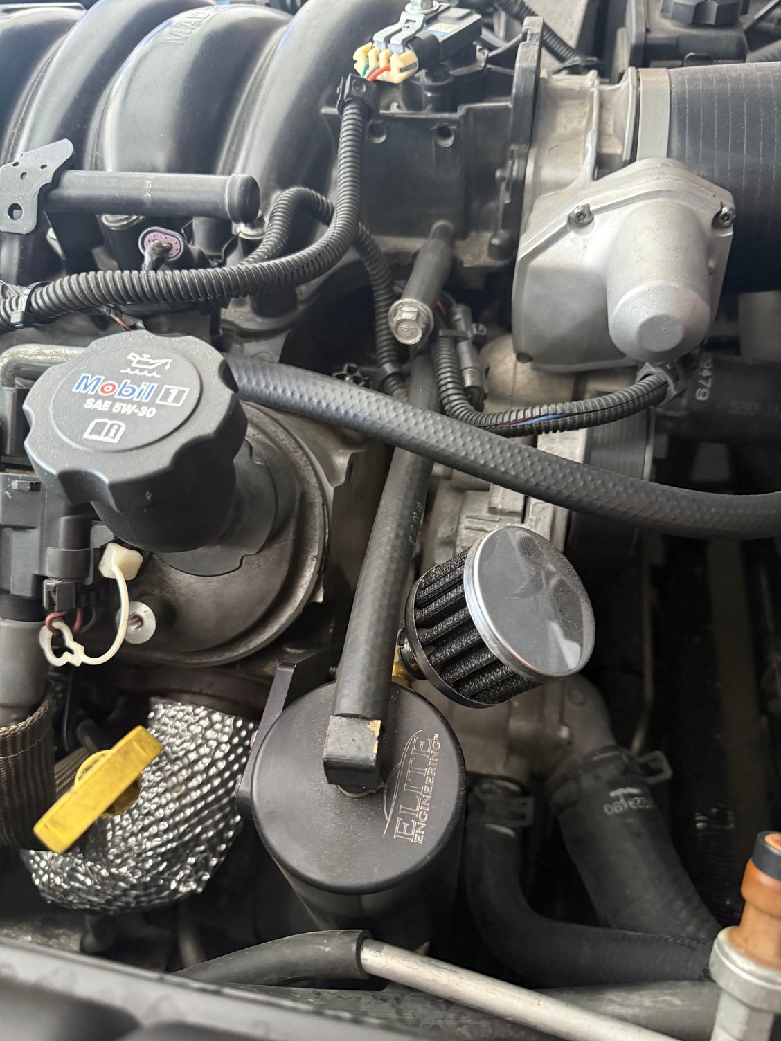

Latest change was I reconnected the PS valve cover to the air bridge. I have left the CC outlet vented with the rag at the end.
Still collecting what seems to be mostly condensation/water. However the CC outlet hose seems to be soaking up twice as much "junk" collecting in the rag. Nothing serious to drip off but thedirty area on the rag is twice as large as before.
150 mi on this latest test. So far oil still seems to remain full. End goal will be to get back to the original routing where the CC outlet is connected back to the intake manifold.
The more I think, I'm still lost on how THAT much oil got into the intake and the CC didn't catch it.

Snow melted and have got another 150mi on since the oil change.
I also updated the CC outlet to have a breather right off the can vs running a tube to the front with a rag zip tied. I didn’t want to deal with a mess putting a breather at the end of the hose.
Checked oil and it’s still at the top dot. No consumption visible and also noticeable less black soot on the tips. 👍
