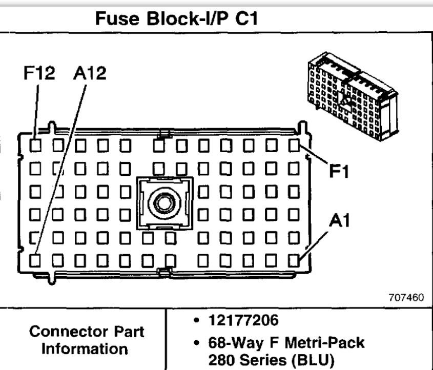

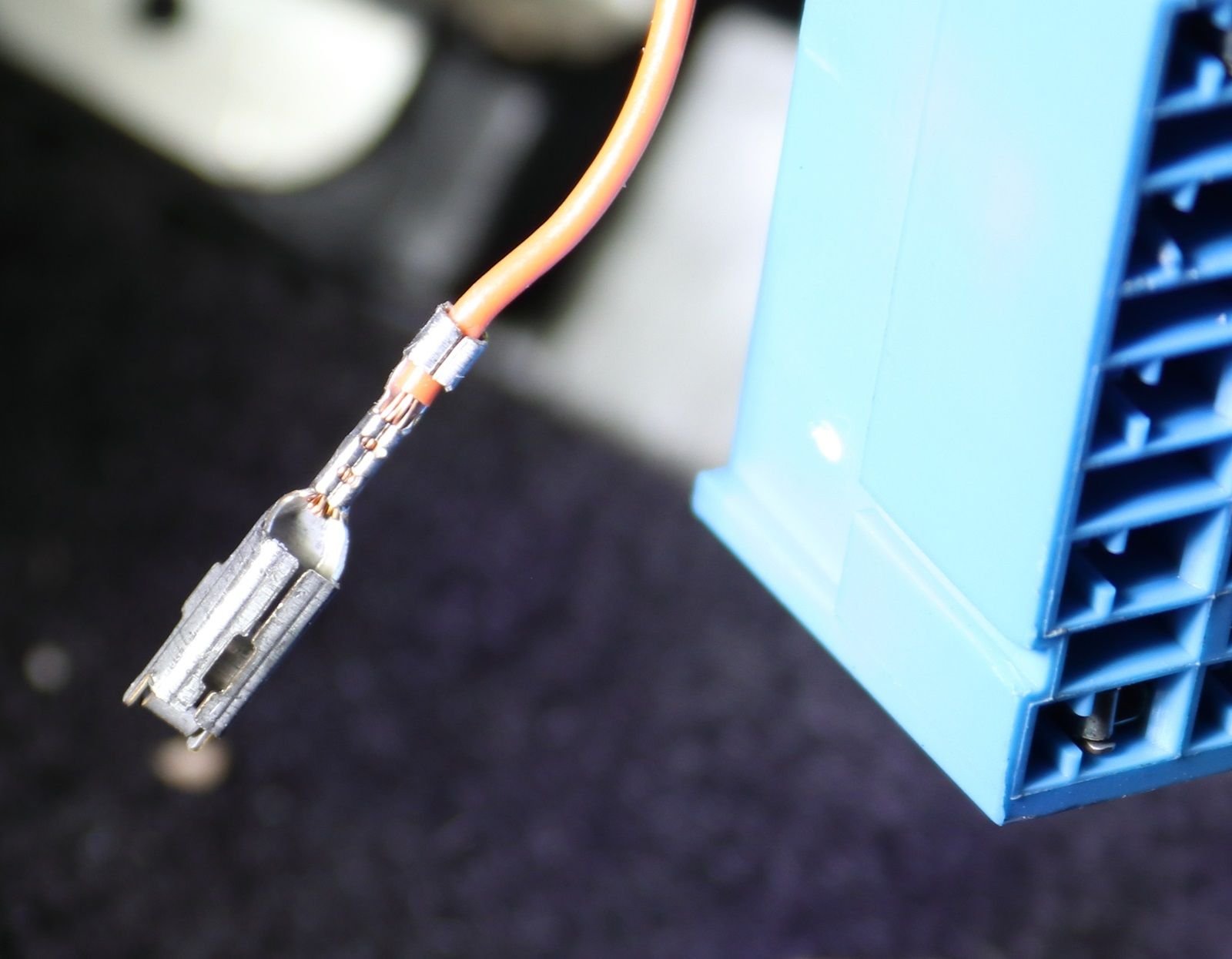

This terminal is attached to the interior fuse box in my 2004 Corvette. I want to add a circuit using an unused fuse. I am having trouble finding a terminal that is similar to this.
It is 3.5mm wide and 20.5mm long.

What is this additional circuit for? There are already existing provisions just above the BCM. Three taped/stowed wires with their own plug ready to go. Black - ground, Yellow - hot in on, and Orange - hot at all times.
They are not there in my car. The fuse 11 is there but not the wire on the fuse box. C1 row B pin 3 does not exist.

Originally Posted by C5 Diag
I have spent hours searching with that info, but I cannot find the female terminal ends that are the right width, 3.45mm.

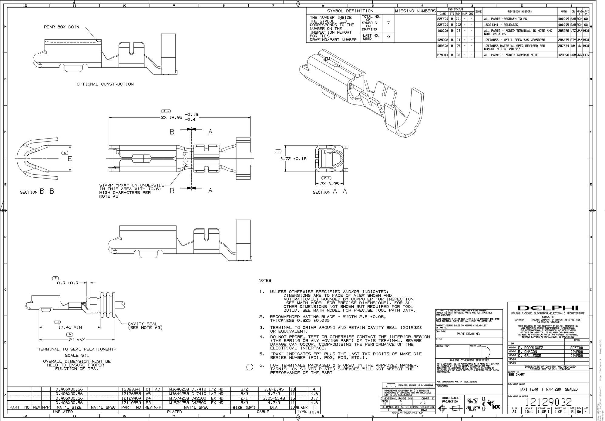

Download the datasheet for this alternate part number. Looks very close.
https://www.mouser.com/ProductDetail...RGRi6u6vhhQmcH

I appreciate the help, those have locking lances where a window should be for the housing locking tab. I actually called Mouser and spent an hour or so with them and they said they had nothing for me. I ordered a salvaged connector off ebay and pulled a pin from that, hopefully that will work. But I really would like to know what the right part is for these.

It looks like Arrow Electronics has them, but the MOQ is 2300 pcs !

Ok I found it. The p/n I was looking for accomodates a 12-14AWG, which is seemingly unavailable. I was able to find the same contact that accomodates a 10-12 AWG. That part number is: Aptiv 12110853. ....wide availability....even Amazon.
