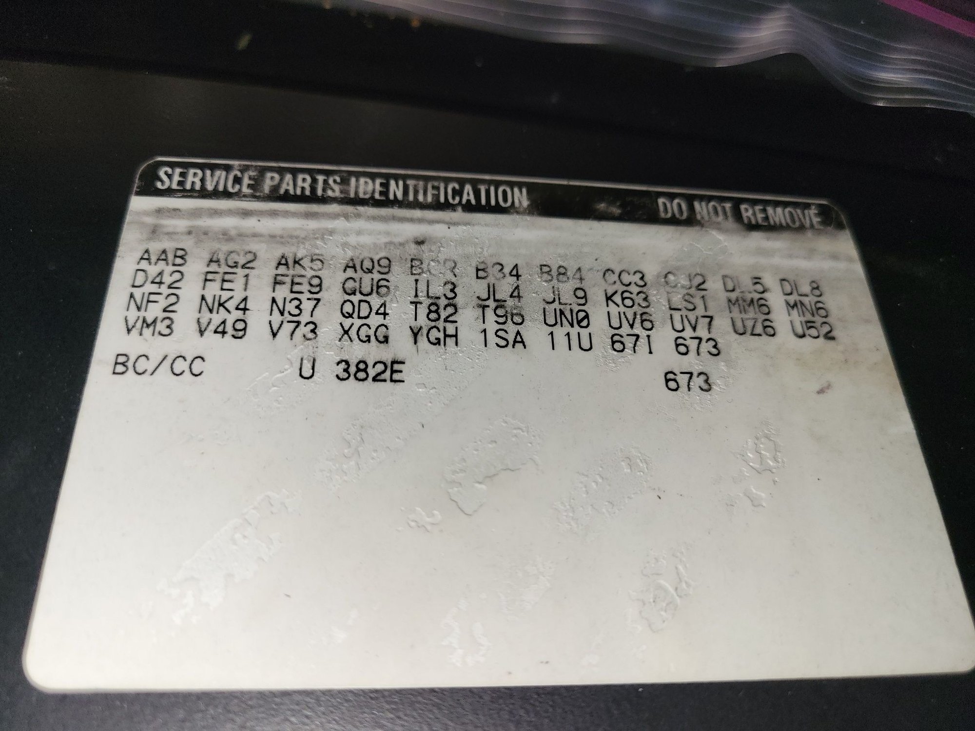

I bought the car in 2009 and am uncertain as to what it came with. Not all codes in the glovebox are legible. (See photo below). I can read a JL9. According to two different Chevy dealers that have run the last 8 of my VIN my car is supposed to have a yaw sensor.

If that is your original glove box door......, you do not have AH. If you had the JL4 option, it would listed right before JL9 .
If you had a yaw rate sensor, there would be a dark blue wire in position 21 of the EBTCM as well
