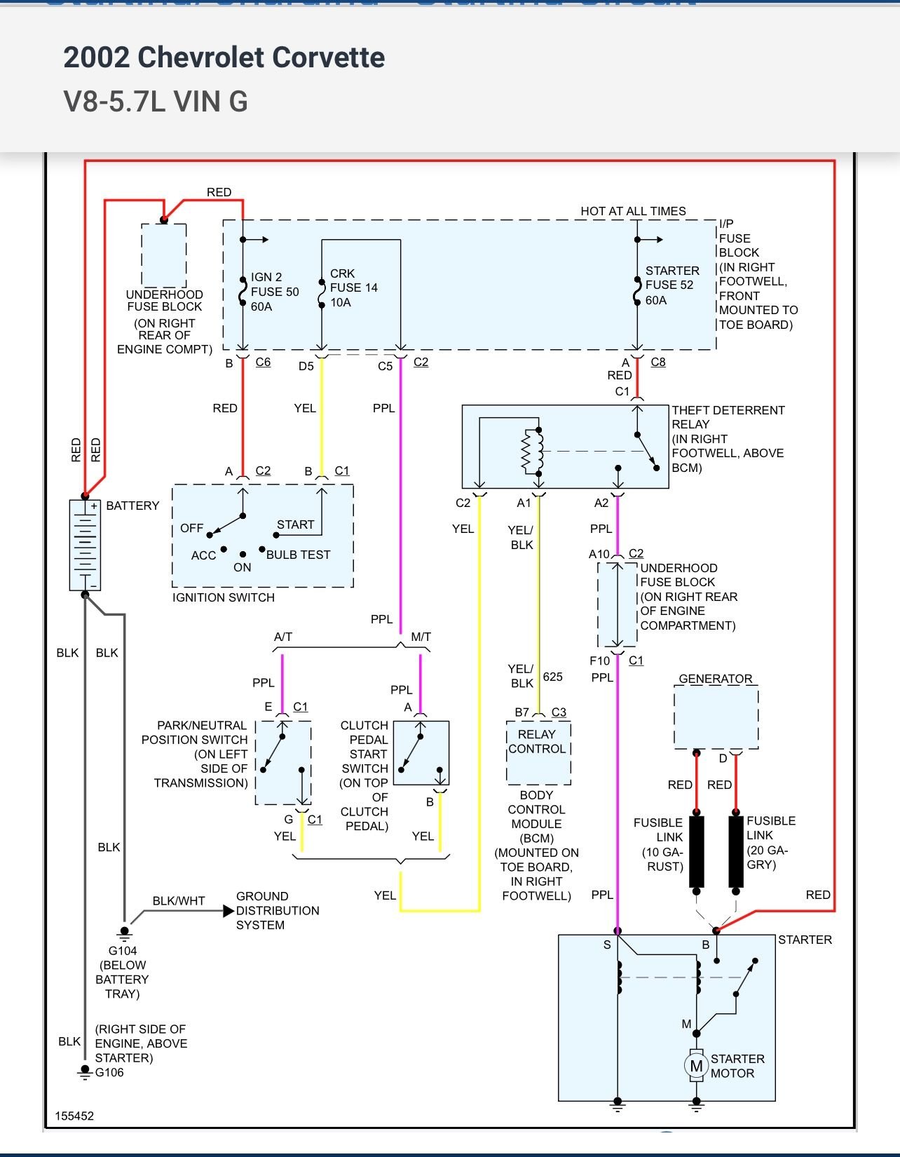

Good start simple then...pull and post your codes:
https://www.corvetteforum.com/forums...dic-codes.html

Ok, so now you know where you're at. Time to get out the DVOM and follow the schematic provided by C5diag.

When I had my C5 I used an AC Delco Professional battery exclusively…being that your car came with a flooded lead acid battery you use that…NOT an AGM…the charging rates are different between AGM and FLA are different…you want a battery with the most RC (Reserve Capacity) that you can get and since it looks like you are in NC CCA is not important…you give up CCA for RC !!…for ANY starting issue you ALWAYS start with the battery…now this MAY be high resistance across the ignition switch contacts and having a DVOM can check for this.
