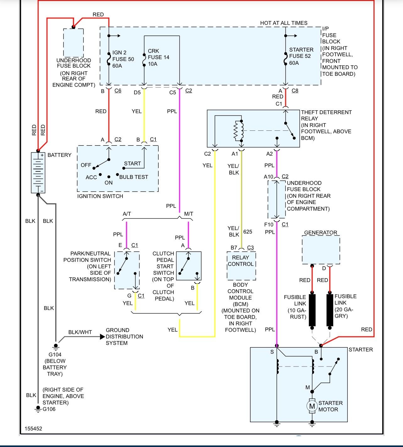

Just because your battery is fresh and good with normal voltage doesn’t mean it’s good…do you have any basic electrical knowledge and have a DVOM and test light and know how to interpret a wiring diagram ???…is this something you’re going to try and diagnose yourself ???…moving this to Tech.

Most likely your starter solenoid is the cause of your no cranking problems. The one definitive test is to measure for 12v on the violet wire at the starter solenoid or the violet wire at the TDR socket which is the same wire and easier to get to. If you have 12v every time the key is turned to start the car, the problem is the starter solenoid. A little bit of voltage measurements can help anyone to just replace the bad part instead of shot gunning.
