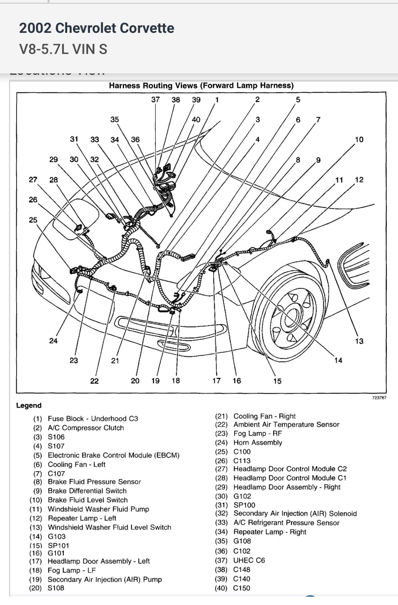

Do you have a picture of this cover and what is it made of ???…I would just inspect any wiring harnesses near this cover…you can trace the EBCM wiring harnesses and see if it’s anywhere near this cover.
This. Examine ALL contact points where the engine cover meets a wiring harness, etc.
