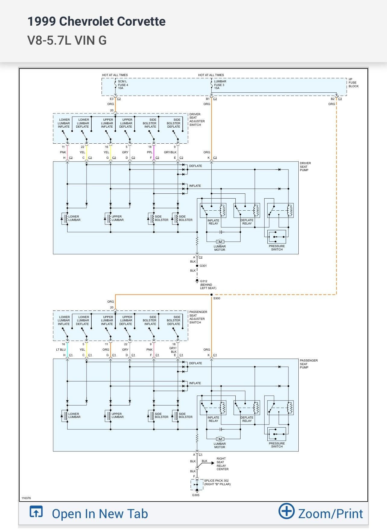

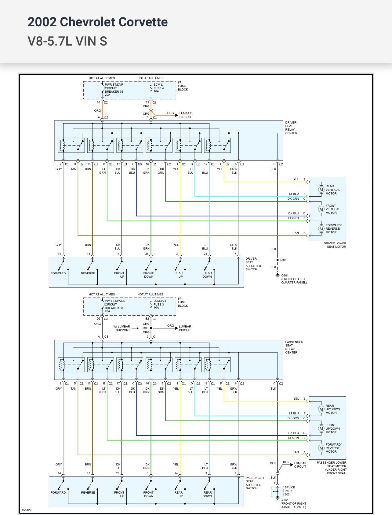

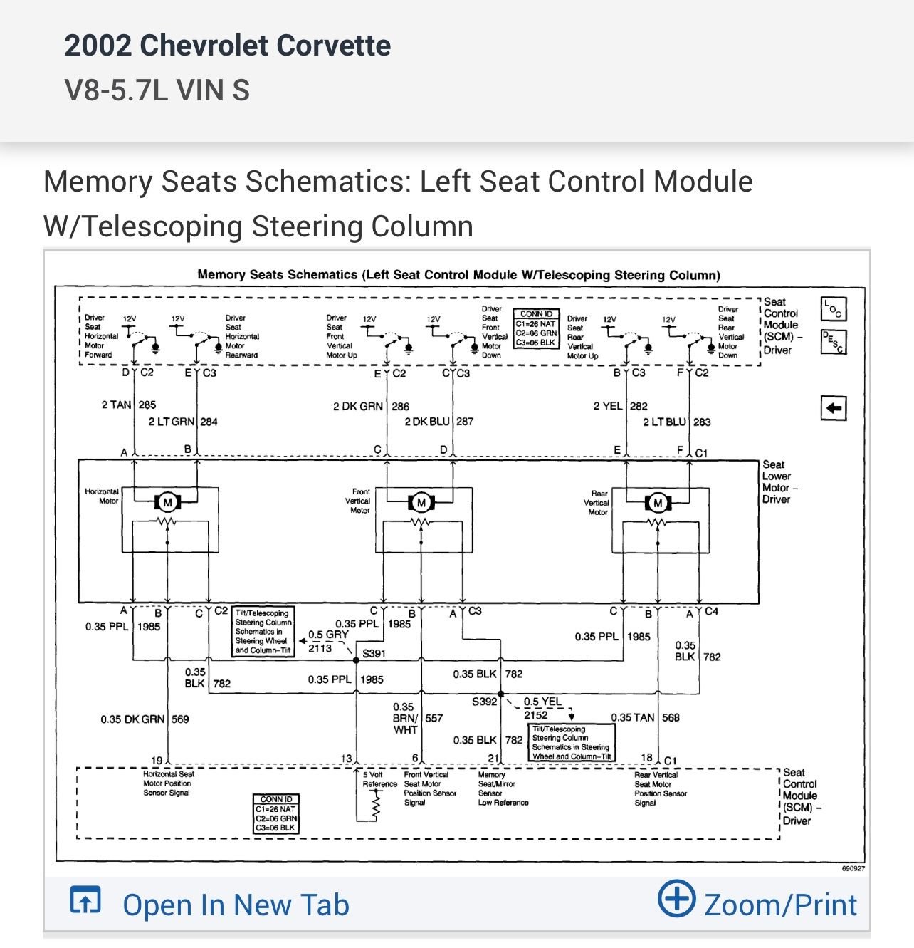

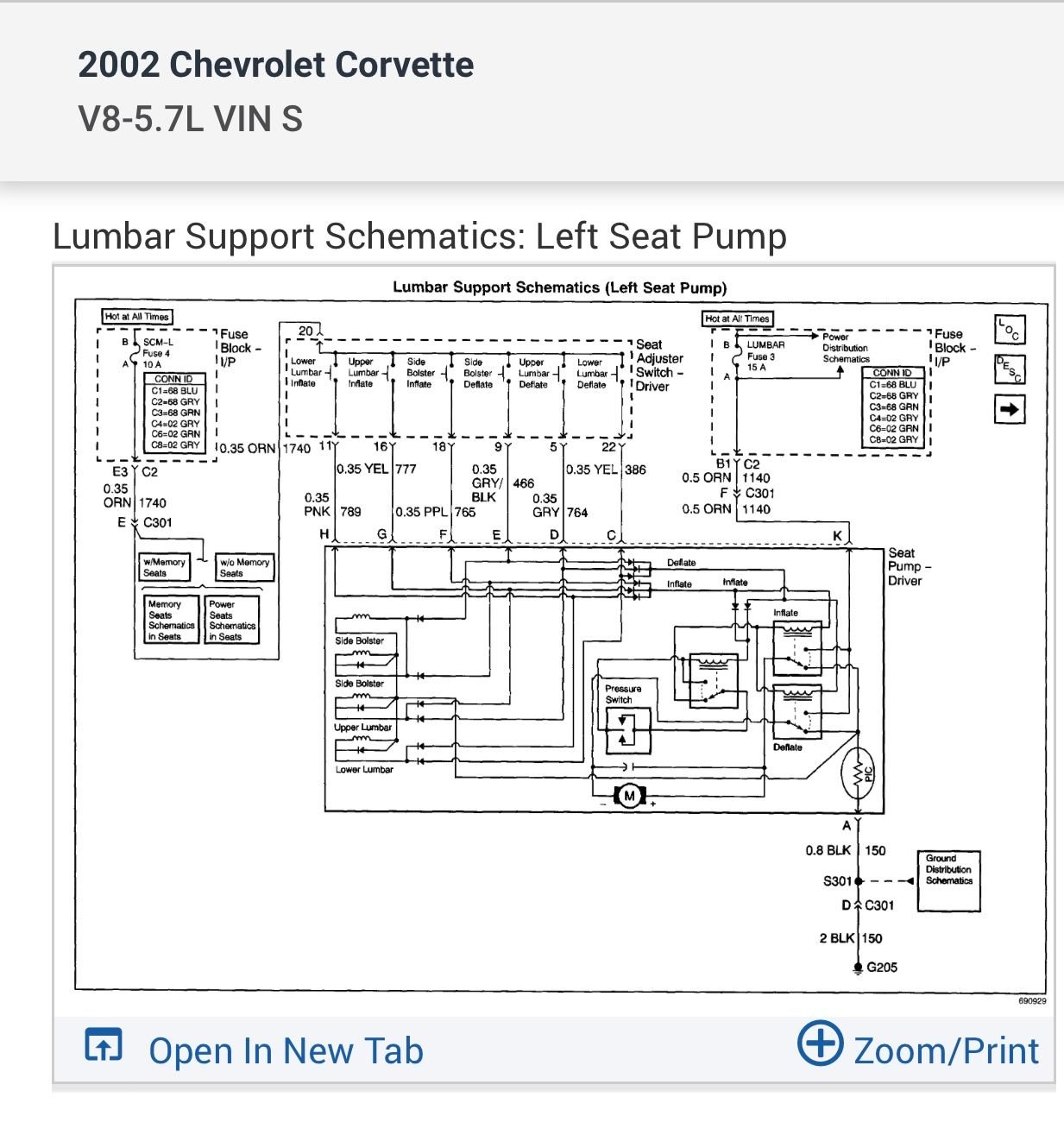

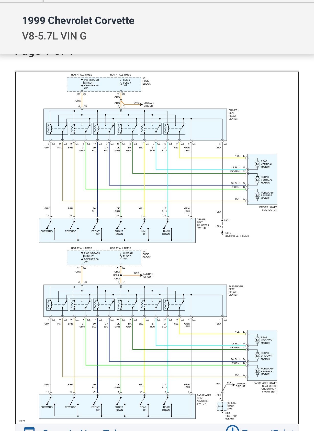

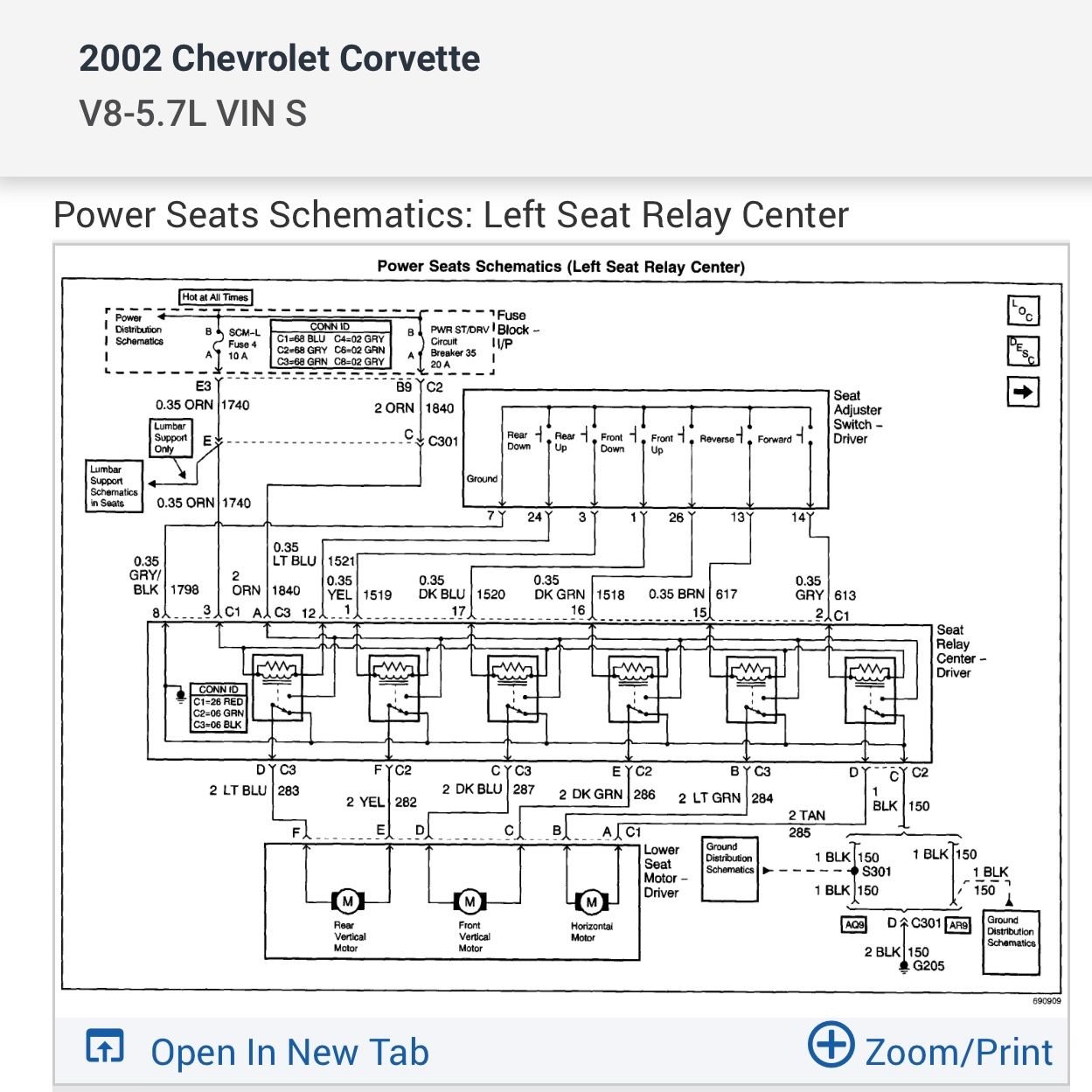

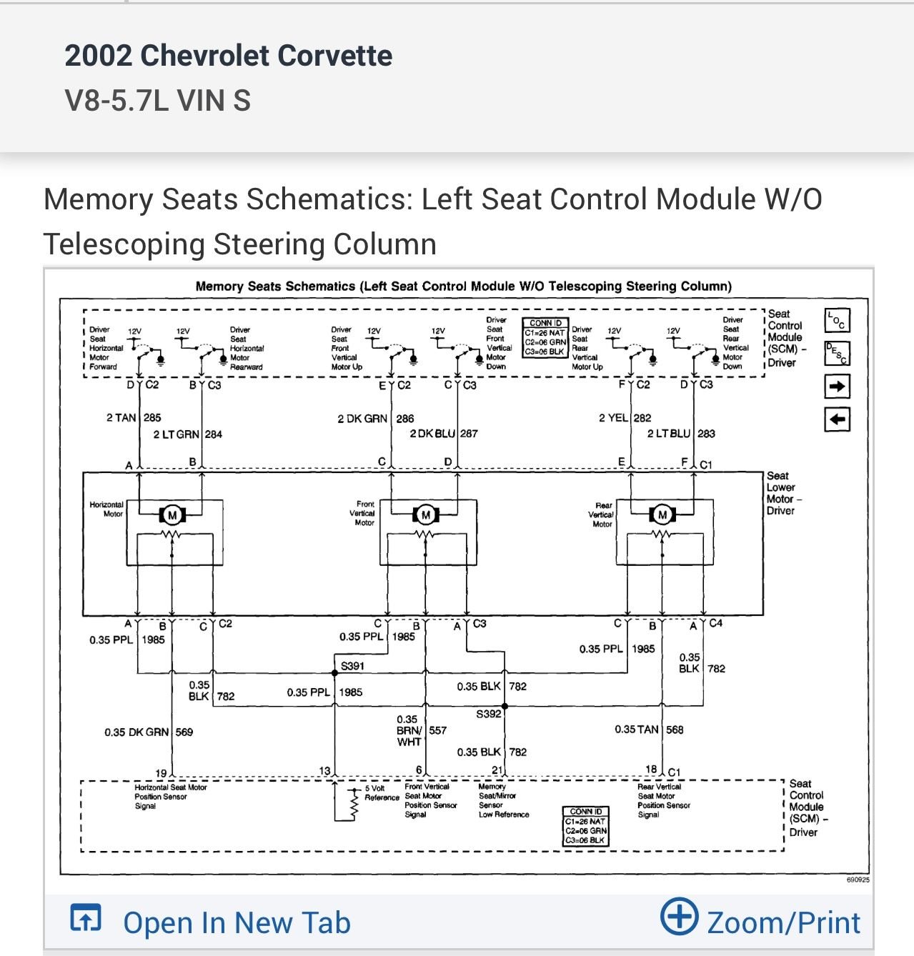

I upgraded my base seats in my ‘02 to oem performance seats. Now,drivers seat switches do not correlate to their function. Up is back, tilt is down etc. I was told the seats came out of a ‘99. Also told the modules might be year specific it has a different module number but I thought it is because they are lumbar. All of the seats I see for sale are not year specific but I do not see anyone having these issues. I wired the passenger seat with the correct connector and it works fine. Any input or help in this matter would be greatly appreciated. Thanks !!!

Awesome info ! Thanks !! The passenger seat works fine. These diagrams should be the same for the drivers seat seat too ?

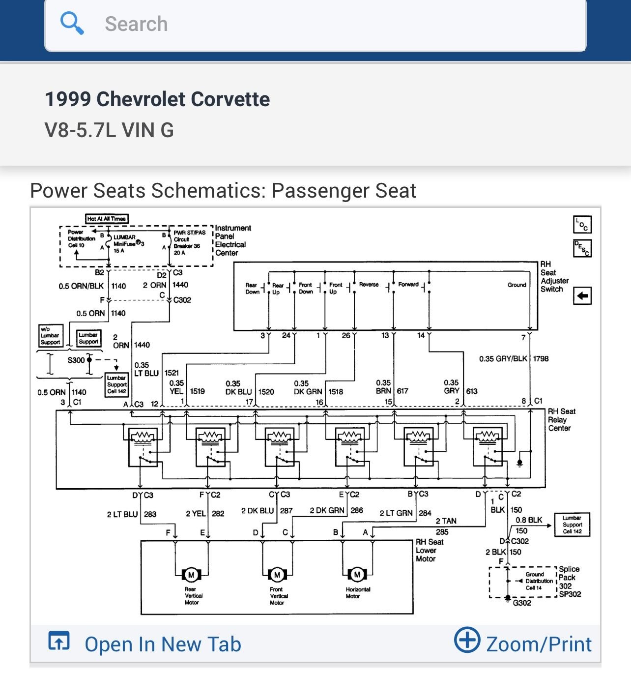

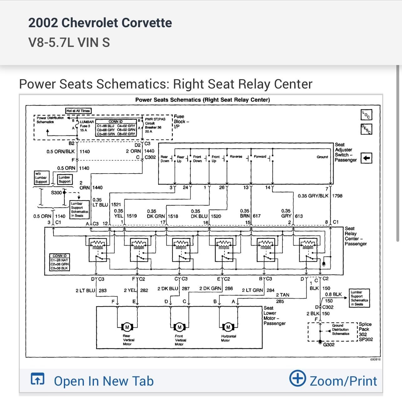

Your passenger seat is powered ??…non OEM only shows driver which I posted…I’ll check OEM.

I wired the passenger seat and it works fine.
