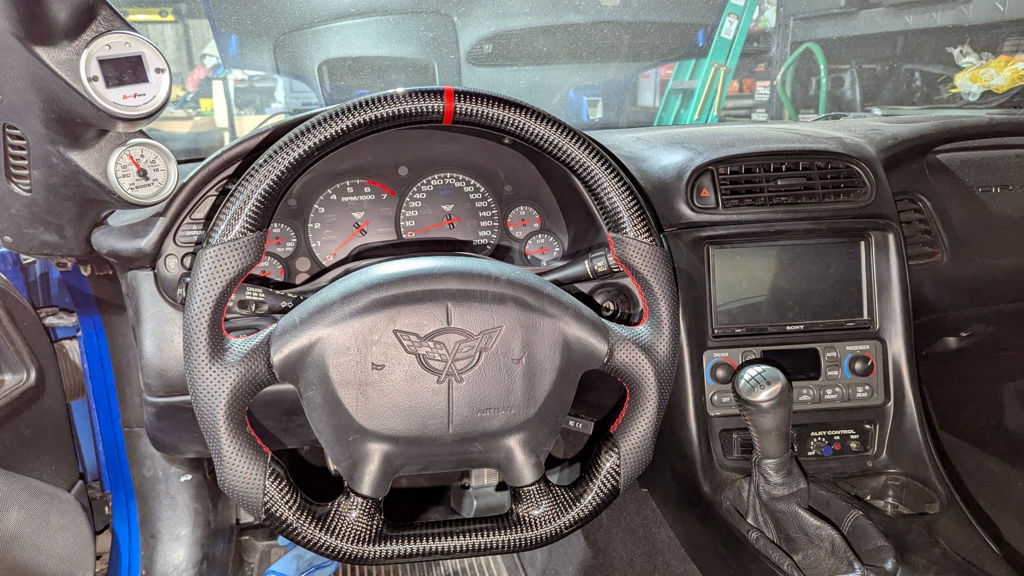

I just pulled mine today. I went and bought the J hook steering wheel puller. It was about $20 at O'Reilly's. Had to shave a little off of it to get it so go through the slots. Put it on, and proceed to tighten it. One of the j hooks broke. Then I decided to put a socket on the nut and give it a few good snacks. After that I had had enough and started pulling on it like a gorilla. First did the top, then bottom, right and once I started pulling on the left side it just came loose. I have removed a fair amount of steering wheels and never used a puller, but with all the horror stories I decided to try that route first, but it didn't work on mine. I will say that I have never had to pull so hard on a wheel so hard.
I installed a carbon wheel from Overtake. I didn't really didn't want a red stripe or stitching, but I couldn't pass it up for the price. It was on sale for $270. Pretty nice for that little bit of money.
