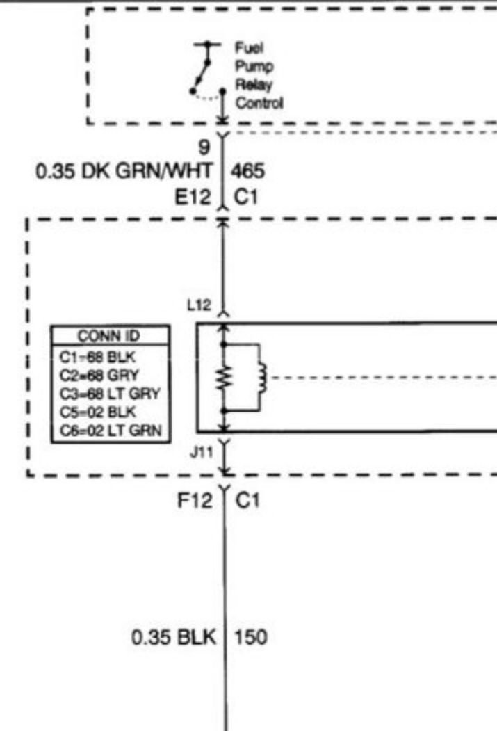

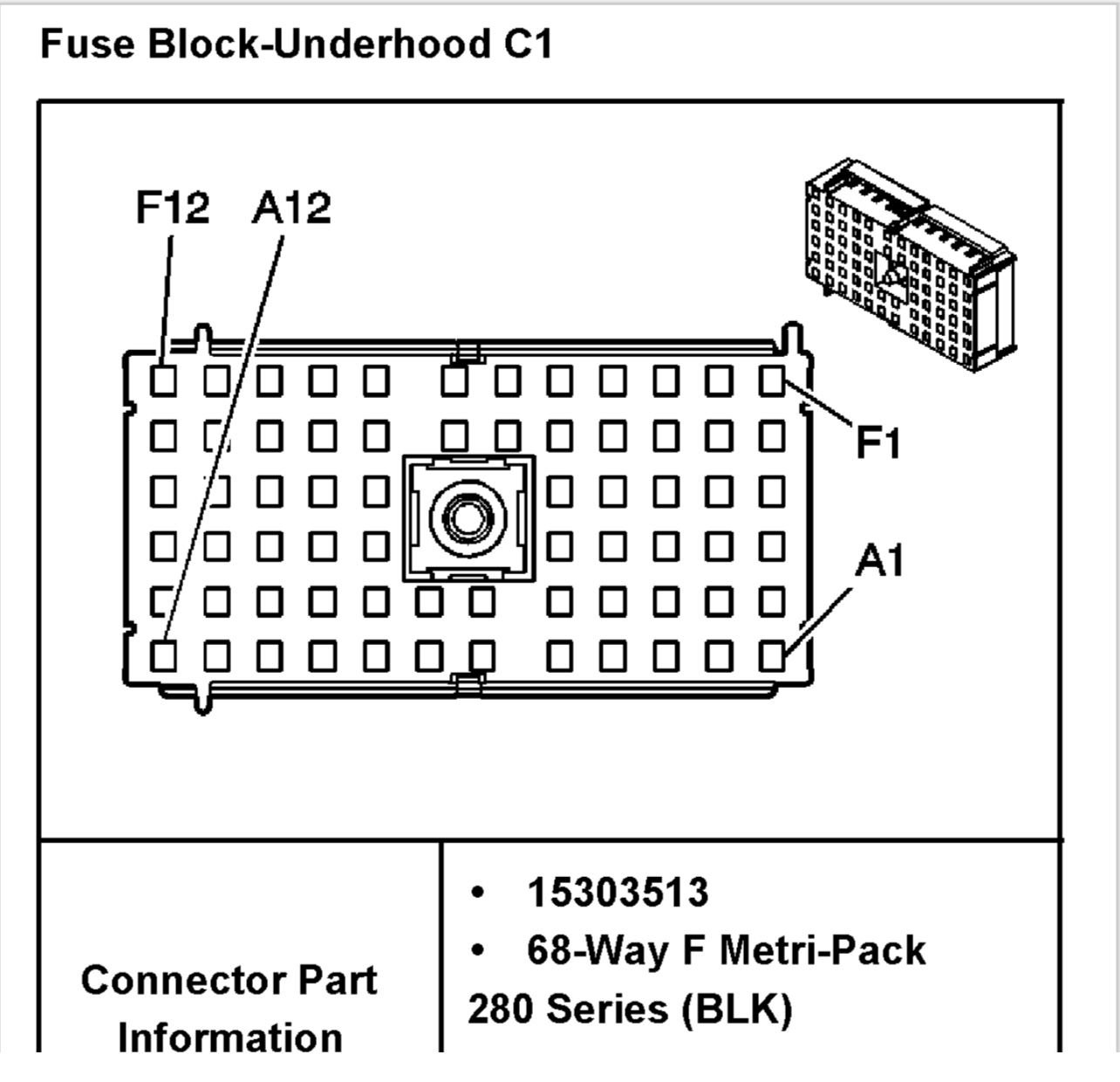

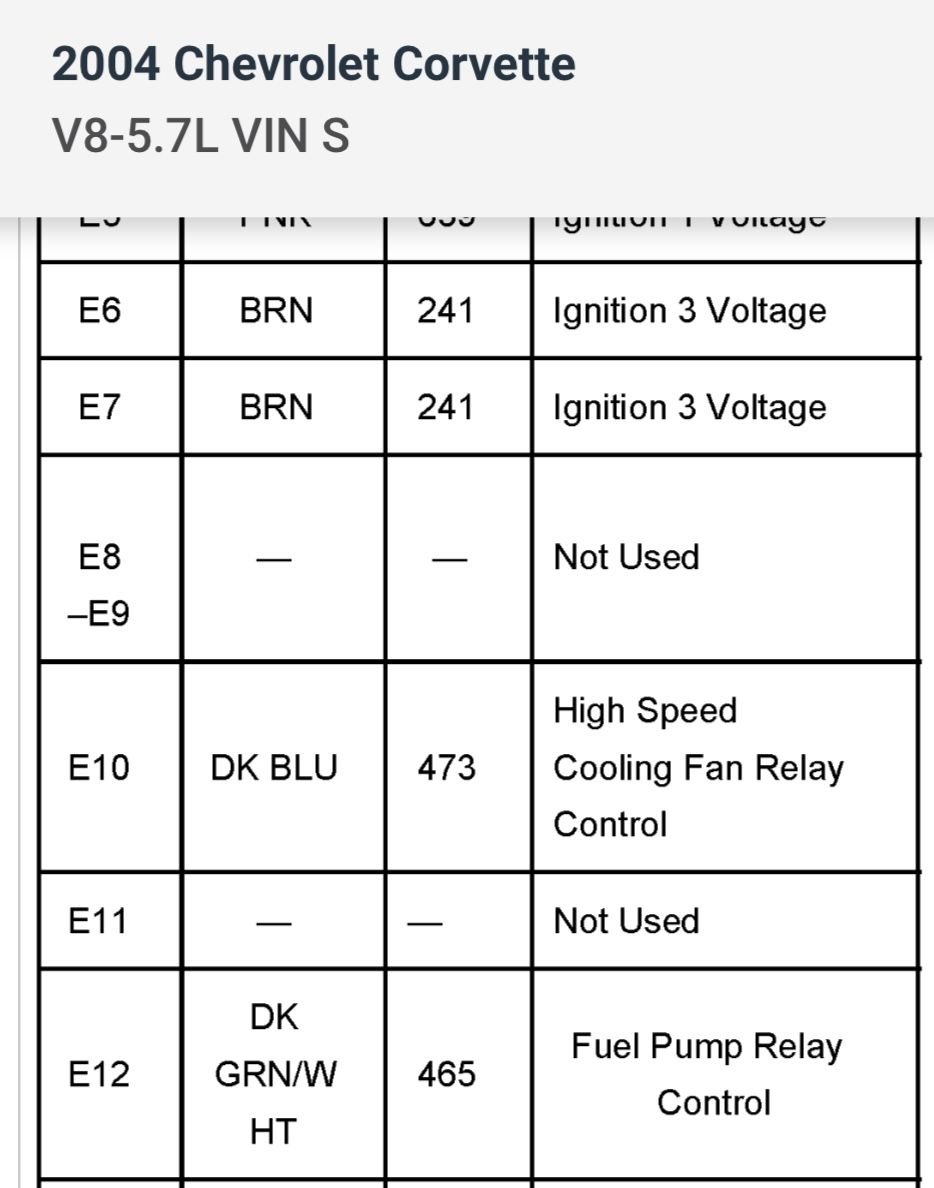

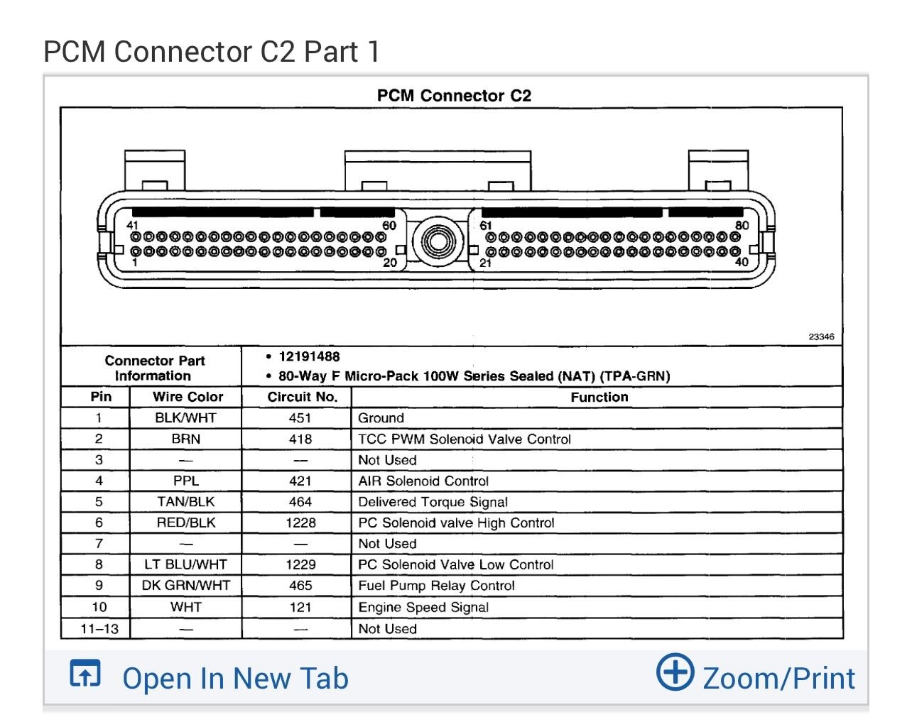

C2 connector is the PCM connector and the TPA (shown below) is green…don’t remember which one C2 is…pin 9 is a dark green/white stripe wire…at fusebox the connector is C1 and pin is E12 (fuel pump relay control)…check for corrosion and pin fitment !!…BTW no relay control…other 3 terminals were good…OP will be checking circuit between PCM and fusebox…hopefully bad connection at PCM or a broken wire somewhere between PCM and fusebox.

Sounds like a plan…I’d get to the PCM and back probe the relay control wire and see if the test light illuminates with key on…if no light most likely bad PCM driver…if it lights then we have to check from PCM to fusebox…video so you can see how bad these PCM’s can get.
