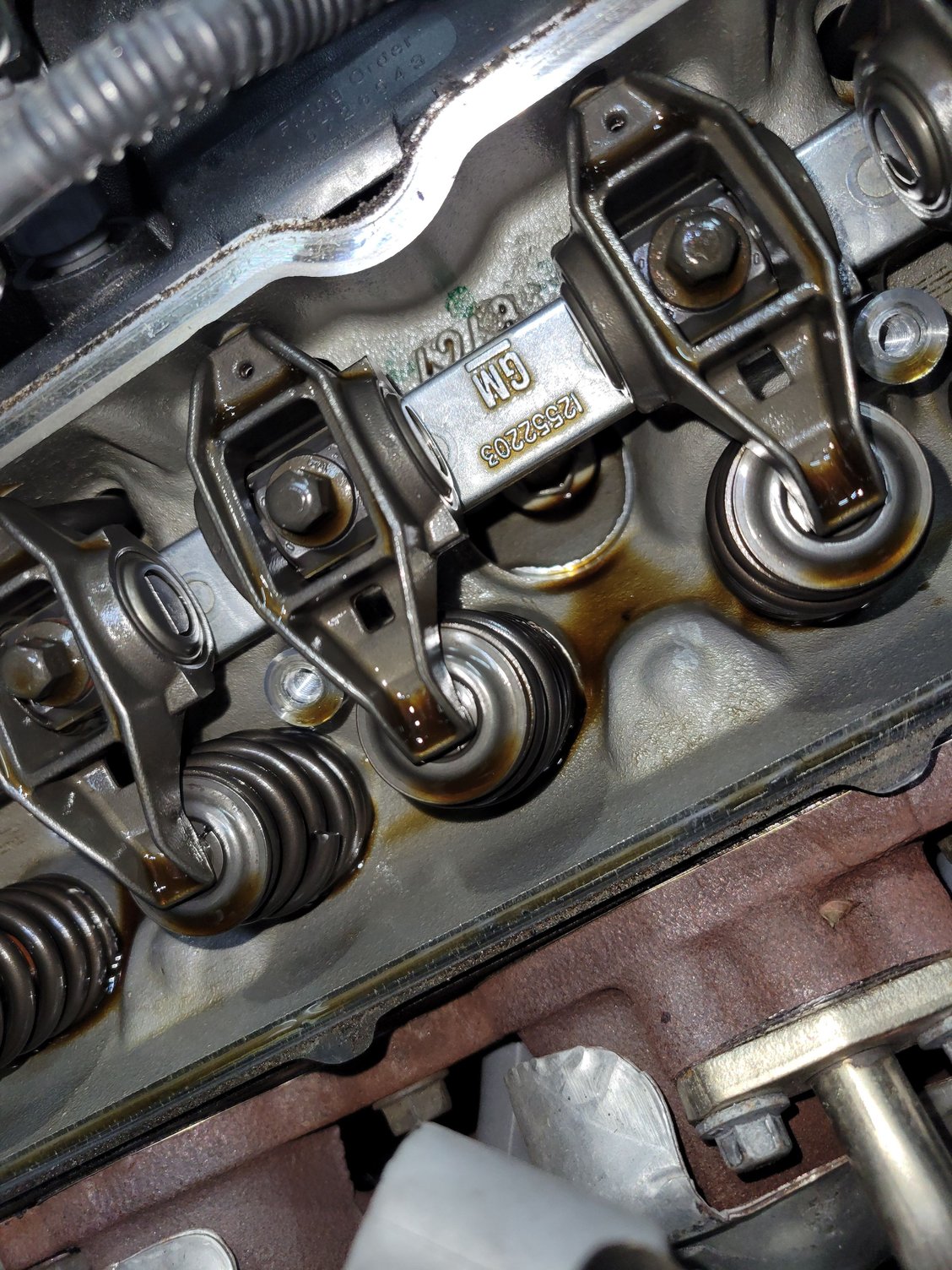

When the engine stumbled and died the sound of the fuel pump chnaged, so i assumed it was fuel related. Actually, it wasn't.
Just found this this morning on cylinder 3. So, hopefully it didn't do any other damage and it will be a pretty straightforward fix.
Any recommendations and good valve springs/retainers for a stock C5Z that I plan to keep stock? What tools are good to have when changing out valve springs on an LS? I haven't done it before.
Same for intake and exhaust right?
Yes
How do I hold valve when swapping spring?
Piston to TDC, some use a length of rope in the cylinder or
the compressed air method works well if you have a compressor that can handle it.
Do i need to adjust/check lash after?
If this pic you posted is your engine, you have stock rockers, so there is no adjustment. The service manual procedure is good for valve spring/seals replacement. Most important thing is having the piston at TDC for the cylinder you are working on, and making sure to never torque down the rockers on an open valve.

Old Jan 4, 2025 | 12:16 PM
  #53
Sojourner's Avatar
Sojourner
Joined: Aug 2022
Posts: 91
Likes: 40
Thank you all for your help. I got the valve springs replaced, and the car runs like a top again! Issue has been solved!
