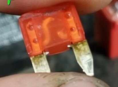

If you check ANY fuses:
- Always remove and inspect the fuse. Look for corrosion, blackened fuse spades, loose fuse sockets in the fuse box and physically deformed or discolored fuse internals.
- There are two small metal terminals on top of each fuse. Use a multimeter to read each fuse test terminals to chassis ground. If the circuit is properly powered each test terminal will/should have FULL battery voltage to ground. If you have lower than actual battery voltage, there is a voltage drop somewhere.
