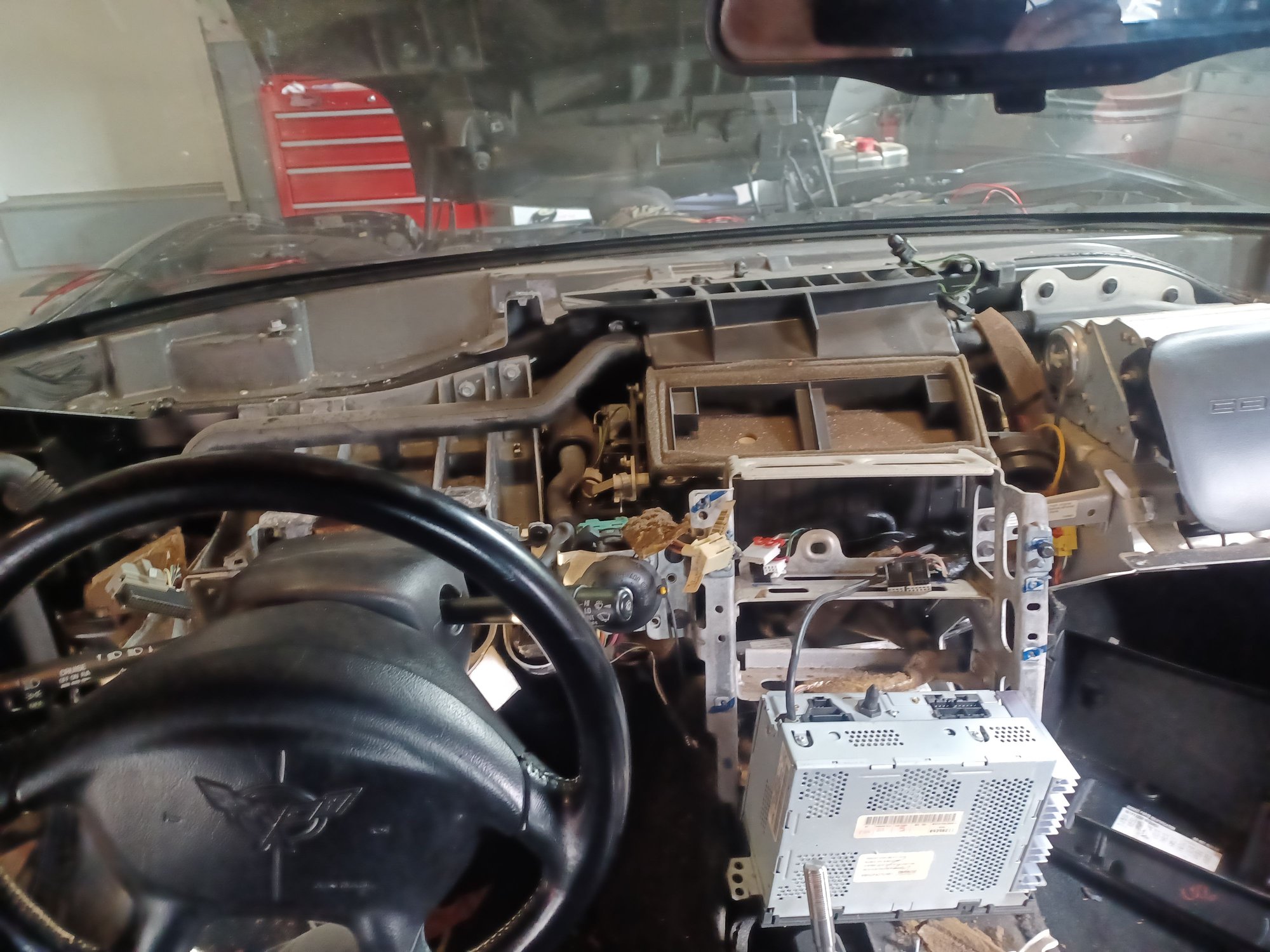

I have a 2000 Corvette that I am working on over the winter, and have a (somewhat extensive) list of repairs that need to be done. Many of these involve pulling apart the interior/dash, and was hoping some more experienced C5 folks could add (or maybe even suggest parts/vendors) to the list so I won't have to do this again for some time. Here's what I have so far:
-Fix (or replace if needed) heads up display
-Wire cigarette lighter to only have power with ignition on (for my Bluetooth transmitter)
-Replace all/most lights in dash with LED, including the climate controls, radio, all buttons around the gauge cluster, and possibly the gauge cluster itself. Anyone have any vendor/type suggestions? I prefer 5000k

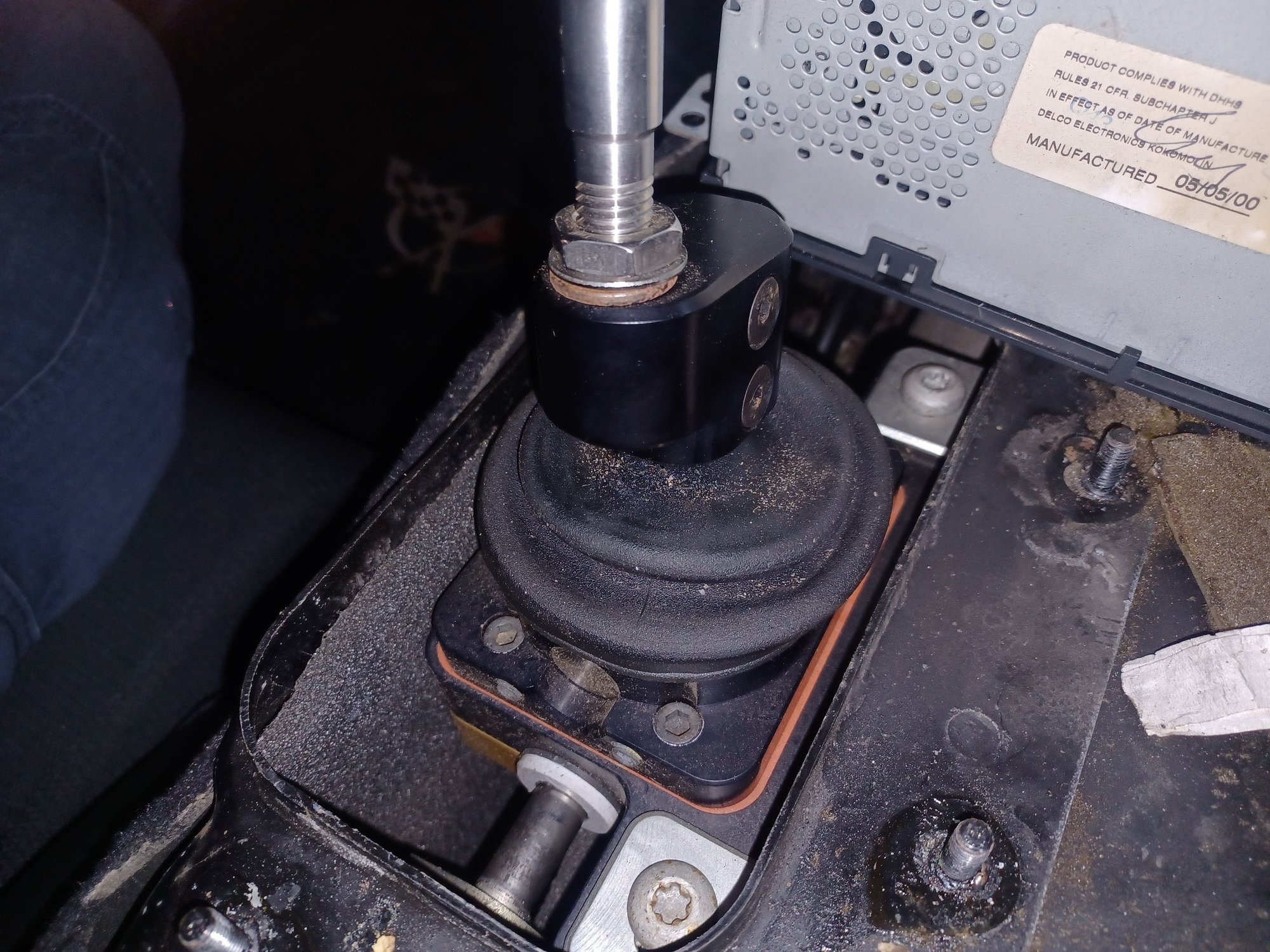

-Regrease linkage (it has a short shifter and has become quite taxing on my elbow on long drives due to do force required to move the shifter)
-Replace missing screws found when removing dash
-Replace/repair broken plastic pieces (there are a lot). This will be difficult, any vendor suggestions are appreciated.
Some 'Maybe' ones as well:
-Replace radio with a double DIN (and bezel to accommodate)
-Replace/repair fabric(?) on dash that is separating around the HUD plastic

Here are some pictures of where I'm at, almost ready to start ordering parts.

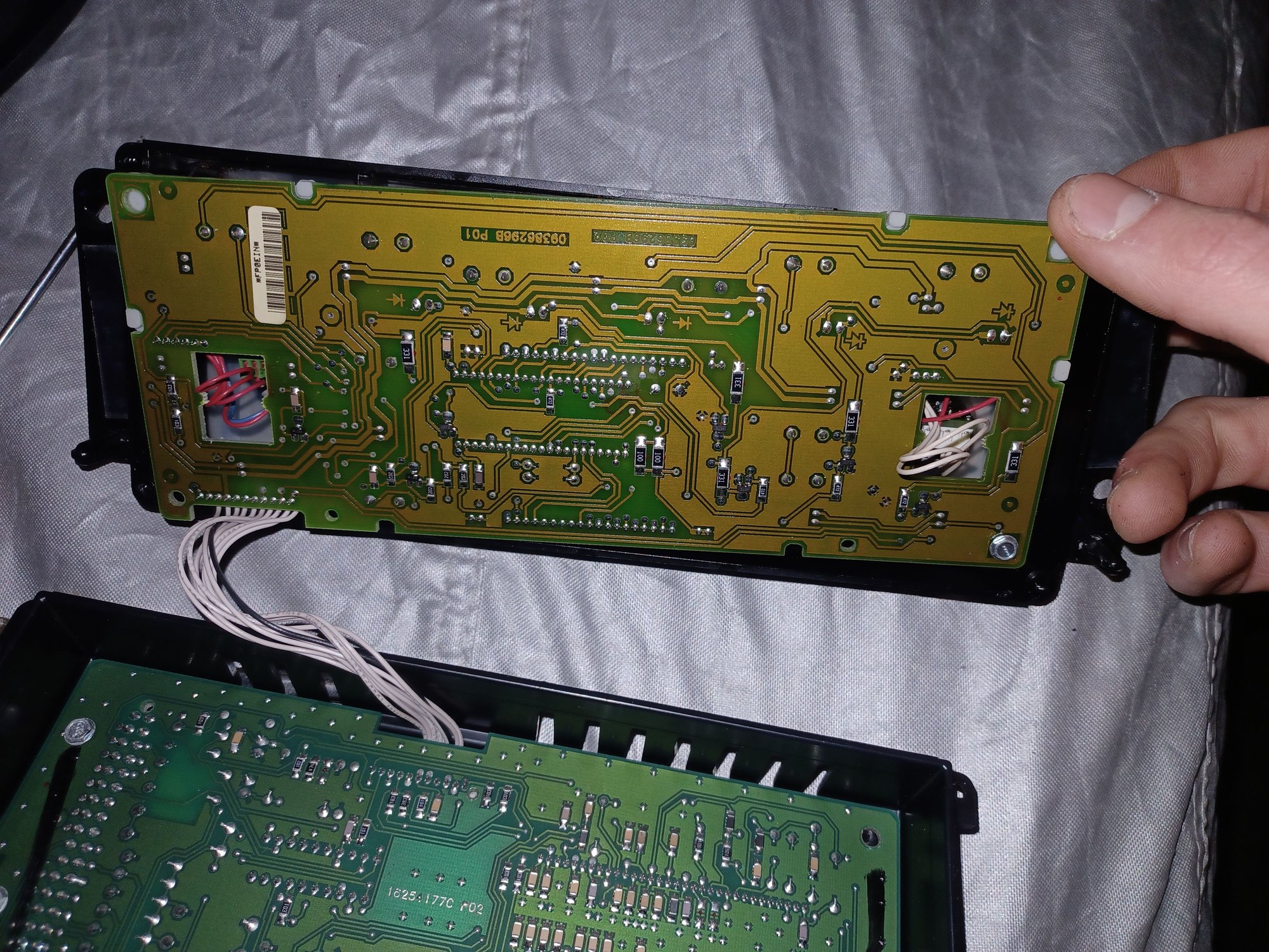

I just finished taking apart the climate controls module, and it looks like the lights are soldered directly onto the circuit board, anyone know of a place to get replacements for these?

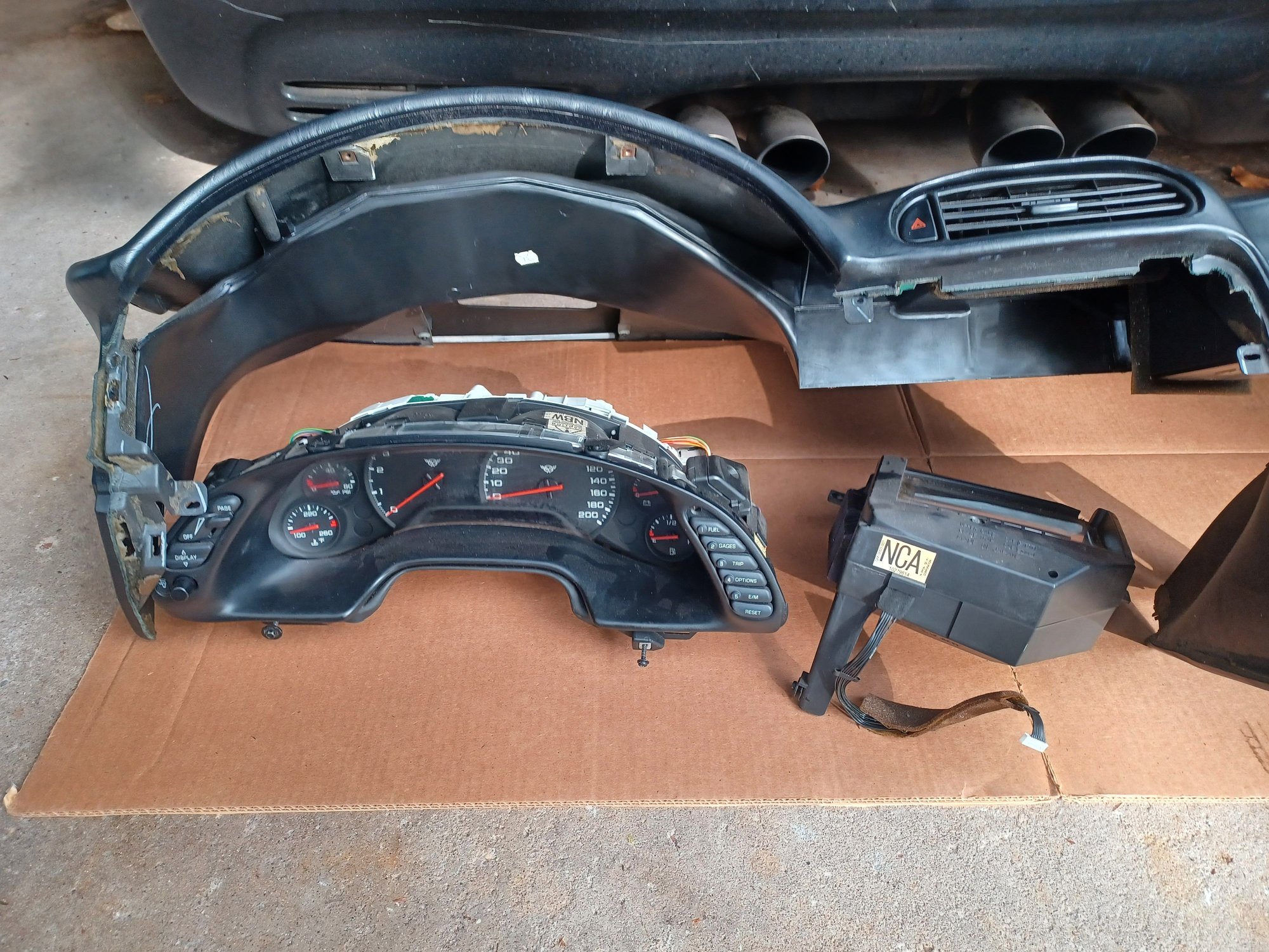

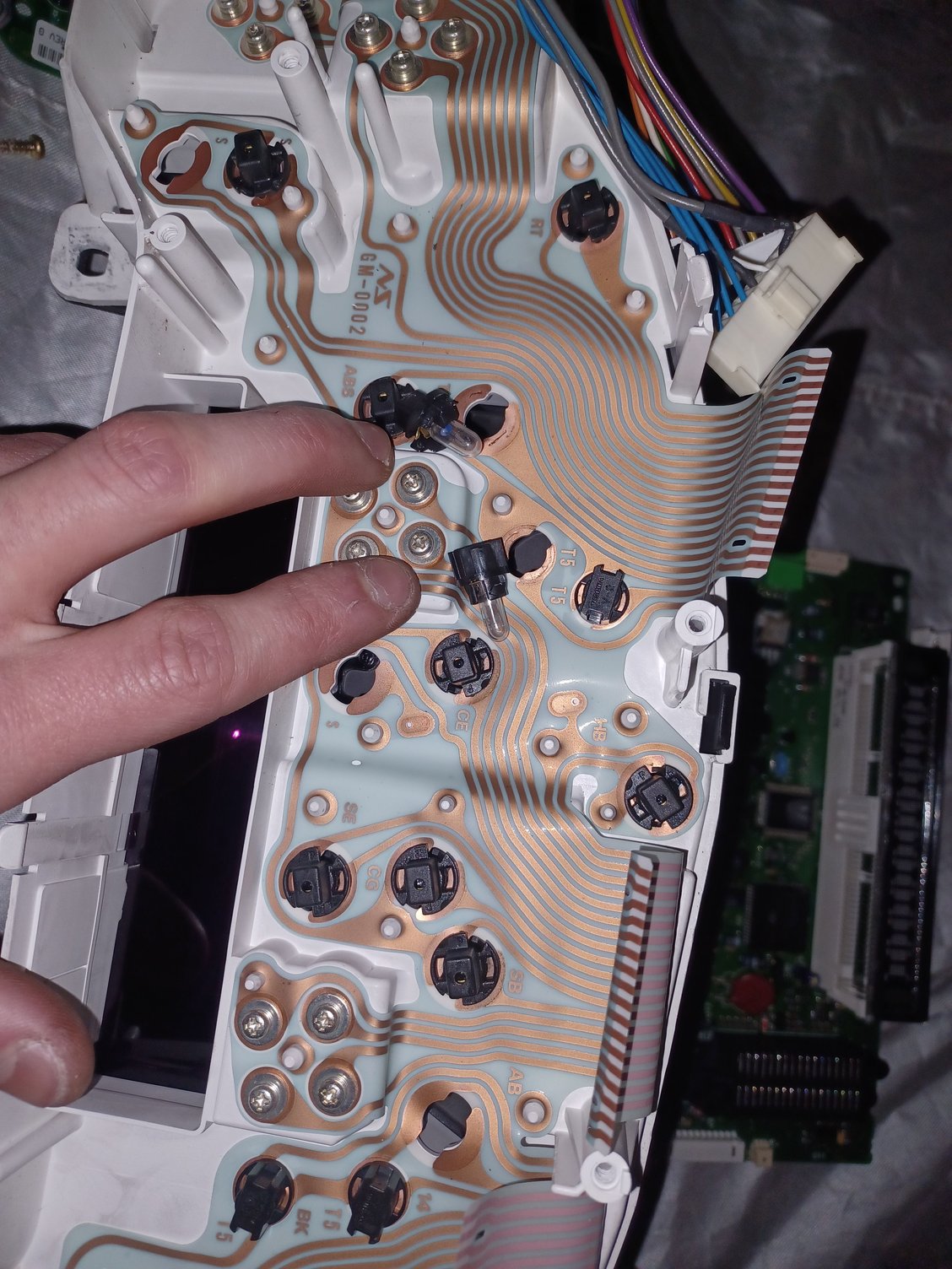

Some other lights I would like to replace are all the ones in the gauge cluster and buttons surronding the gauge clusters. If anyone knows the part number or a good place to get these, please let me know! There are two types on the gauge cluster, and a third on the buttons.
Unfortunately many of the plastic pieces are breaking (or already broken) as I'm taking everything apart. Im going to epoxy what I can, but if anyone knows of a good place to source these, RockAuto has a pretty limited selection.

If you haven't already done so consider changing out the HVAC door actuators for driver and passenger sides.
If you are Houdini you might be able to change the drivers side actuator without taking the dash apart. But the passenger side (which goes out about a week after the driver's side) requires removal of the entire dash so you can remove the passenger side airbag contraption.
The passenger actuator is blocked by the air bag holder.
Also switch out the 4 way flasher since the dashpad is now off. This too is unbelievably difficult to reach with the dash in place. Easy as pie when off.
Don't pinch any wires when replacing the dash or you get to take it completely apart again and tape the wire. (don't ask)
Take both seats out before you start the project. Your back will thank you. It's only a few minutes and they are very light.
Stuff rags in the defroster vent as it is a magnet for your only 8mm socket.

HVAC actuators sound like a good idea. I'm a little nervous about removing the air bag, I'll do some research before doing that.
Hazard/four way switch is on the list, forgot to put that in the original post!
l'm hoping I won't forget to reinstall any of the connectors when putting everything back together, I'll note the wire routing as well so nothing gets pinched.
A little too late to take out the seats, I'm not a big guy so this has worked out okay for me. Mine is also an FRC so pulling out the full dash took a little twisting but was not as bad as I was expecting.
Blocking off vents is definitely a good idea, I have a tendency to drop sockets and bolts into hard to reach places.
Thank you for the insights!

Gauge cluster lights
Radio lights (soldered)
Climate control lights (soldered)

Gauge cluster lens, mine has a crack in it
LED lights for the gauge cluster
LED lights for the radio and climate control module. I have some LEDs on order from DigiKey, but figuring out polarity without power to either is going to be a nightmare.

LED gauge cluster lights. There are some super cheap ones on Amazon but i can't find anything beyond that. Does anyone know what these bulbs are? I've read that they are 194s, T5s, T10s, PD 189, and other numbers, but none seem to match. There looks to be two slightly different sizes in the gauge cluster, and all the others match the smaller size.
I am also looking for a replacement plastic lens for the gauge cluster. The one I have has a small crack in it. This is probably much harder to find than the lights, I'm assuming I might have to go used if I want to replace this?

You mention greasing your shifter linkage... You may also want to recalibrate or realign your shifter housing as time and wear can take a toll. It is easy to do and Froggy has a good YouTube video on this.. pretty simple. While you have the shifter housing out, replace the rubber grommets at the mounting screw locations. This may help your shifting though I didn't notice much change in mine. What did help tremendously with shifting smoothness and effort was vacuum bleeding the clutch master cylinder to get air out of the system. VetteOnVettes has a YouTube vid. This did more than anything to improve shifting and it too is easy to do.

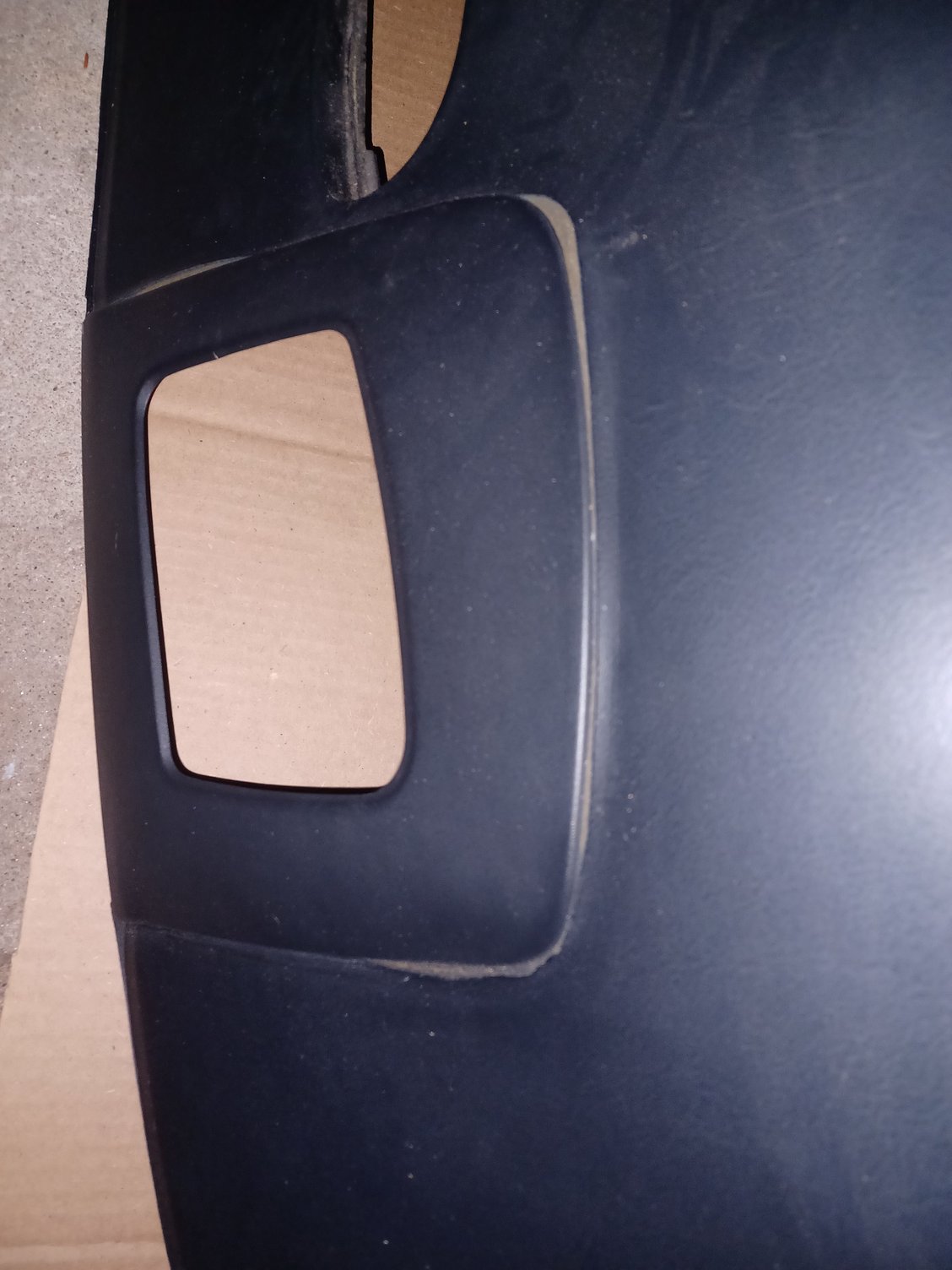

The dash pulling back from the hud bezel... I think someone sells a larger hud bezel which fits over top.

I'm that guy, so I have to say it: TMODcustoms tub for your shifter. You don't realize how dead that box IS right now but will when you put a fresh one in there - guaranteed for life.

I'm going to try filling in the HUD gap with some 'welt padding' before buying the $80 oversize bezel. Another user on the forum did this and it worked well.

The PO put the short shifter in, not sure what brand. He spent a fair bit on money on other items on the car, so I think it is a pretty good quality.

I was hoping to find just the lens for the gauge cluster, but it seems it is not available anywhere, even used. I'll probably just clean this one up and re-use it. A Z06 cluster would be cool, but $250.00 is the cheapest I could find.

I did begin to epoxy many of the broken plastic pieces, most should be repairable. The radio bezel/center console plastic is a little worn on the outside, but I'm saving that for when I switch to a double DIN radio.
I'll see if I can pick up some friction reducing tape along with the 'welt padding'. Might have to use that in my C4 too, that things creaks and squeaks like crazy.
Visors are a good idea, I need some for the C4 too. I'll probably wait until next winter for this. Too many projects already!
I'll bring the existing shifter bolts to the hardware store to get replacements that take a hex key.

After slow but steady progress, I have replaced all bulbs with LEDs, and want to make sure the gauge cluster lights are all there. Anyone have a picture of what their gauge cluster looks like with the ingition on and car off? This is what mine looks like, trying to see if any are missing. I used some pictures others posted to get the polarity (hopefully) correct.
One odd thing is that my passenger window switch is not illuminating. It finctions to move the window and lock/unlock doors but no lights. I tried switching the polarity as well, with no luck. Drivers side has new lights and works well. Anyone know why this might be?
My HUD is also still not working. I fixed the pin in the mirror, and I can see the mirror moving up and down, but nothin is on the windshield. I tried adjusting the brightness, and still nothing. Anyone know what I should try next and where replacement parts could come from?
I also tried to push the dash leather back under the HUD bezel with plans to epoxy it to stay under, but I could not get the leather to move/stretch. Any suggestions to help get the leather to stretch back under the bezel?

I am also going to begin soldering new LED bulbs into my HVAC control module and factory radio. I was hoping to find something that shows the polarity in both. Even just the radio would be very helpful, as the HVAC controller I can hook up to a voltage supply, but the radio board I cannot. Unfortunately there has been no luck with online searches. If there's nothing out there, I'll take some pictures when I have the polarities sorted.
That''s a good point on LEDs as I swapped out some easy ones on my door panel controls and didn't like the brighter light as the receivers weren't designed for them and the brighter light was distracting while driving at night. Perhaps a lower intensity LED would have worked better but I simply swapped my old bulbs back in.
Also, I suggest swapping out your hazard switch if it hasn't already been replaced. Although seldom used, they can fail and cause other llghting issues. I had to use mine last year for the first time in years for an actual road side emergency and the stupid think got stuck in the on position.
