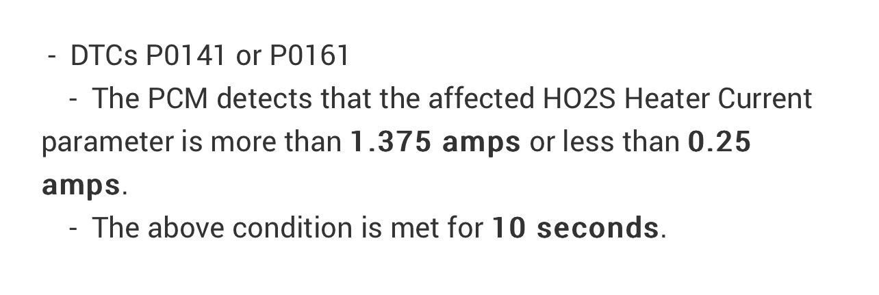

If the car runs rough at idle but OK under load it may be a vacuum leak…the P0161 is B2S2 O2 sensor HEATER code…may be bad sensor or wiring…if you have a scan tool you can verify that it is a vacuum leak.
