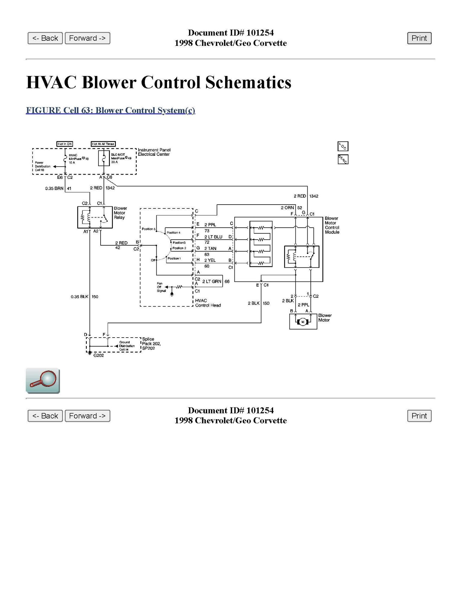

Ok, so no troubleshooting then. Just because the part fit, does not mean it's good. If you do not have a test light or DMM, then there is little that can be done to isolate the issue. At a minimum, you need to know that 12 volts from the control head is going to the respective contacts on the blower motor resistor module. You could also evaluate the resistance through the resistor module, but you would need a meter to do that .
What you know is good:
1) Blower motor relay
2) G202
3) Blower motor
4) Fuse 18 and Fuse 49
What is in question:
1) Control panel output
2) Resistor module
3) Associated wiring (least likely)
So again, if you are unable to troubleshoot, I would get a Genuine GM part. Here is one example:

The high speed (5 on the control head) does not go through the resistors. The OP installed a sealed module that has different resistance paths to the blower motor.......not individual resistors.
