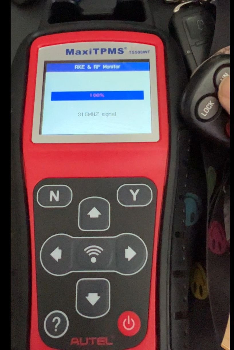

The Fob's and the TMPS sensors communicate with this RFA receiver.The receiver is connect to the serial bus an the BCM.
I have a Autel TMPS device. I can activate fob buttons and the Autel receive/register the signal from the fob
Buttons just like my Maxi TMPS shows below.
Maybe you can check this at a wheel shop like I do?
Also check the soldering on your fob prior to this check
