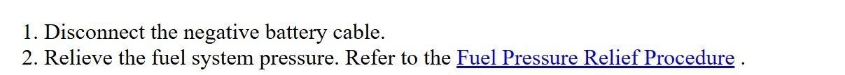

Step #2 in your service manual for replacing the in-line fuel filter.

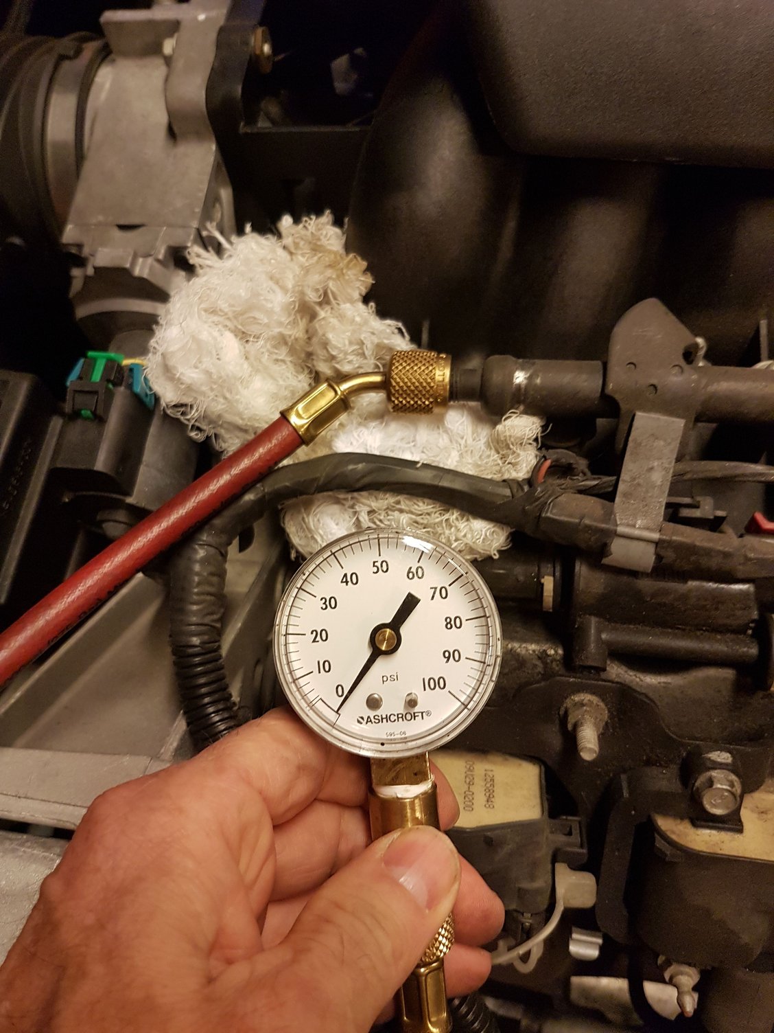

I drain my fuelpressure like this using a pressure gauge connected to the shraedervalve on top of intake , driver side

Small victories! At least for a 72 year old guy crawling around under his Vette. I found no fuel pressure in the system which surprised me somewhat. Removing the filter presented a couple of challenges just in finding the right tool. The outlet and return lines only required some long nose pliers to squeeze some plastic clips and the lines pulled right off. The inlet side required a fuel line release tool, which I had but could not for what ever reason get my metal tool to fit between the fuel line and the filter opening. Had to go to an auto parts store and found a set of plastic tools where it appeared the fingers were thinner, which apparently they were, and slid right in. Still no pressure in there but a good bit of fuel was in the body of the filter, most of which my shirt sleeve soaked right up! Of course install was a snap. Mission accomplished!
