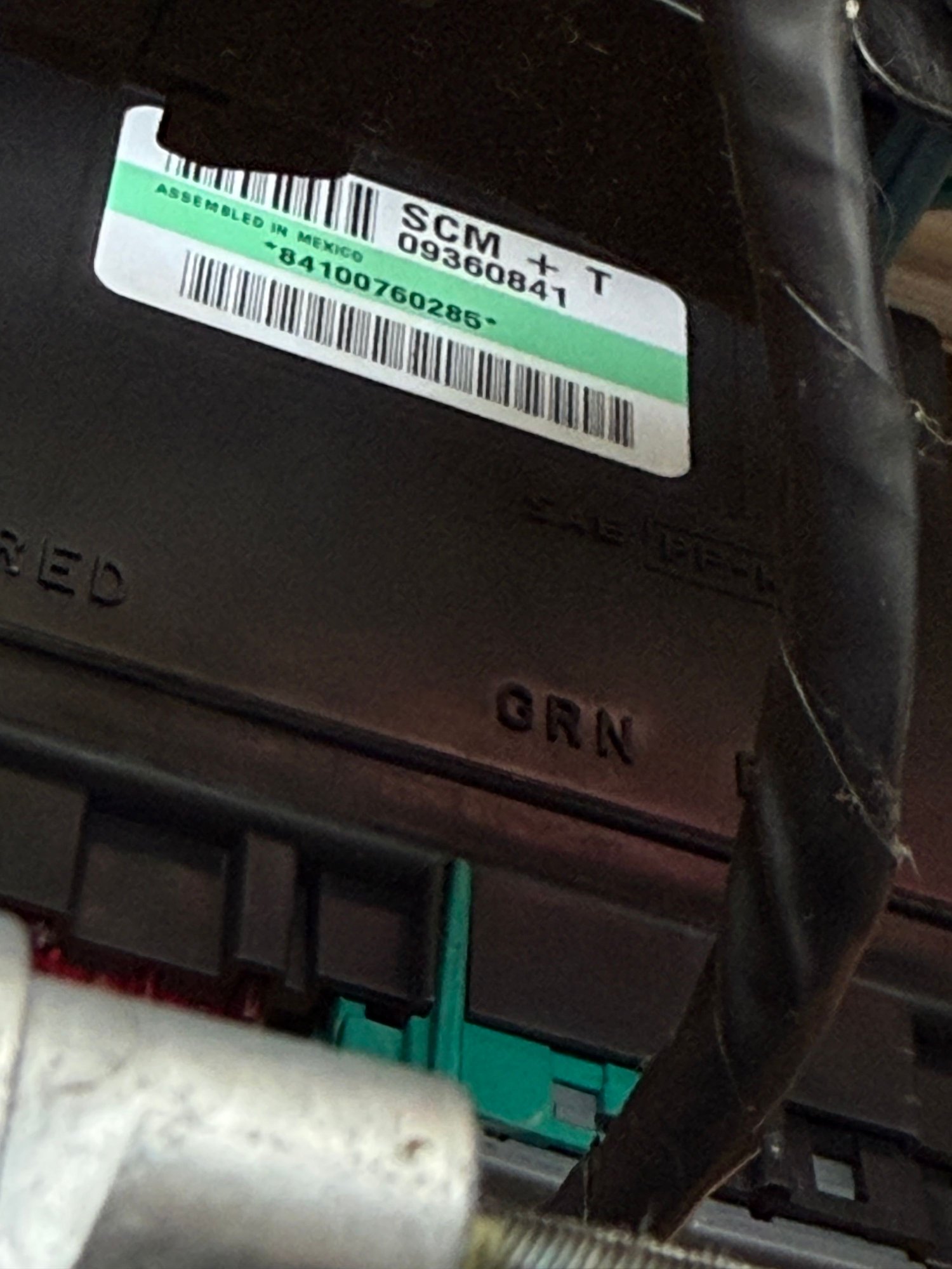

Finally got around to pulling the seat, since I am the only driver once I set the seat didn't care if the fuse was out and the seat didn't move! Recovering the top half of the seat and all new foam; the bolster had a hole picked up a very clean used replacement.
Seat module part below and I cannot find this one anywhere. Anyone have thoughts on where to look? Greatly appreciate all the help I have received so far spot on from this group.
