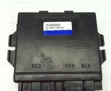

Want to make sure I am ordering the right part, looking at images from the bottom of the seat looks like just one rectangular for the module vs the seat controls. Much appreciate the guidance.

So if you do not have memory, then you do not have an SCM , rather it should have a " Seat Relay". They look similar, but the label on the unit either says "SCM" or " Seat Relay" .
How did you determine what was causing the current draw? It could be a stuck switch, relay, or motor issue? How did you isolate?
Do yourself a favor, and at least confirm the part number on the unit under your seat.

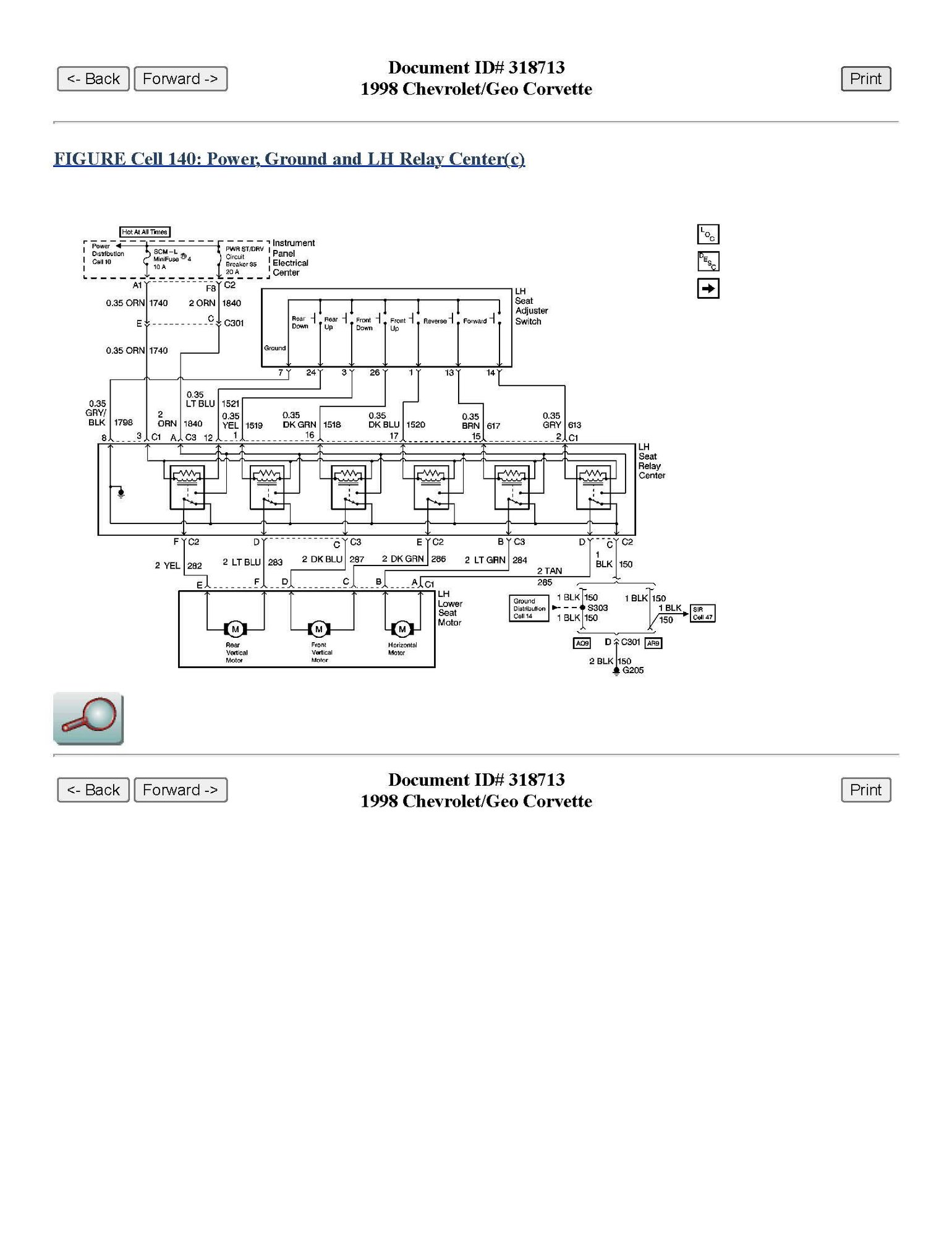

Greatly appreciate the guidance, advice and schematic above! Soon will be testing why the drivers side door lock will not lock with the switch nor with the key fob. Passenger side works fine. Door control module, connections behind the door skin or in the door or elsewhere.

Your issue is probably not the Seat Relay Module. It is probably the seat controls on the side. Over the years, there are many instances where water or other liquids can have gotten into the switches and have caused a short for one of the adjusters causing the current draw. Seen it many times. A check for this would be trying to move the seat in each direction noting which position does not seem to work or if the seat moves back after putting it into another position.
