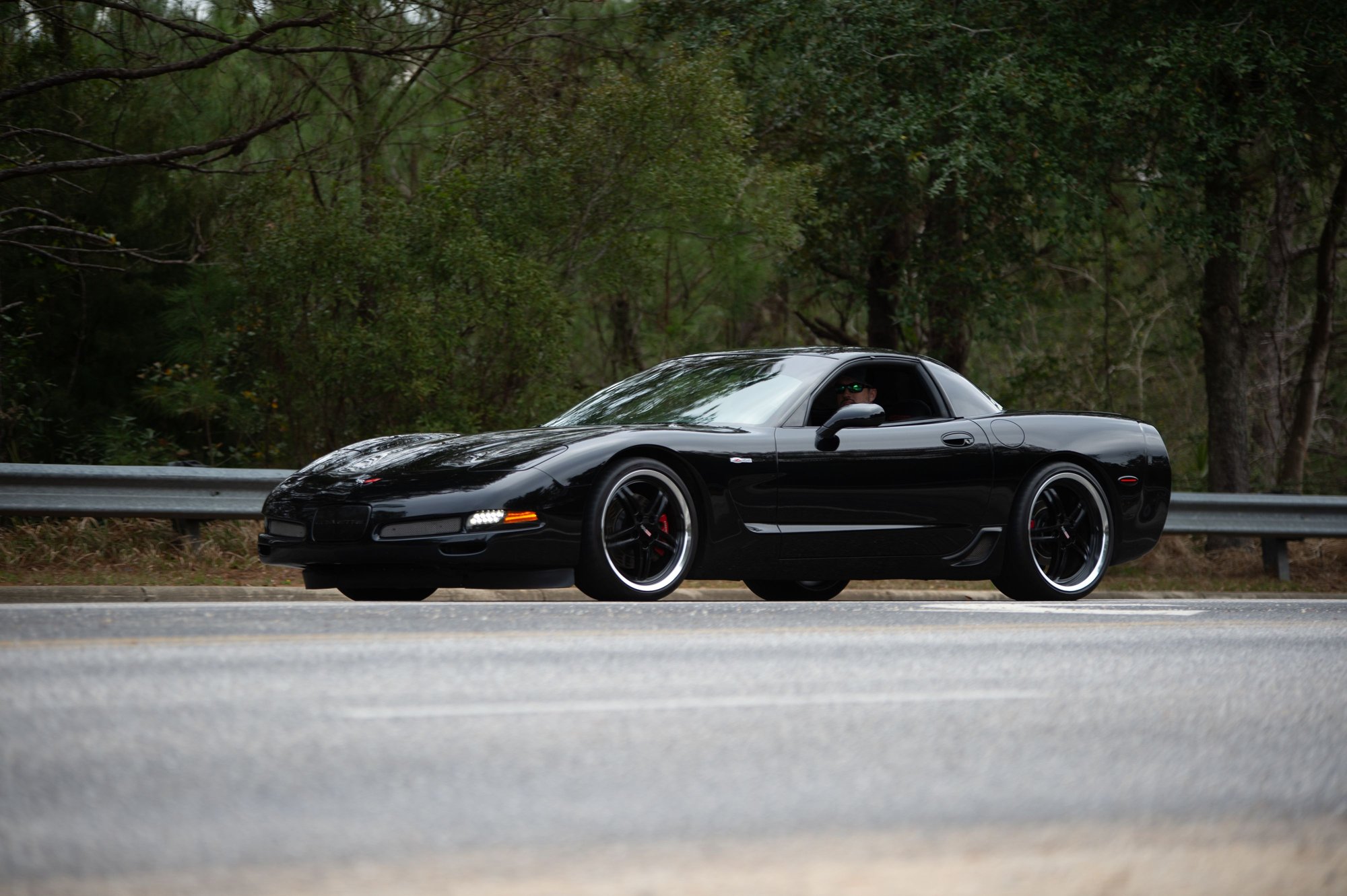

19\20 setup, lowered slightly on stock bolts
