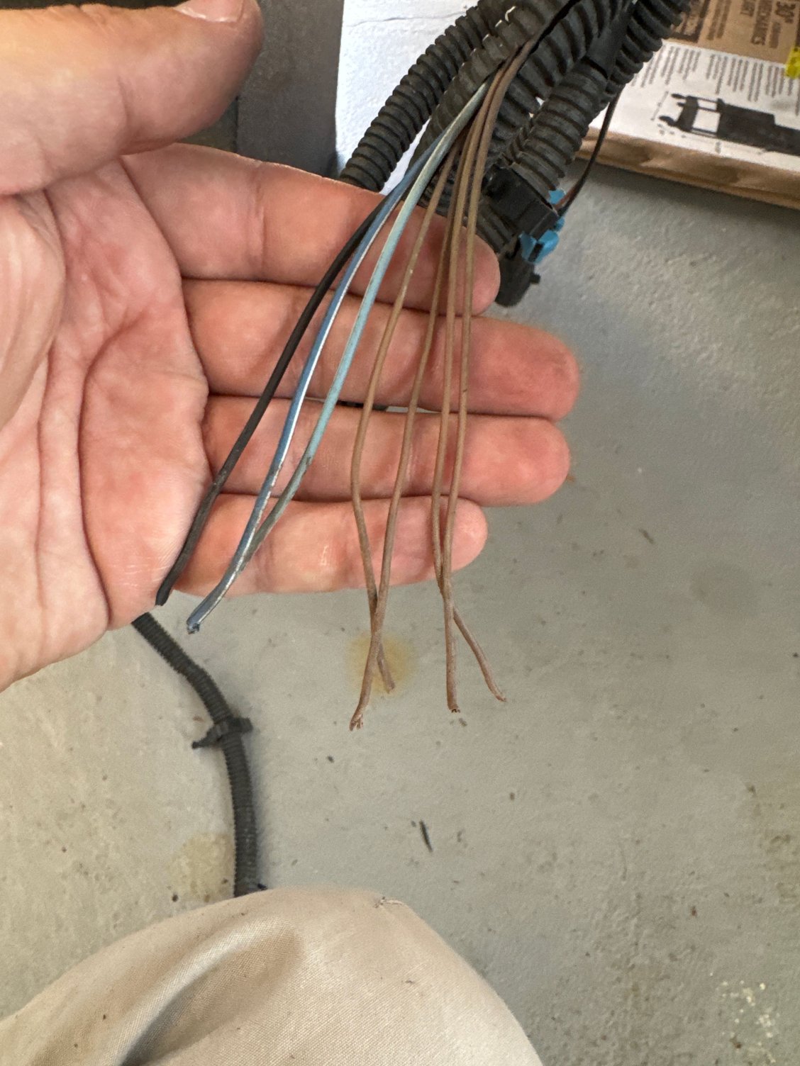

Hi everyone!
Disclaimer: this car was in a front end collision with the previous owner. I’m putting everything back together. See below for the connectors/harness. It’s all on the passenger side. I have nothing on the driver side.
2004 Z06
Pic 1:

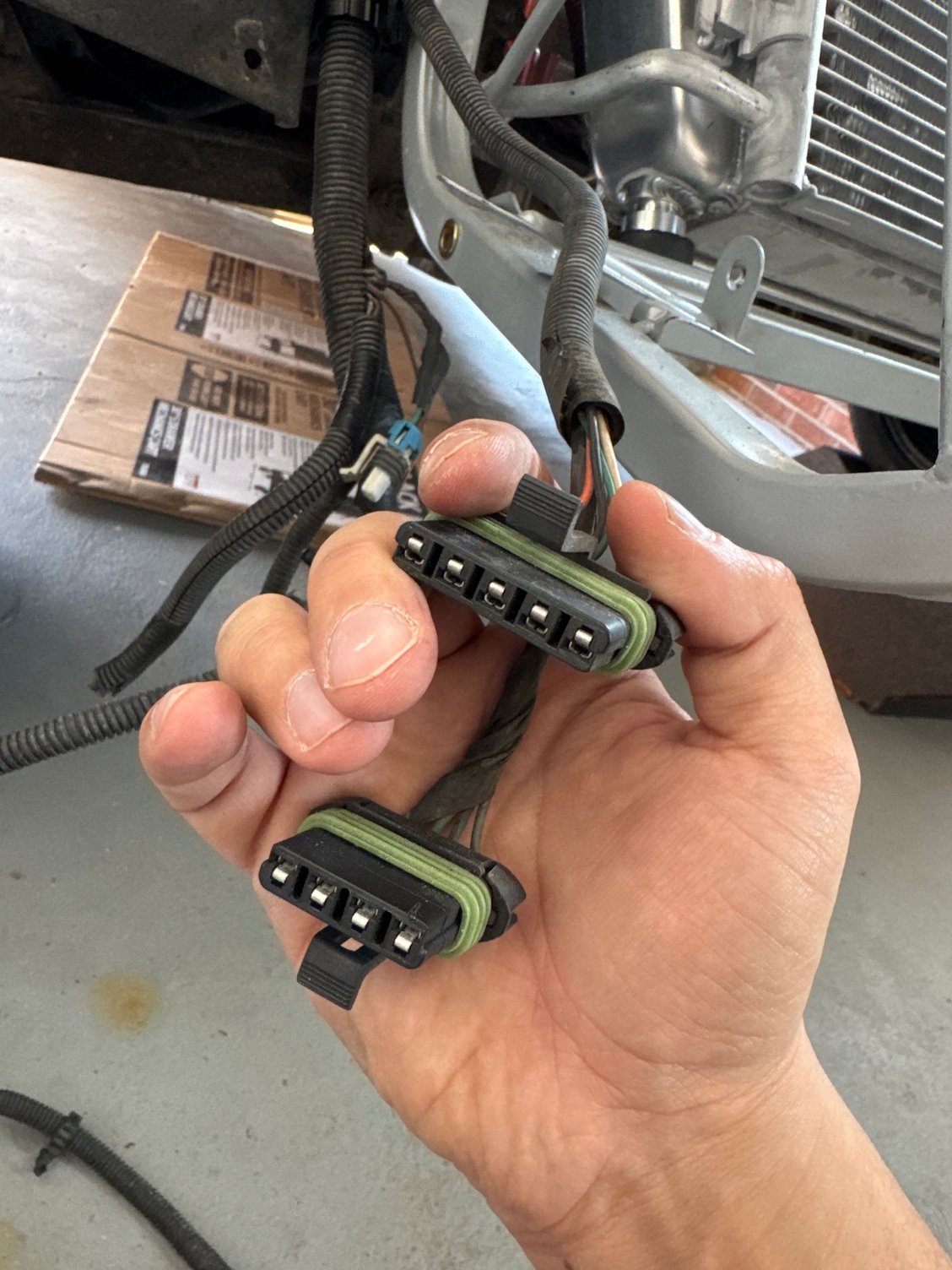

Pic 2: Figured this one out when I put the headlights back in.

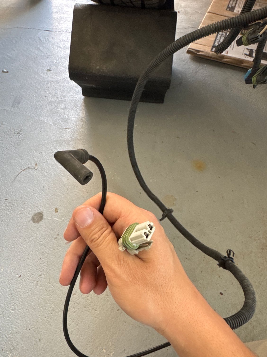

Pic 3:

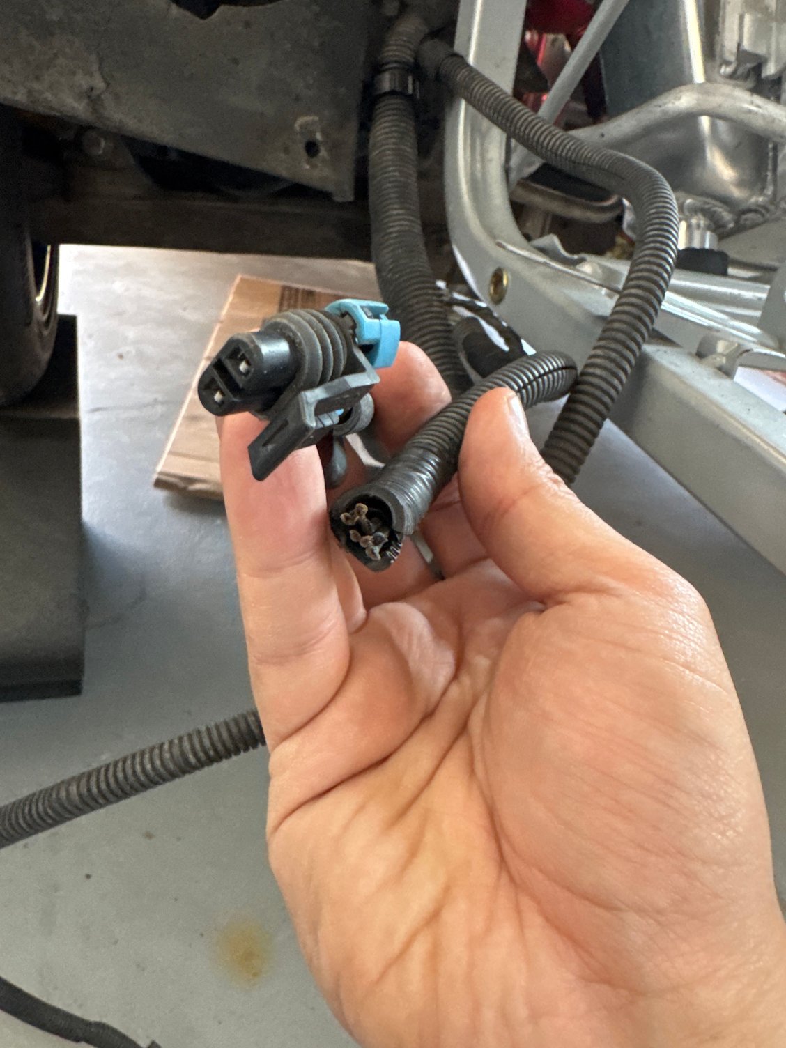

Pic 4
Better view of the one without a connector in pic 4: This is for the connector for the turn signals and parking lights harness. I have a connector now. Are the brown wires interchangeable?

Which one do you need info on currently?
1 - could actually be one of several possible vacuum lines which terminated near the ecu. AIR system has one. HVAC controls. Or the main vac source line itself from the rear of the intake manifold.
2 - you have the lights figured out
3 - radiator fan power?
4 - not really sure.... there is a line which goes UP to the hood for the hood light, and there are the horn controls down there on the driver side, as well as running lights and turn signals, but the plug could be for the outside air temp sensor too. Uncertain about brown wires or their use.

1 - AIR system has been removed, so that makes sense. I’ll look around to make sure it isn’t missing from anywhere else.
2 - good to go.
3 - it’s not the fans. I’ve got those connected and functioning. I noticed that the radiator shroud has a small connector. Maybe the male connector in the pic goes to that?
4 - hood light makes sense. Mine isn’t connected.
90% solved. I just need to figure out what the male connector in pic 1 is (unless it’s also AIR-related) and what the female connector in pic 3 is.

The connector in Pic 1 is also for the AIR system

Thanks! I think that solves all of them!
