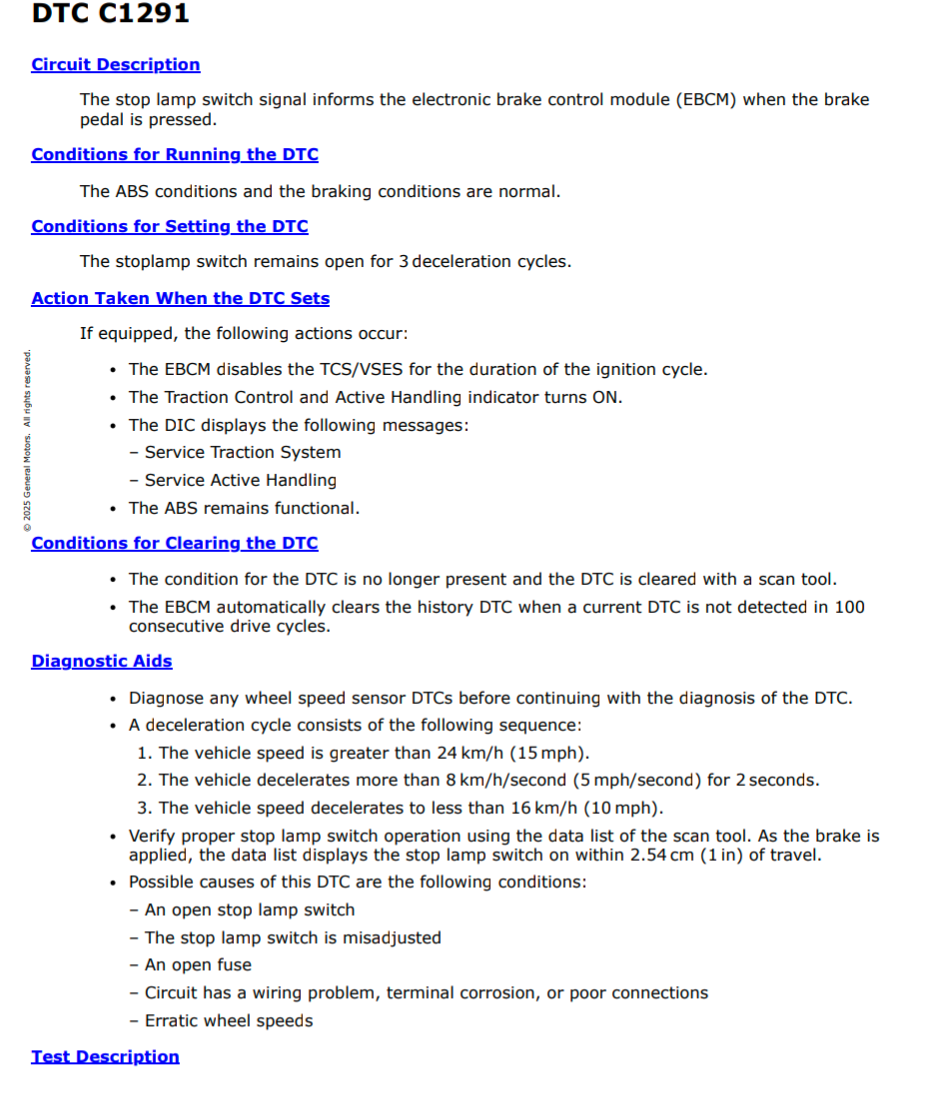

LED tail lights, by any chance? Been there, done that.
My guess is you have DTC C1291 or similiar stored in your EBCM. If so, read on.
The ABS system monitors the brakes by sending a 5V reference voltage through the brake bulbs. If the circuit is open (ex: burnt bulbs), it sets a code. LED lights have way higher resistance than the incandescent bulbs, so the module "sees" it as an open brake circuit.
You can either put back the OEM taillights, or you can install resistors in parallel to the taillights to simulate the bulbs being there.

The main issue here is you lose your traction control and/or active handling systems suddenly, at potentially the worst time; when you are driving aggressively. If you don't like the driving assist (and some people don't), then I guess its fine, however I would manually disable it pre-emptively so it doesn't drop out without warning.
If you feel you need it, I would either go back to stock taillights or install the resistors. The modification isn't all that hard to do, and the parts aren't expensive. I went with the resistors.
