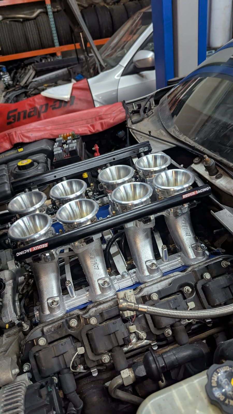

The only additional item needed is to convert the fly-by-wire throttle system as we don't don't have cables or rods like the earlier cars. Other than that getting the correct injectors is a requirement and so is the fuel pressure. I will also be having a clear plexiglass bubble made with a large whole in the back (high pressure) as the when driving piece. I also added small filters like micro-K&M which fit down into each trumpet.

Here is an update showing the fuel rail being installed. They had to cut a small portion of the plastic molding by the wiper.

I have a friend who is interested in going ITB with his LS build. Can you ask / share any problems or particulars the shop has with the install and tune?

The shop doing the work is up in Colorado Springs about 50 miles from me, but I plan on going up there this week,just added these photos and if the wx holds will bring her home

Just got her home, and had 8" of snow and then the following week 28 hours of rain...Don't ya just love life in the Rockies??!!Well we love it so much we will be relocating to Sun Citry AZ next month. Back to the Car. It runs really well with a great throttle response that is much faster then stock ,smooth acceleration with no tipping or off/on weirdness thanks to HALTECH and the masterful work done by TGA Performance in Colorado Springs> They really took on a project that they had never done before, and succeeded very very well. There is only one warning light, the traction control is staying lit and a reduced engine power alarm stays quiet with the reset button. Those I can live with until I find a competent shop if Phoenix. More photos coming in between packing up boxes. Anyone need a free C4 307 diff complete with the batwings.?
