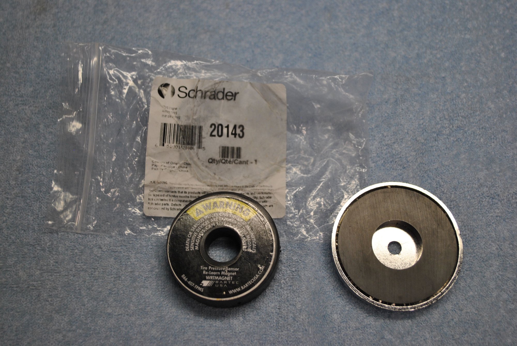

My suggestion would be to go to the Schrader web page, look up your car, and purchase what they suggest. Schrader is the OE supplier, so whatever they recommend, will function properly. The main reason I suggest their applications page, is because over the years, their part numbers have been superseded by new numbers, and you want to obtain the newest (and freshest) parts. They also sell (at least they used to sell) the proper magnet that triggers the sensors.
The smaller magnet, next to the Schrader magnet, is a Stanley Tools magnet, that I bought at a hardware store. I was the first magnet I used to program my sensors. It worked sort of OK..........
